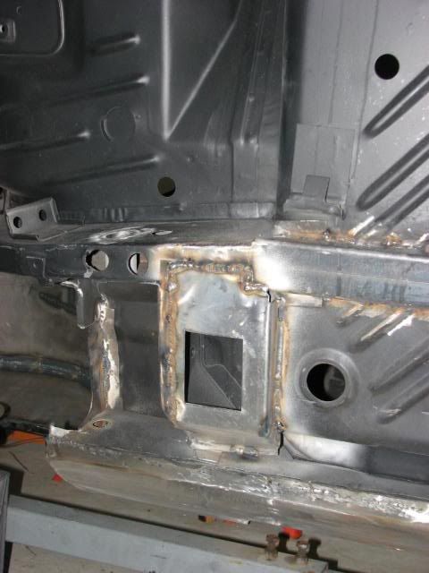

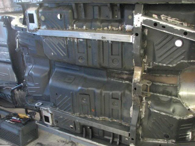

Then it was on to the front and rear torque boxes....same thing....needed alot of tweaking to get them to fit nice and tight before welding. These are made by Auto Rust Tech and are not "factory correct" in style but are much thicker than original
http://i229.photobucket.com/albums/e...I/IMG_2288.jpg
http://i229.photobucket.com/albums/e...I/IMG_2362.jpg
http://i229.photobucket.com/albums/e...I/IMG_2476.jpg

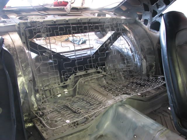

Then I narrowed the rear seat alittle to clear the minitubs.... everything is just tacked together for now, until I'm sure how it will all fit...
http://i229.photobucket.com/albums/e...I/IMG_2550.jpg

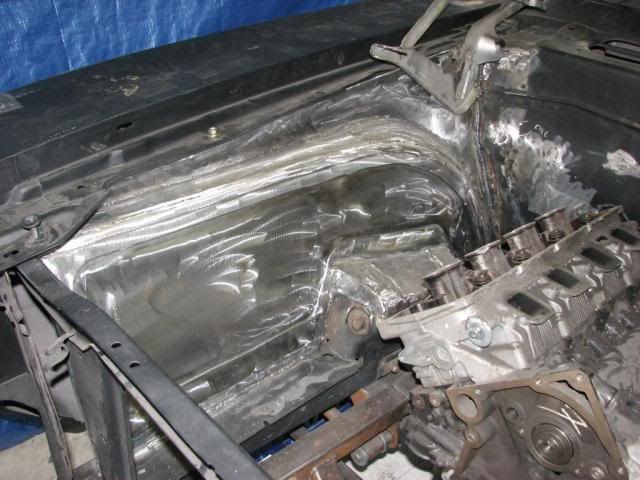

Inner fenderwells......the design I wanted but really bad execution...warped all to hell...
http://i229.photobucket.com/albums/e...I/IMG_2301.jpg

here are the front torque boxes and rad cross brace..
http://i229.photobucket.com/albums/e...I/IMG_2360.jpg
