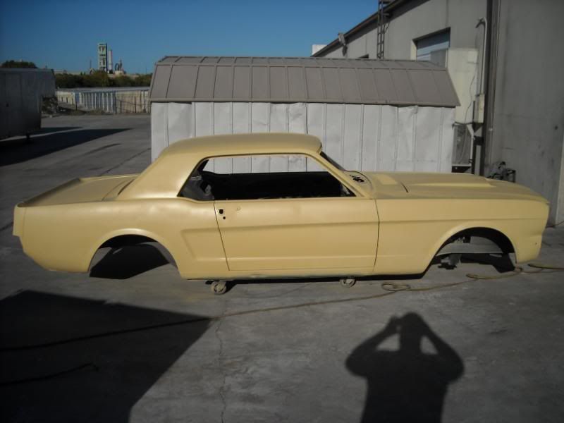

the body is done and straight as a arrow
here it is in polyester waiting for block sanding
did this step twice two coatds of polyester then blocked with 180 followed by 320
http://i76.photobucket.com/albums/j1...g/DSCN0195.jpg

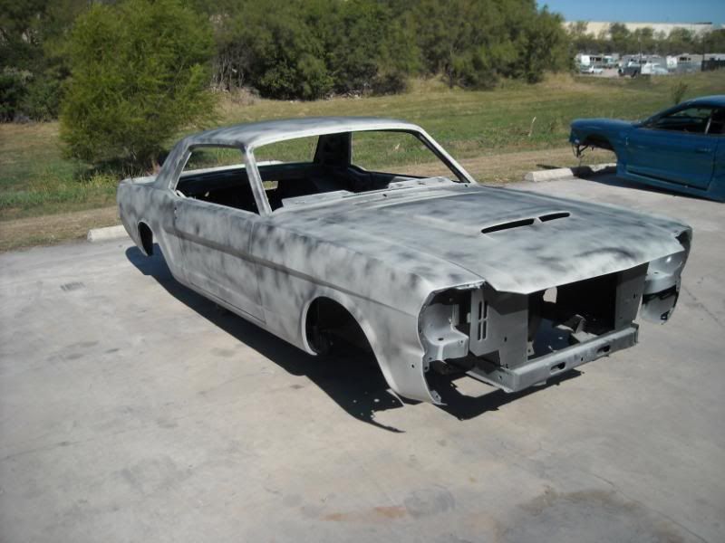

once that was doneand the waves were gone we put it in 2k primer and blocked twice using 180 then 320
http://i76.photobucket.com/albums/j1...g/DSCN0201.jpg

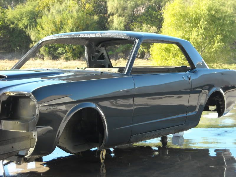

then we painted it with epoxy sealer to seal the paint and wet sanded that with 320 then 500 grit and its done waiting for paint
heres a idea of how straight it is this is just the already sanded epoxy sealer wet no clear etc
love that body style without the drip rails
http://i76.photobucket.com/albums/j1...g/DSCN0208.jpg

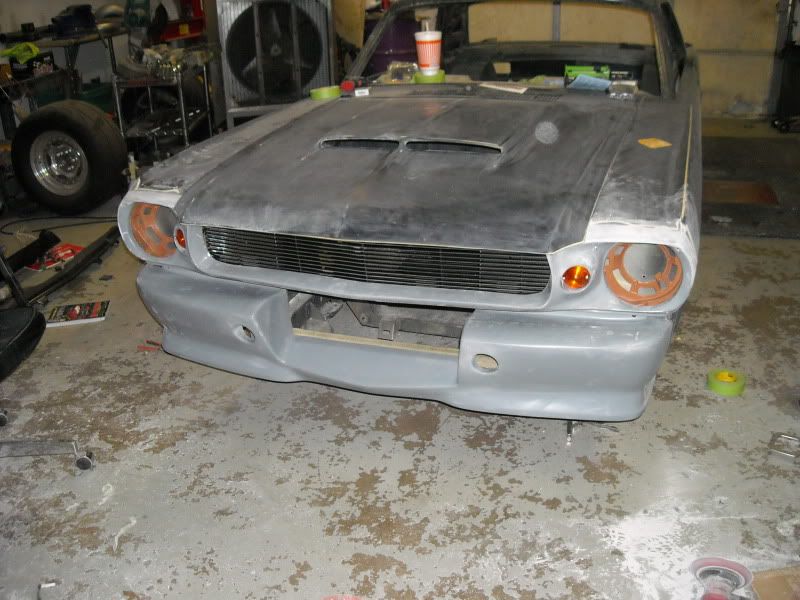

the nose has been fited and will be primed sealed and wet sanded
http://i76.photobucket.com/albums/j1...g/DSCN0210.jpg
