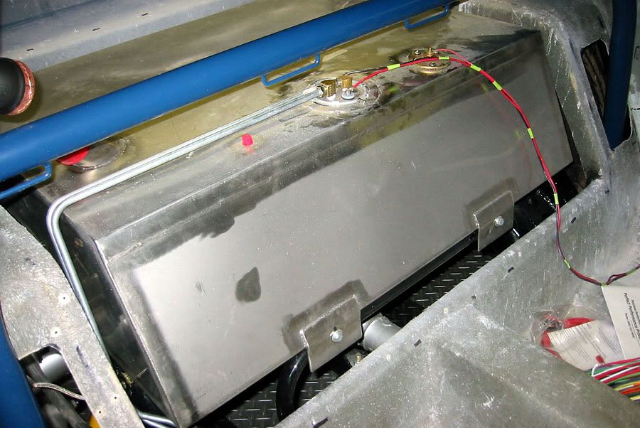

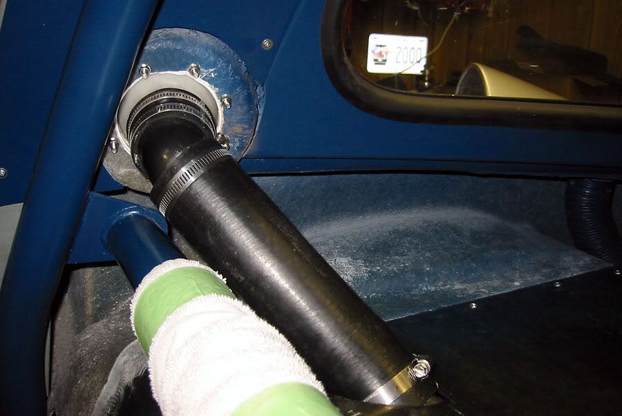

It's behind the seats, under a panel which is under the carpet... I put a 3/16" metal vent line from where the red plug is to an 8" vertical loop under the filler neck, which then goes straight down into the rear wheelwell. Unfotunately I didn't take any pics after I put it in.
http://img.photobucket.com/albums/v4...ibute/a054.jpg
http://img.photobucket.com/albums/v4...ibute/a052.jpg
parsonsj 09-09-2005 11:51 AM
Is the 8" loop above the tank? If so, replace the loop with the separator, and run the output of the separator into the wheelwell. If a smell persists put a charcoal filter on the output line. Does that work?

Well, maybe 6" and that's the problem.. gaining access to this area again. The interior guy glued all the loop carpet down and it gets destroyed when you pull it up. I really can't access this area again. The smell isn't as much a bother as the fuel escaping on turns.
