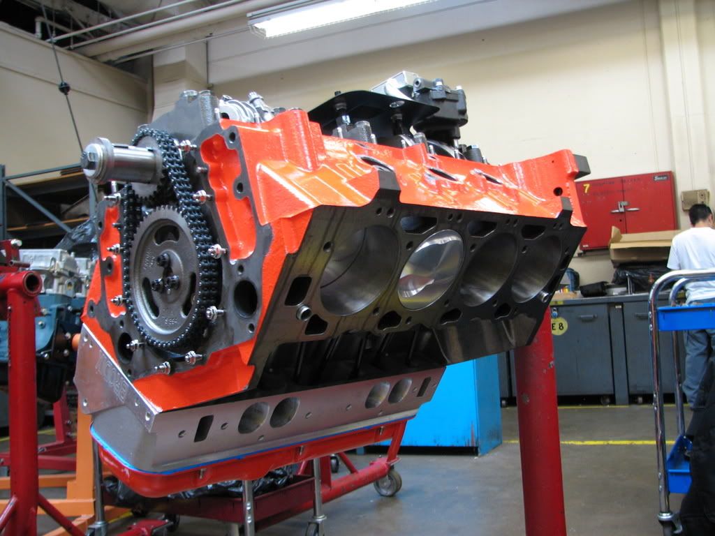

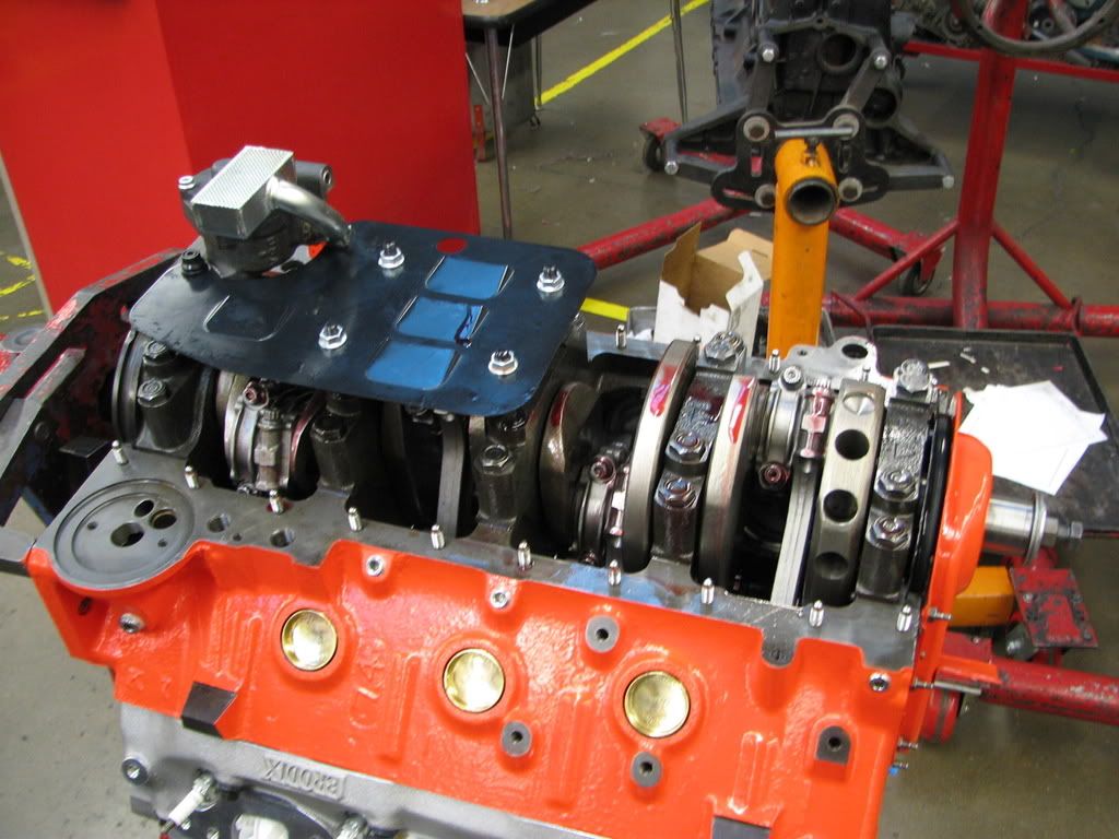

The best way, is probably a good soak in a hot tank. Then your typical aircraft paint stripper for anything that is left, then degrease etc.

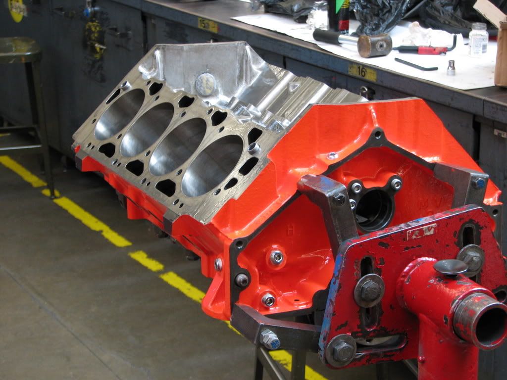

I had pretty good luck with Por-15s engine paint:
http://i328.photobucket.com/albums/l...Engine001z.jpg http://i328.photobucket.com/albums/l..._Engine029.jpg http://i328.photobucket.com/albums/l..._Engine021.jpg
As far as matching to body color, well I'll leave that so someone else to answer.

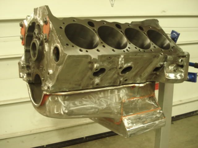

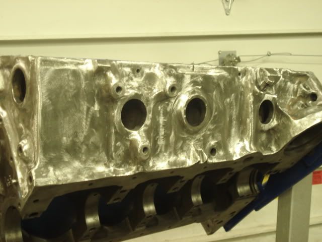

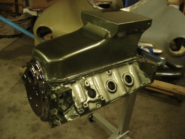

Interesting thread i just finished my motor in body color check out smoothing engine block in this thread lol
Heres my engine before and afer paint
https://lateral-g.net/forums/showthread.php4?t=17773

I love how you smoothed out your block. Need more pictures :thumbsup:
did you just spray the motor (after cleaning of course) with por-15 and a regular paint gun? I'm going to order some por15 for my ls1 and paint it to match.

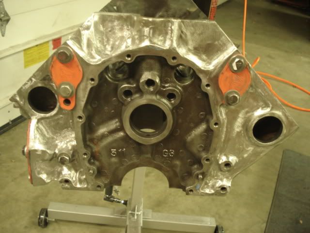

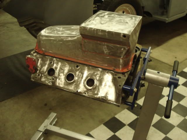

Here ya go ! Any other ?'s just hollar!
http://i229.photobucket.com/albums/e.../Block1066.jpg
http://i229.photobucket.com/albums/e.../Block1004.jpg
http://i229.photobucket.com/albums/e.../Block1010.jpg
http://i229.photobucket.com/albums/e.../Block1029.jpg

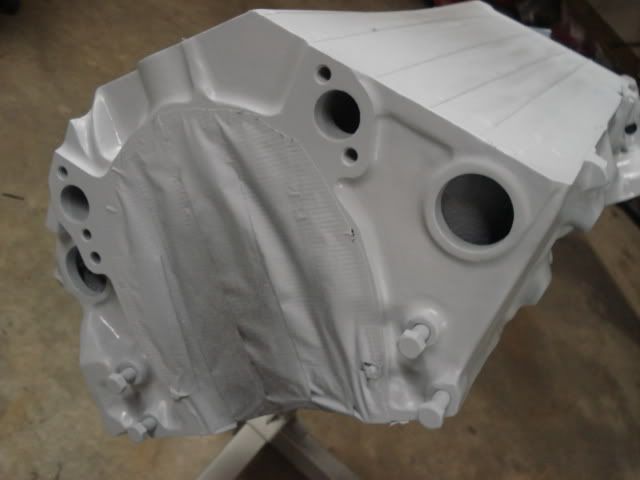

G-Body 12-11-2008 06:02 AM
And a few in paint!
http://i229.photobucket.com/albums/e...imetime029.jpg
http://i229.photobucket.com/albums/e...imetime026.jpg
http://i229.photobucket.com/albums/e...imetime028.jpg
http://i229.photobucket.com/albums/e...nTeaMet036.jpg
http://i229.photobucket.com/albums/e...TeaMet2025.jpg
