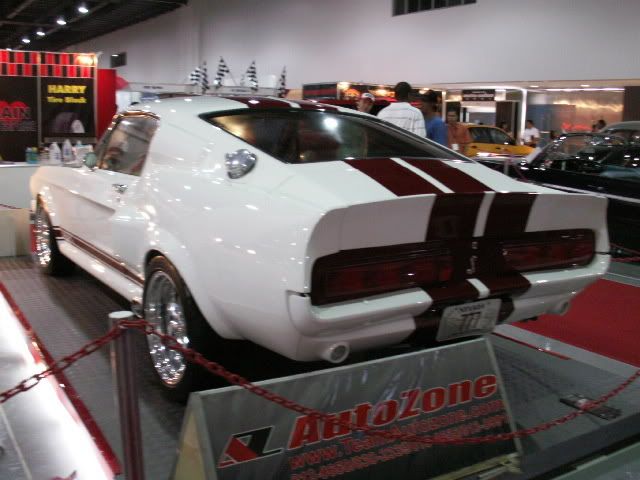

It was then the height of the Eleanor craze so I tried to do one. I found a good body that cost me about $1000. Since buying the Eleanor kit and shipping it to the Philippines will be very expensive so I did everything in steel. http://farm1.static.flickr.com/158/3...4135cf4d5a.jpg |

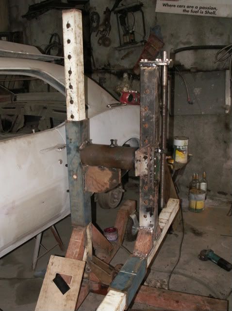

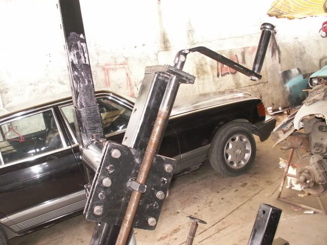

Here are the steel conversion photos.
http://farm3.static.flickr.com/2096/...aa2416fc20.jpg http://farm3.static.flickr.com/2178/...2577b543ec.jpg http://farm3.static.flickr.com/2238/...e62a3cde_o.jpg |
looks good, but why are there pics of 2 different cars?

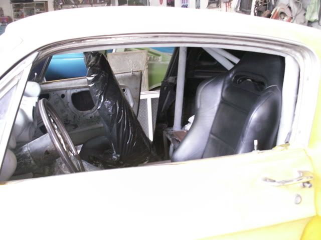

Since everything south of the engine will be moved 10 inches also, I did a six point roll bar and made a custom dash.
http://farm4.static.flickr.com/3153/...93fffa1925.jpg http://farm3.static.flickr.com/2343/...170801fcde.jpg http://farm4.static.flickr.com/3229/...e6ae7c945c.jpg http://farm3.static.flickr.com/2419/...072375e977.jpg Dash being painted. http://farm3.static.flickr.com/2303/...6d698bc1af.jpg |

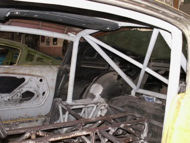

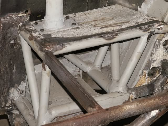

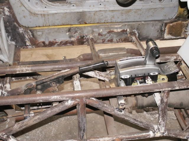

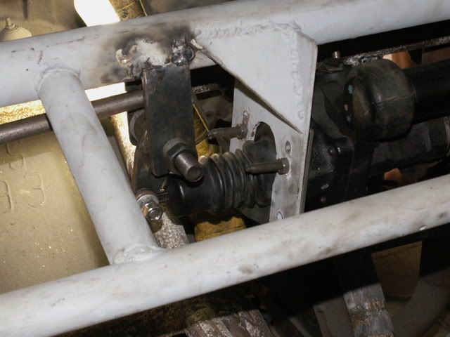

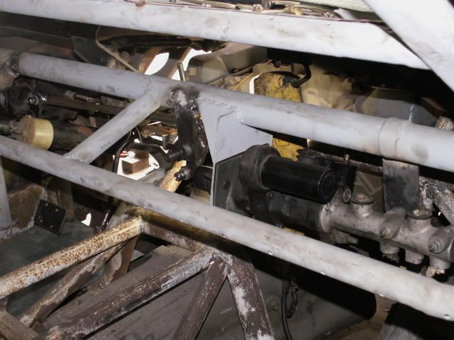

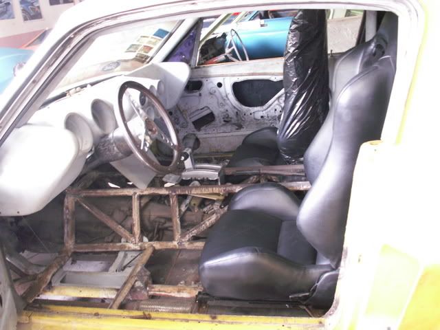

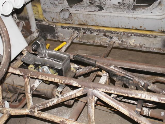

The floors are all rusted up so I decided to remove the floor boards and do a space frame backbone.
http://farm3.static.flickr.com/2207/...c42a2816ee.jpg http://farm4.static.flickr.com/3129/...d66e8e97b5.jpg http://i268.photobucket.com/albums/j...n/PICT0003.jpg http://i268.photobucket.com/albums/j...n/PICT0004.jpg http://i268.photobucket.com/albums/j...n/PICT0002.jpg |
The car has been turned to a true 2-seater.

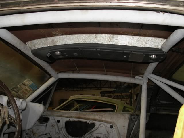

Overhead console mounted on the roll cage.
http://i268.photobucket.com/albums/j...n/PICT0008.jpg http://i268.photobucket.com/albums/j...n/PICT0007.jpg |
