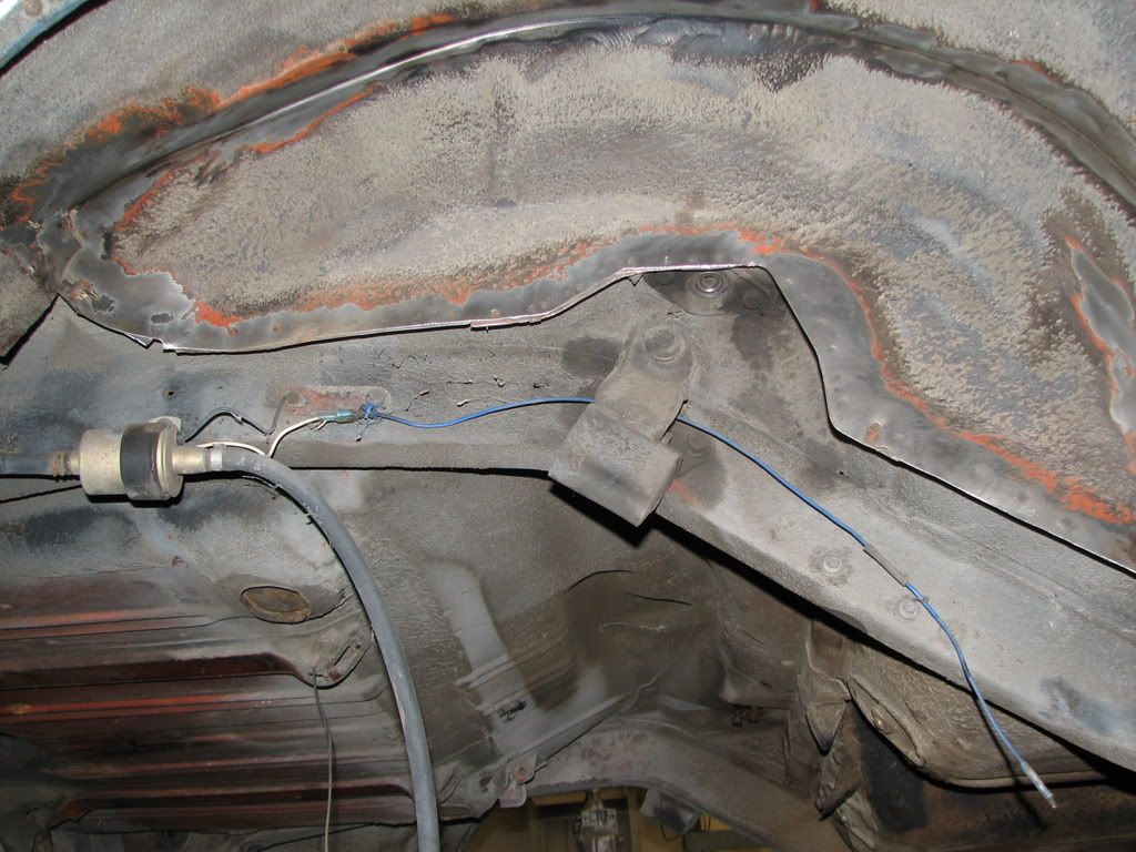

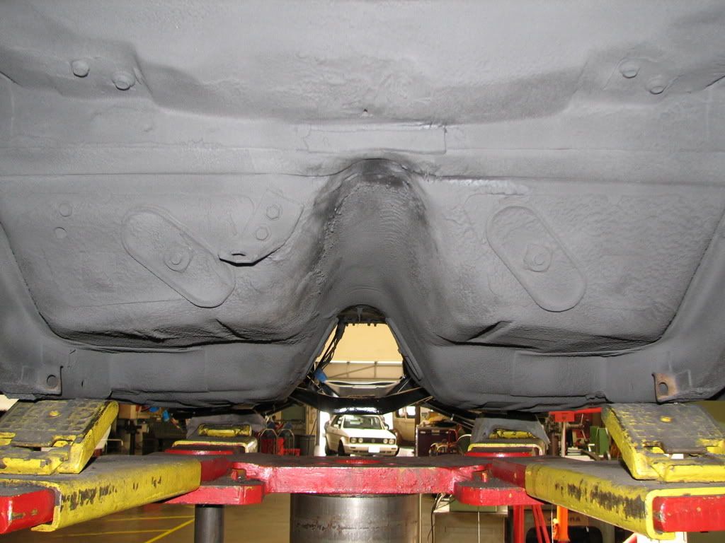

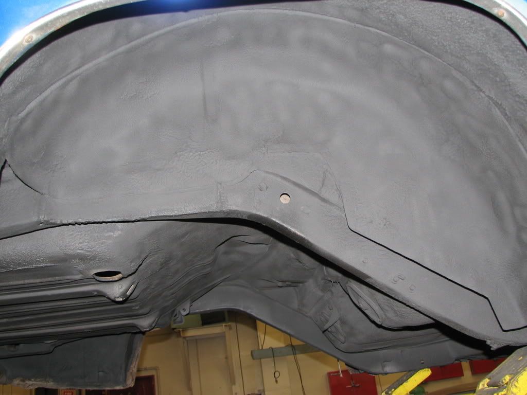

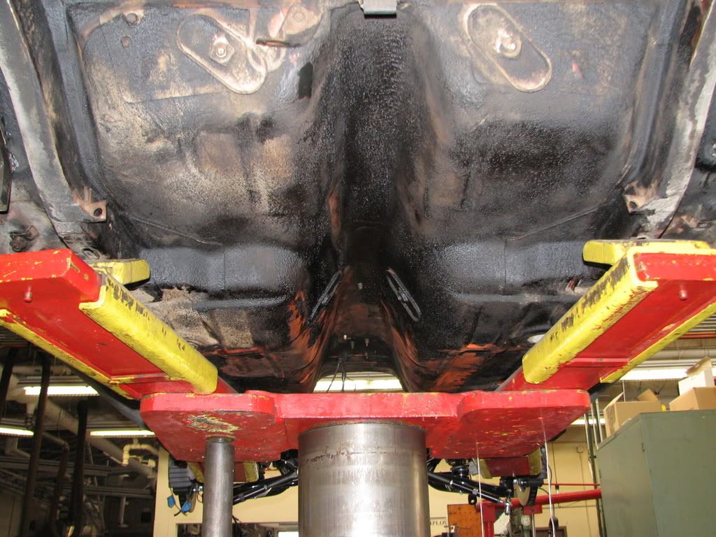

Used Lizard skin on mine after mini-tubbing:
Before:
http://i328.photobucket.com/albums/l...e_After003.jpg http://i328.photobucket.com/albums/l...e_After005.jpg
After:
http://i328.photobucket.com/albums/l...e_After004.jpg http://i328.photobucket.com/albums/l...e_After006.jpg
The after pics show a med grey, but over the course of about a week dried to a dark grey as show in this pic:
http://i328.photobucket.com/albums/l...pension035.jpg
So far happy with it.
