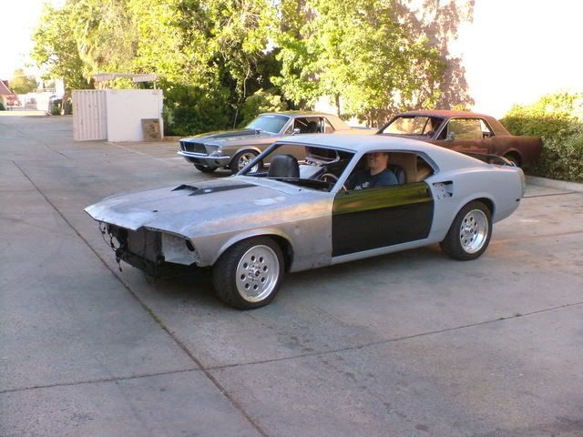

CptKlutz 01-01-2009 10:34 AM
I was lucky to get a stranded project from a guy in Portland, looked like this when it rolled in:
http://i300.photobucket.com/albums/n...ans69fbdy3.jpg
The previous owner did a very good rust revival, new rear qtrs, inner wheelwell, floors, rear valance, tailpanel and what not. Completely clean now though.
