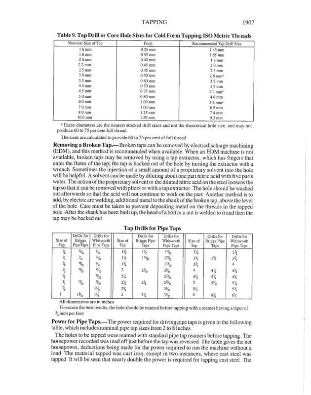

I am installing a Auto Kraft oil pan on my ls1 block but there is a extra hole on the oil pan itself. I need to tap the block but I am not sure what size bit to drill with to tap hole to 8x1.25 to match other holes. I have talked with a few people who say it must be tapped or will leaki and we know we do not want that so what size drill bit do I use???? You can not tap with oil pan on due to pan block you froma straight angle to drill/tap. So please help me out if you can guys.
ccracin 01-08-2009 12:16 PM
The recommended Tap drill size for this hole is 7.4mm.
This chart should help.
http://i140.photobucket.com/albums/r...cTapdrills.jpg
brans72 01-08-2009 05:51 PM
guess i will use closest in american since i don't have a 7.4 mm :rolleyes:
Ruslow 01-10-2009 07:37 PM
Just drilled and tapped that size.Used a 17/64 drill.STan
