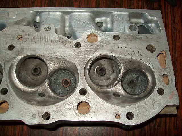

g356gear 01-15-2009 10:36 AM
Do these heads look a little off?
http://i20.photobucket.com/albums/b2...1914_0_ALB.jpg
http://i20.photobucket.com/albums/b2...51914_0_BG.jpg
MarkM66 01-15-2009 10:45 AM
Gravel down the intake?
Vegas69 01-15-2009 10:49 AM
Make good paper weights.
Swain 01-15-2009 11:22 AM
Could of been the Tornado installed in the intake pipe:lol:
deuce_454 01-15-2009 11:32 AM
it would appear that somone welded the chambers and changed the combustion chamber shape... not a great job though
buickfunnycar.com 01-15-2009 12:11 PM
looks like someone needs new heads...:yes:
camcojb 01-15-2009 12:18 PM
looks like a motor expired and debris beat up the heads a bit. Technically they could probably be repaired, but doubt it's worth the money to do so.
markss28 01-16-2009 01:44 PM
dude I say put them back on they look better then some port polish work. No Just kiding. like said earlier, paper weights
Rusty G 01-16-2009 06:57 PM
That's someone filling the area in as stated above.
As long as everything else checks out, have the voids filled by someone that knows how to weld, deck them and bolt em up.
