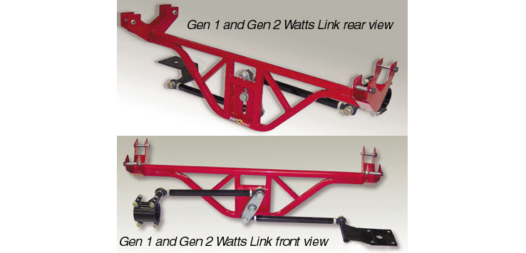

I don`t know of any bolt on panhard bars for 1st gens but they were used with some success on TransAm racing years ago. Problem with a PHB is that even long ones swing the axle in an arc and side load the springs. The RC also moves vertically the same way it does with the stock leaf springs so there`s no improvement there. A better solution kinematically is a frame mounted watts link. It keeps the axle perfectly centered with no additional side loading and the rear RC height stays exactly the same distance from the rear CG at all times keeping that moment arms exactly the same at all times. In general it will make the rear suspension feel much more precise. It also has what I`d describe as a calming effect on the rear end of the car. You can really get stupid with it and the car won`t bite you. They`re also available as a simple bolt in. http://www.scandc.com/wattslink.htm The pics toward the top are 1st Gen with leaf springs. Mark SC&C

I have installed an sc&c/fays2 watts and im really happy with the product.. took a couple of hours to install and the car feels much more refined and predictable...
watts and leafs is used widely in scca and av8 open track racing, which is what fays2 started out making the unit for.... and its a direct bolt in deal.... all you need is a drill, and a handfull of wrenches
http://www.fays2.net/images/Gen%201%...tts%20link.jpg

I had a Competition engineering panhard bar that I made work with leaf springs on my 69 Camaro. The Watts link kit above looks badder asser though!
