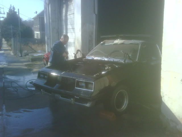

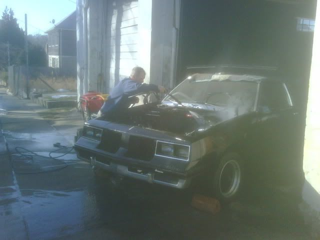

Today the motor and tranny were finally dropped in! It was a beautiful day out, and everything seemed to go just about right. Before we dropped the motor in, we steam cleaned the engine bay:

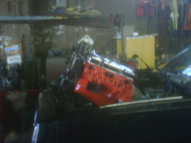

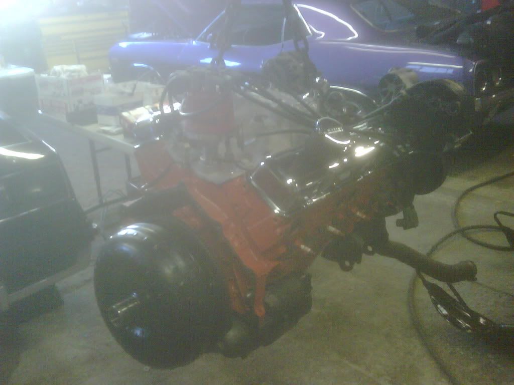

We joined the motor with the tranny and hooked it up to the forklift and got it ready to drop in.
http://i203.photobucket.com/albums/a...90201-1224.jpg

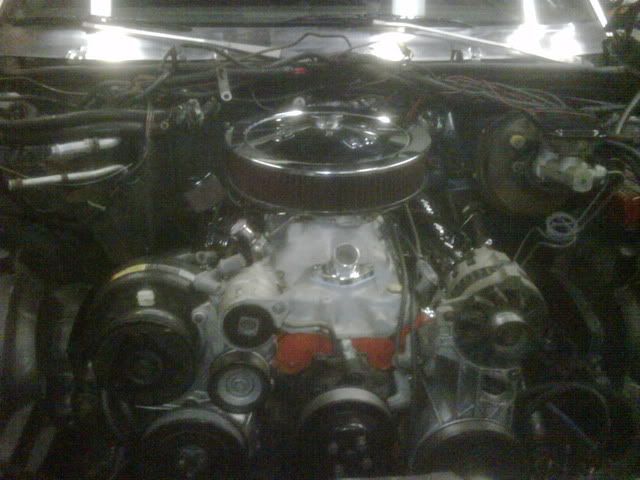

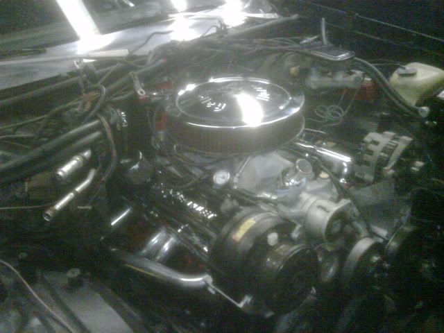

Cutlass2181 02-01-2009 09:45 PM

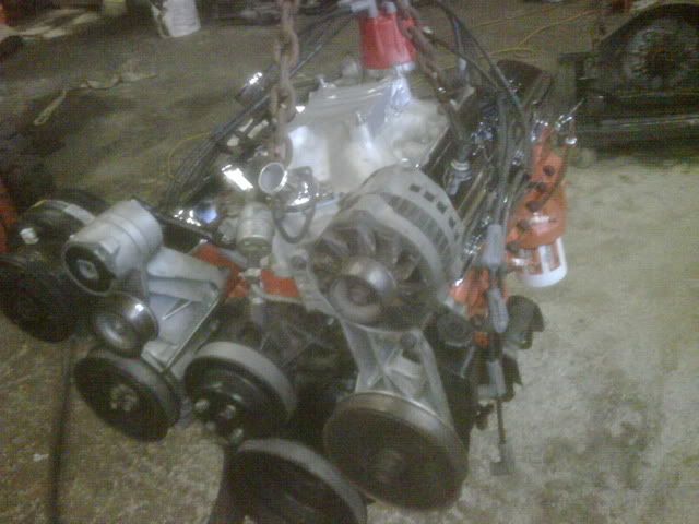

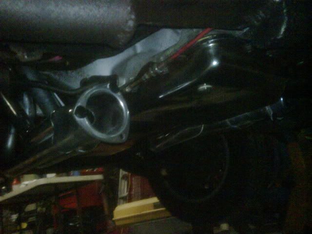

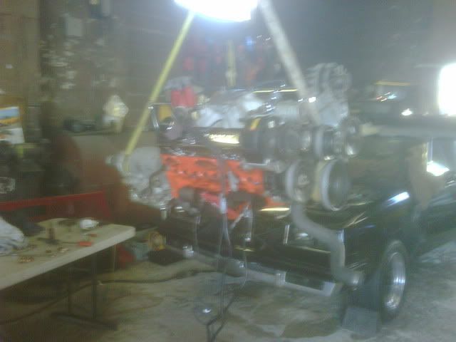

Lowering it in was pretty easy, like I said everything seemed to fall into place today, Except for the fact that we forgot to lay the headers in the bay before we bolted the motor in. so it was fun to jack up the motor and maneuver the headers into place, but we got it done. Got the carb on, the air filter, starter, oil filter on and fuel pump.
http://i203.photobucket.com/albums/a...90201-1511.jpg
http://i203.photobucket.com/albums/a...90201-1901.jpg
http://i203.photobucket.com/albums/a...90201-1902.jpg
http://i203.photobucket.com/albums/a...90201-1903.jpg

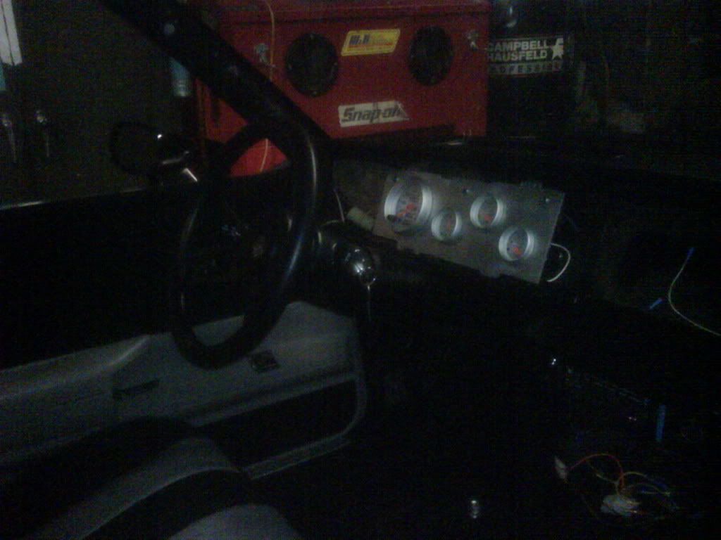

Tomorrow were going to start the wiring, and fire her up. Then comes a little more welding inside the car, then the interior can be put back in. then the gauges get wired in, and interior wiring gets done. Then the car is being sent to all American muffler for custom exhaust piping, and then paint finally.

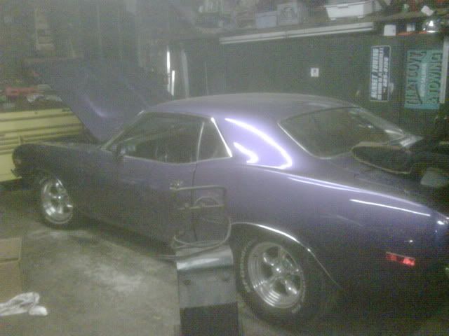

Cutlass2181 02-08-2009 08:51 PM

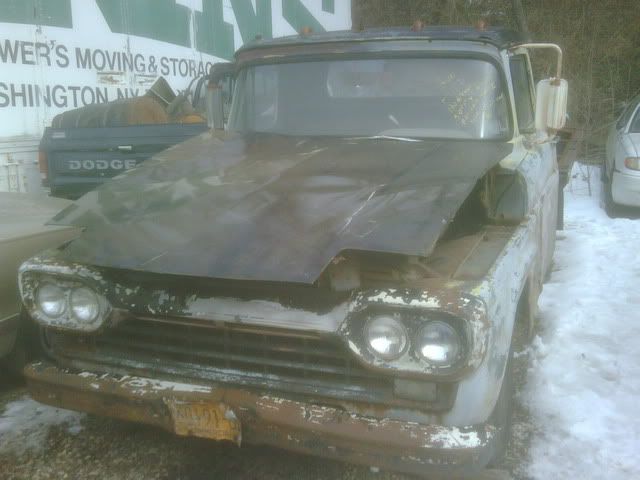

So before the car gets sent out for exhaust piping, we decided to try to assemble most of the interior. We had to improvise for some sheet metal for the drivers side front floor. Found an old 52 for pickup with a rust free hood, so we borrowed it. The metal worked perfectly and fit like a glove after some cutting of course. Again, I forgot my camera so I had to use the phone, but ill have good pictures soon.
http://i203.photobucket.com/albums/a...90207-1255.jpg
http://i203.photobucket.com/albums/a...90207-2258.jpg

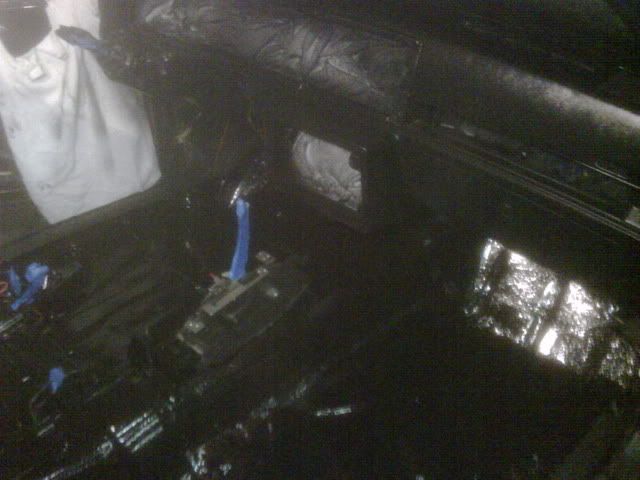

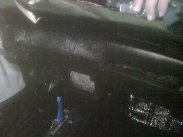

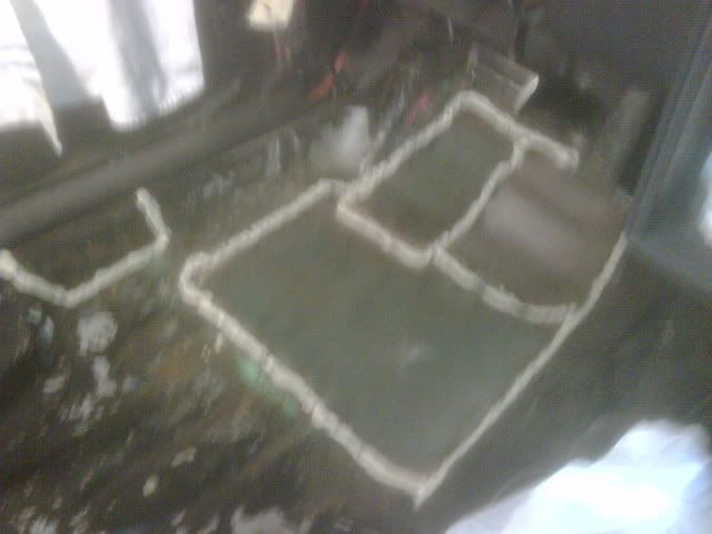

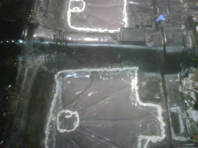

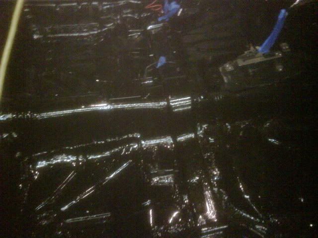

We got the welding all finished, seam sealed, and por15ed the whole floor.
http://i203.photobucket.com/albums/a...90208-0035.jpg
http://i203.photobucket.com/albums/a...90207-2329.jpg

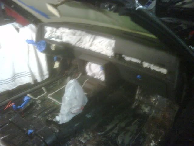

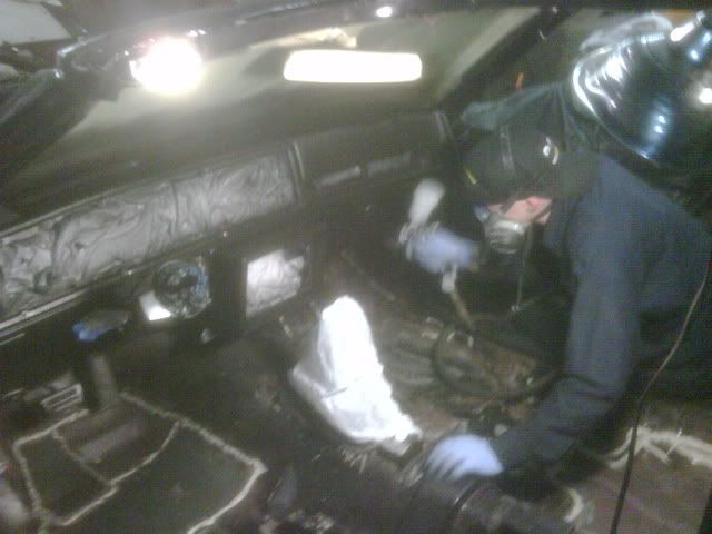

We painted the dash in the car and taped everything off. The dash came out amazing, looks like its right from GM.

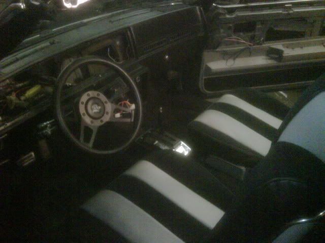

Cutlass2181 02-08-2009 08:52 PM

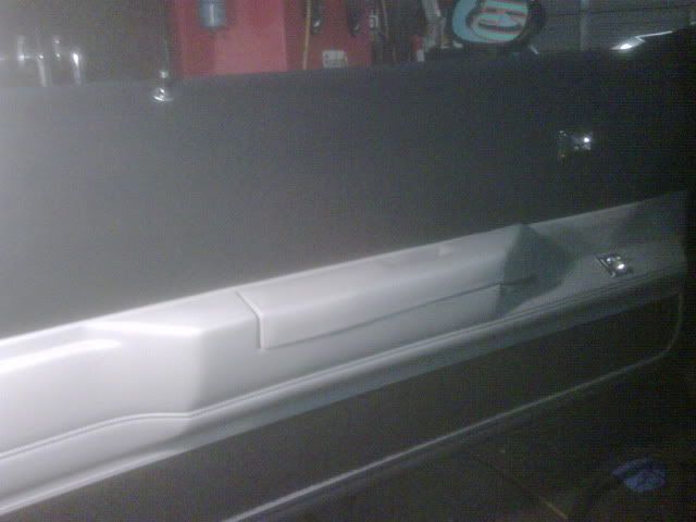

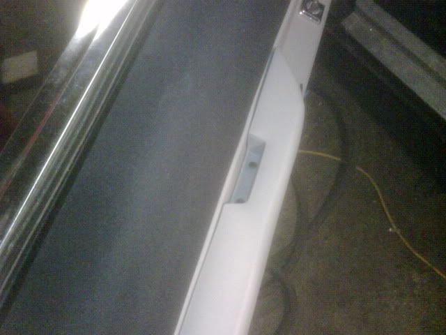

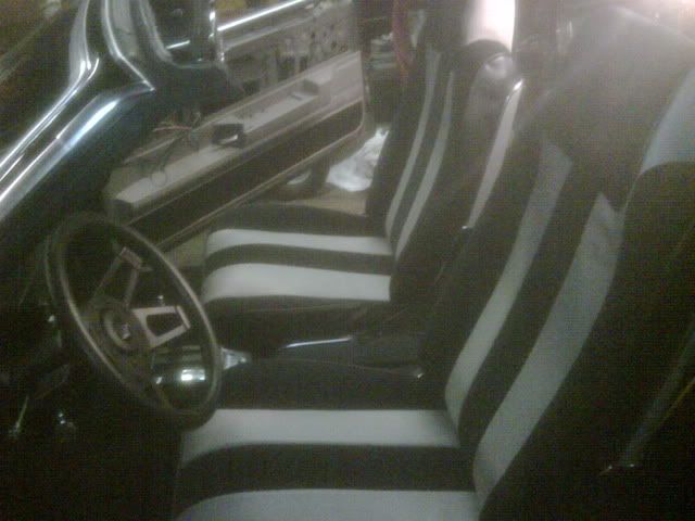

Today we started to throw in the interior pieces like carpet, seats, steering wheel, radio, and some of the paneling. We put in the door panels that I painted and had reupholstered, and they look amazing. They weren’t easy at all to get in, but once we figured out a way, we repeated on the other side. Each set of panels is a whole project in itself with screws, fitment, and most importantly the order you throw them on in. We are going to try to have most of the interior done by the time the car goes out for exhaust, but who knows.
http://i203.photobucket.com/albums/a...90208-1959.jpg
http://i203.photobucket.com/albums/a...90208-2216.jpg
http://i203.photobucket.com/albums/a...90208-2142.jpg
