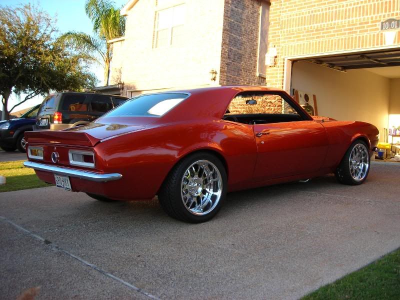

+1 on the G-bar\g-bar ready moser rear. Ride is very good, adjustability is nice too. No cutting, we welded this one in as well.
http://i99.photobucket.com/albums/l2...o/DSCN0471.jpg
I'll go crawl under the car and get you the pics installed if you like. I don't have any now cause I can't get under the damn thing without jackstands. I think I am going back to building off road vehicles.:D
