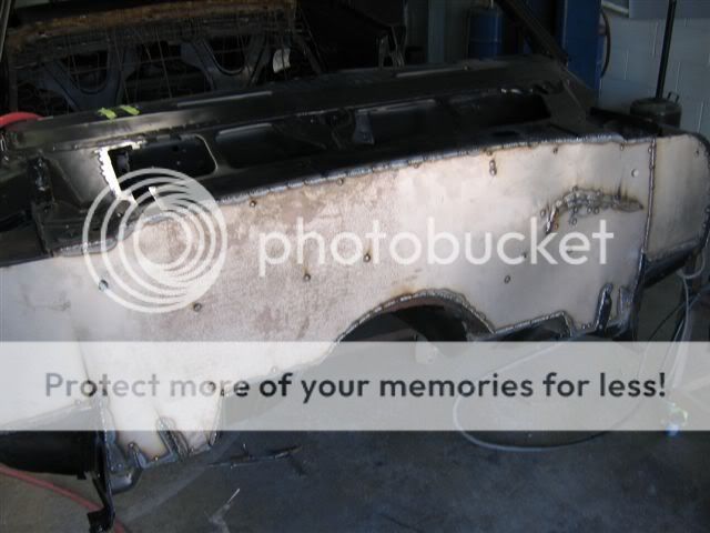

So far so good! My first welding project has been going pretty good. Its been a good learning experience. Ive good pretty much all of it done but the tunnel section. I havent welded it yet because I dont know how high I have to go to fit the LS2. To those that have done it how high did you go up? Past the stock arch so lower? Did you make a new tunnel to weld in of worked the stock firewall to fit? The goal is to keep it as smooth as I can. Thanks for any bit of info!

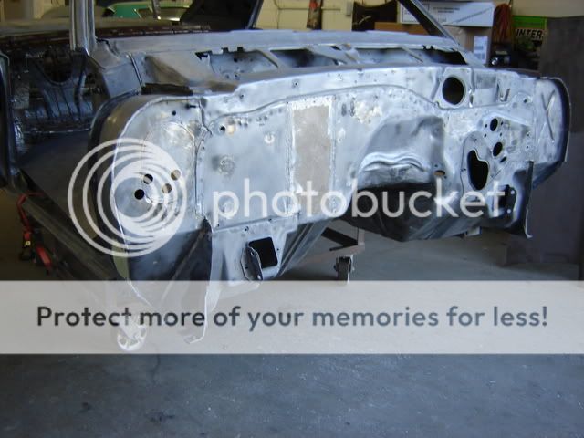

The LS2 doesn't protrude into the tunnel area. You should only have to modify the tunnel if your particular subrame pushes certain transmissions too high.
I hope that made sense, it's hard to explain. We only had a fab a small part to mate the tunnel to the new firewall, but it didn't raise the tunnel at all.
http://i39.tinypic.com/nbfchz.jpg

Got it, thats a good pic. Yes the right side of the tunnel is the only sot I have to work with the rest is pretty much a straight weld. Thanks for the pic.

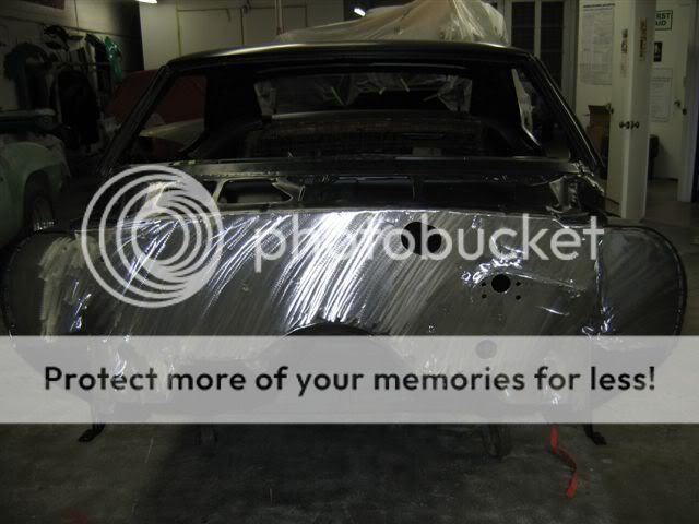

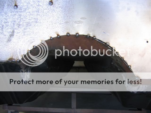

Hey, I just had Best of Show make a firewall for my 69 right after they did the one for Steve's Track Rat. They cut out all of the old firewall and replaced it with a with a piece of sheet metal cut from a cardboard/foamcore like template. Here are some pics they took.
There's the old one:
http://i366.photobucket.com/albums/o...A/DSC00831.jpg
and the new one.
http://i366.photobucket.com/albums/o...SA/shop002.jpg
http://i366.photobucket.com/albums/o...SA/shop003.jpg
http://i366.photobucket.com/albums/o...SA/shop010.jpg
