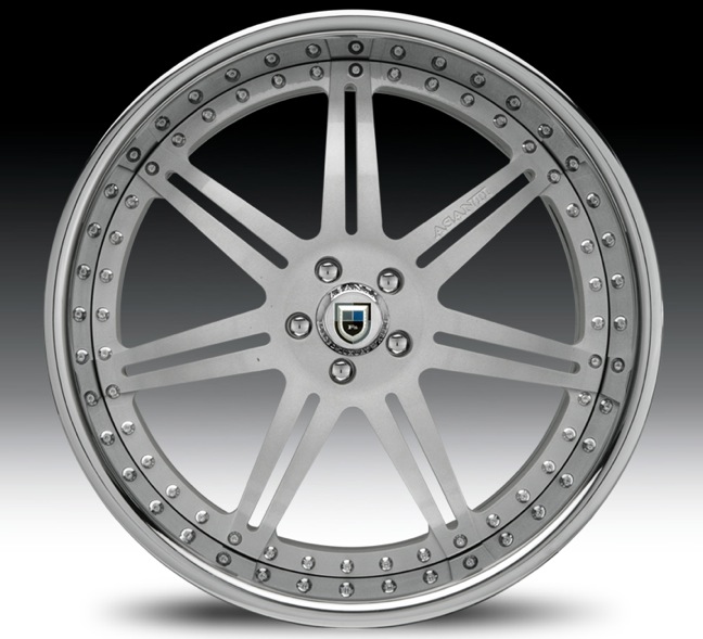

For what its worth. The wheel choice is moving to 19" diameter Asanti 3 piece deals. I need to look around for tire selection for that size wheel. Thats beyond the outer limits for my knowledge.

qwkswede 03-17-2009 11:12 PM
1 Attachment(s)
Here is the wheel choice today. It will be something from Asanti more than likely.
Attachment 16726
