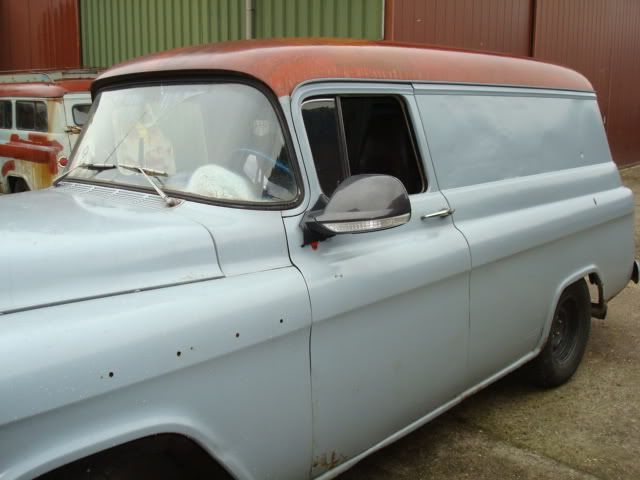

O.K. a question for my old parts hauler, a 56 Chevrolet panel truck.
Because of the closed panel sides, save driving is more than a chance of luck with the small side mirrors.
So i came up with the next thing, find some mirrors that i could use and fit the style of the truck(i know my taste is famous:lol: )
Found some mirrors full elect. about 20 wires in each of them and fitted them to my truck.
http://i17.photobucket.com/albums/b9...5/DSC00883.jpg
http://i17.photobucket.com/albums/b9...5/DSC00884.jpg
Now i need to remodel the base to follow the shape of the doors.
There is a gap from 1 '' to 1/8 to fill.
What kind of stuff to use, like to bond it to the org. mirror feet (the abs plastic) so the finnished product can be fitted to the door with a thin rubber gasket between the door and mirror
Hope some one can help.
Wander
GMracer 03-17-2009 12:07 PM
I've seen a couple guys use ABS plastic sheets then use the shavings from cutting it mixed with MEK (Methylene ? ?) I have NO clue what it's called haha, but I know its MEK and that will make an ABS plastic adhesive and build it up let it dry and sand it smooth.
caper150 03-17-2009 03:20 PM
http://www.tcpglobal.com/autobodydep...ixplastic.aspx
Duramix makes some good products for that type of repair.
