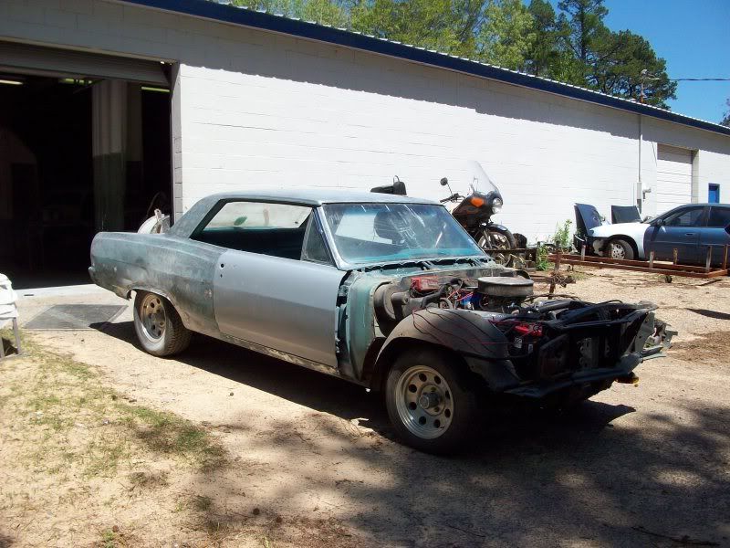

I have been working hard to get the body work and paint done on my 65 Malibu and here is the progress.
I apologize for the engine being so filthy. I am really doing this project backwards right now since I am doing paint first. I will be doing all the suspension later when funds allow. I work part-time at a Corvette restoration shop, so I have access to everything to take care of the body work first.
I have made several patch panels. I have a new glasstek 2" cowl hood going on, one new front fender, and both rear quarters will be replaced.
I stripped the car back mostly to metal with Capt. Lee's Auto Spra-Strip. The car is mostly in Du Pont Epoxy primer as of today, but I will have those pics tomorrow when I get it out of the booth.
Keep in mind I am doing all this myself and still learning more along the way.

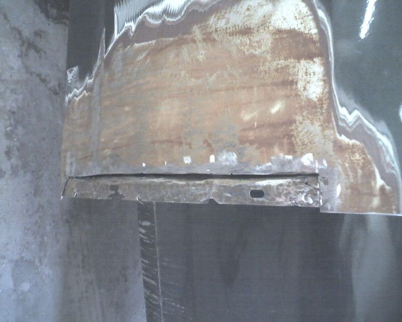

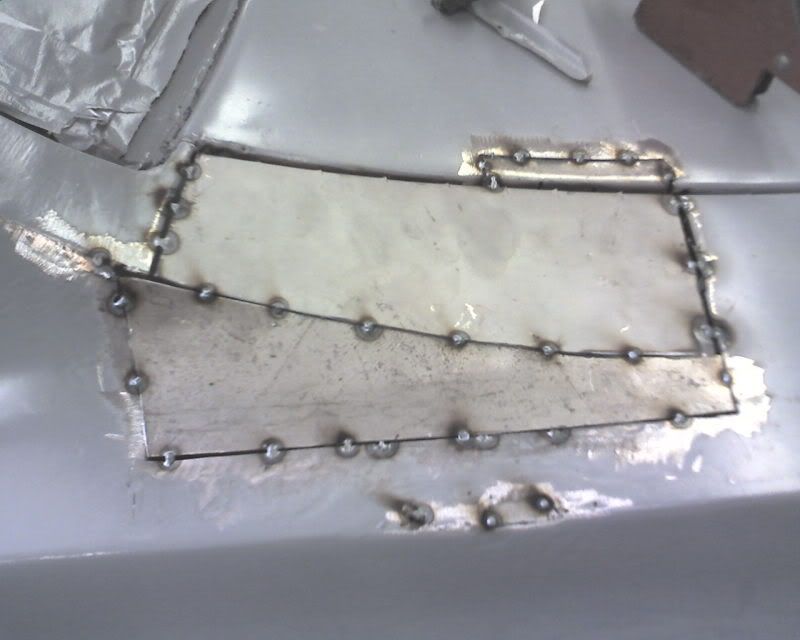

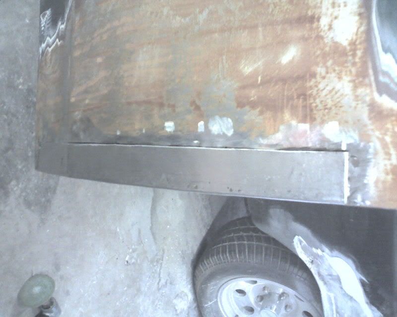

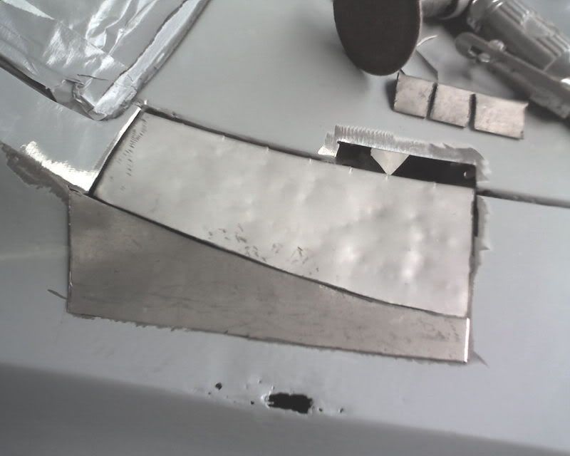

This is the drivers door edge by the latch. pic is turned on its side. I had to cut the rust out and make a panel to wrap around the edge like the factory skin.
http://img.photobucket.com/albums/v3...ild/img145.jpg

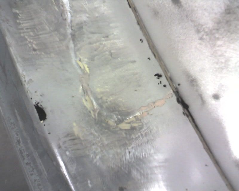

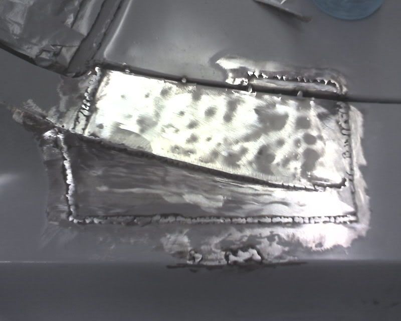

here is the panel I butt welded in.
http://img.photobucket.com/albums/v3...ild/img146.jpg

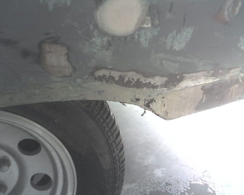

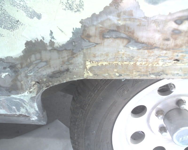

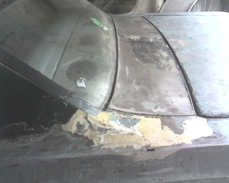

Rust, Rust, and more Rust. It will all be taken care of soon.
http://img.photobucket.com/albums/v3...ild/img154.jpg
http://img.photobucket.com/albums/v3...ild/img155.jpg
http://img.photobucket.com/albums/v3...ild/img156.jpg
http://img.photobucket.com/albums/v3...ild/img157.jpg
http://img.photobucket.com/albums/v3...ild/img158.jpg

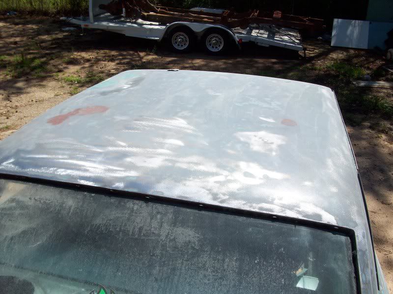

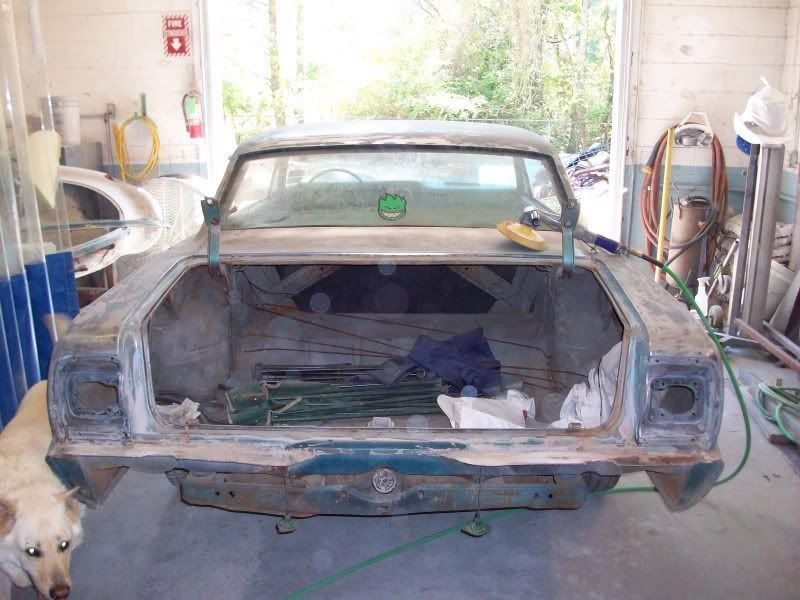

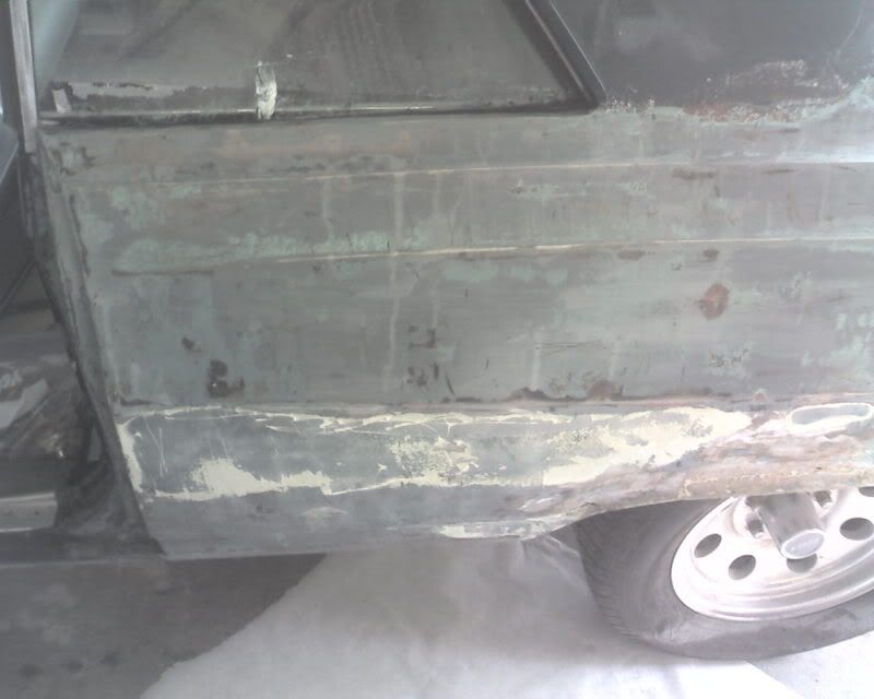

And these are random pics showing the stripping.
http://img.photobucket.com/albums/v3...d/100_3150.jpg
http://img.photobucket.com/albums/v3...d/100_3153.jpg
http://img.photobucket.com/albums/v3...d/100_3154.jpg
TonyG 03-29-2009 05:42 PM
http://img.photobucket.com/albums/v3...d/100_3156.jpg

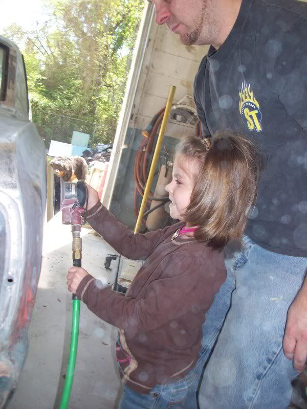

And these pics are of me training my helper.:D
http://img.photobucket.com/albums/v3...d/100_3165.jpg
http://img.photobucket.com/albums/v3...d/100_3167.jpg
http://img.photobucket.com/albums/v3...d/100_3170.jpg
http://img.photobucket.com/albums/v3...d/100_3171.jpg

gearheads78 03-31-2009 08:51 PM
Nice project and helper pics. You need to get a particle mask on her though.:yes:
TonyG 04-01-2009 03:16 PM
oops. I will get her one soon.
She still hasn't talked me into painting it pink, but it is not for lack of trying.:D

This is what I worked on for a couple hours today. I will weld it in tomorrow.
http://img.photobucket.com/albums/v3...ild/img159.jpg
TonyG 04-03-2009 07:17 PM
Finished this patch and welded it in.
http://img.photobucket.com/albums/v3...ild/img160.jpg
http://img.photobucket.com/albums/v3...ild/img161.jpg
