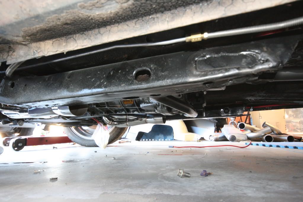

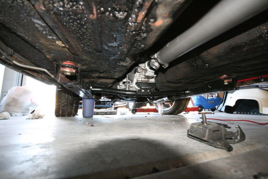

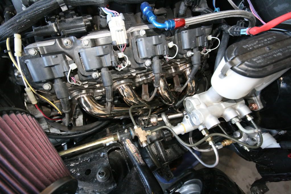

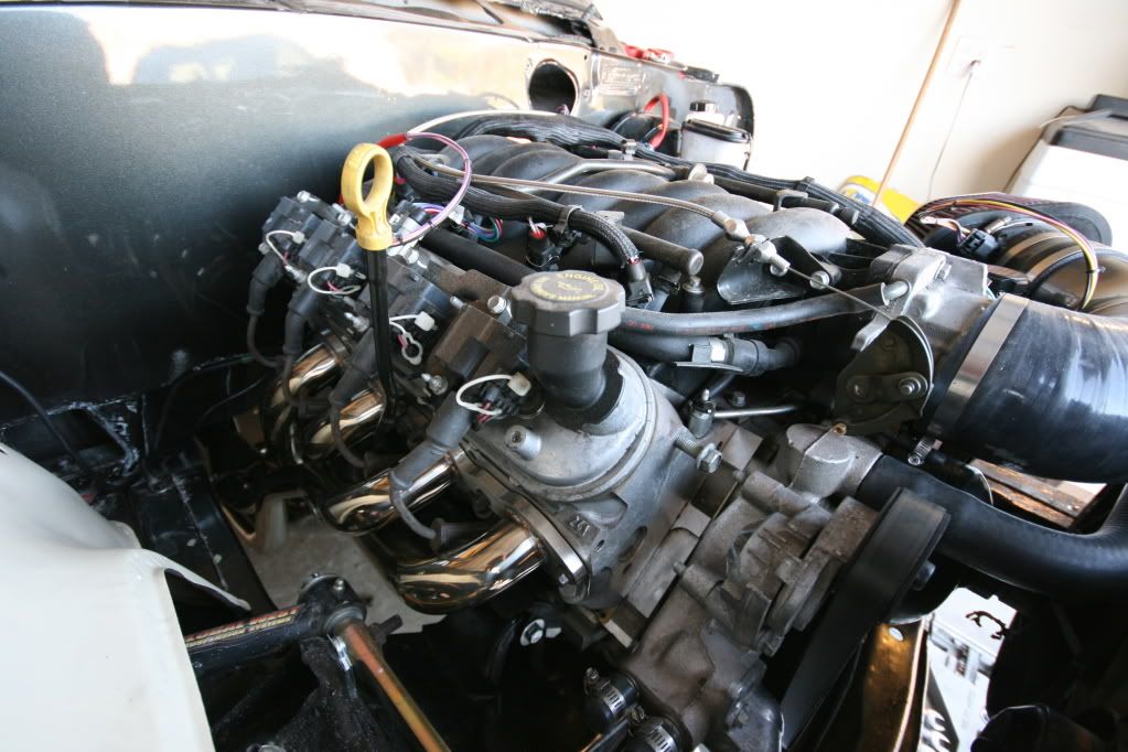

They dont fit perfect but they will work. They are stainless steel and cost 500$. I have unisteer rack and pinon steering and I just have to put a very small dent to clear. My problem is the crossmember. It is smack dab in the middle of my headers. I need to either cut up the crossmember or route the exhaust under it but then it will hang low to the ground in that spot. Any ideas?

D Rock 04-25-2009 07:17 AM
What brand crossmember is that? My ATS tucks up alot higher so the exhaust can run under it. I would look into it.
Rybar 04-25-2009 10:30 AM
I'd also try the latest version of the ATS x-member. It tucks up tight to the floor and gives alot more header clearance.
indebt69 04-27-2009 10:28 PM
Ahhhh, good ole S&P crossmember. Exactly what I'm using on my car. I need to look at mine exactly but I also don't have much clearance. Just hate paying $300 something for a new one. Not too impressed with the S&P stuff here lately. I had to use Car Shop 1" setback plates and it barely matches up with the crossmember. That one isn't adjustable so it sets where it sets :mad:
XcYZ 04-28-2009 05:40 AM
Headers look good, but man, that crossmember has issues.
vannatta20 05-22-2009 07:45 AM
I figured out what to do. I will cut the S&P crossmember up and use 4 inch square tubing and create a notch for the exhaust to go through. Will post some pics. I should have got a ATS but didnt have enough funds for that.
