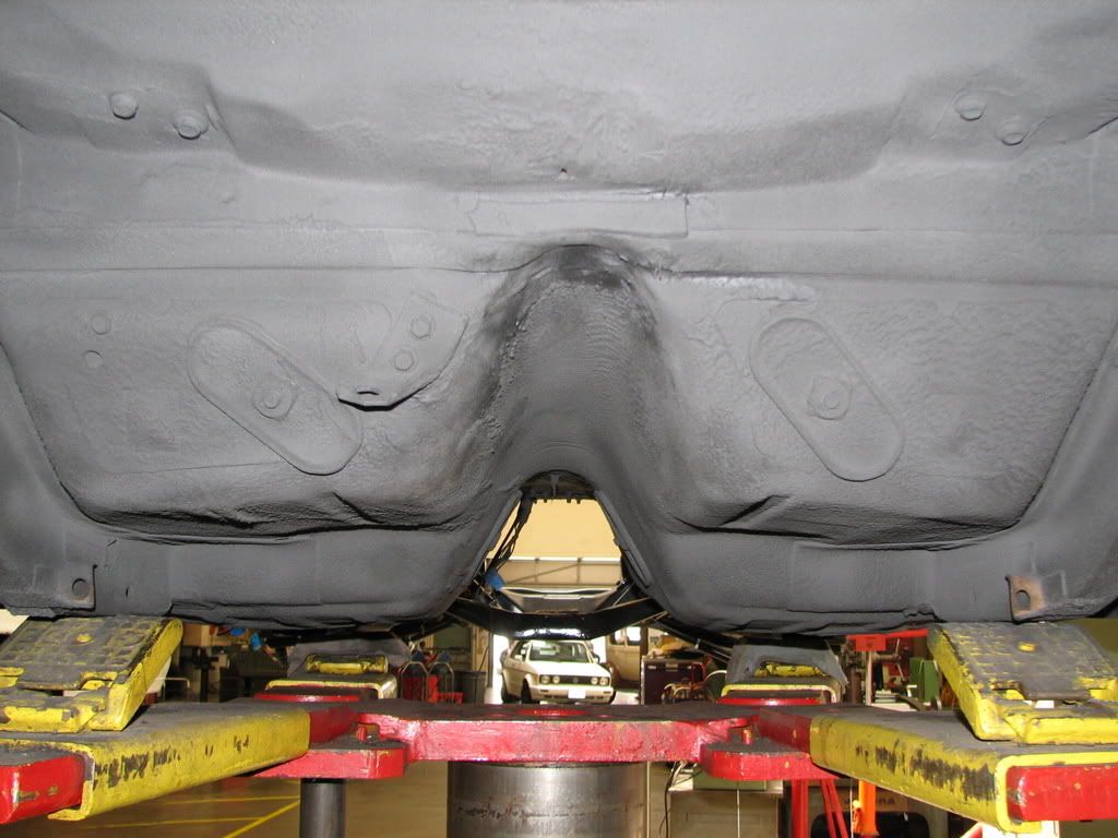

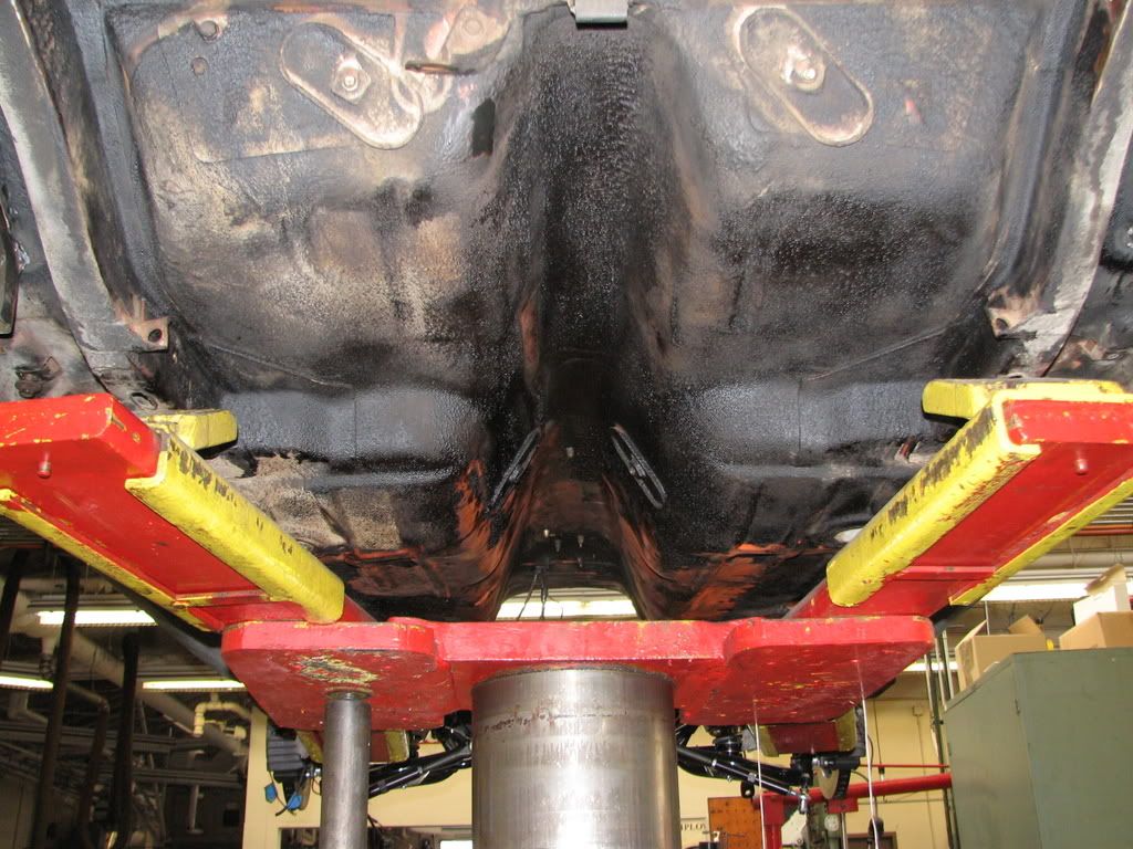

BBC69Camaro 05-09-2009 08:00 PM
I used Lizard Skin heat and sound formulas not too expensive off Summit. Just cleaned the bottom really well and sprayed it on.
Before:
http://i328.photobucket.com/albums/l...e_After003.jpg
After:
http://i328.photobucket.com/albums/l...e_After004.jpg
Dries a to more of a dark gray over the course of a week.
