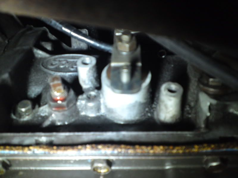

kenneth 04-11-2009 01:53 AM
Leak in a c4 transmission
After the winter storage of my 73 Mustang i found it leaking transmission oil, beside the shifter link were i had a leak last year.. How do i fix this leak?
http://i108.photobucket.com/albums/n...a/DSC00045.jpg
leos67bird 04-12-2009 05:22 PM
leaking in a c4 transmission
Your going to have to replace the band adjusting nut. It has a rubber type seal on the back side of the nut.
