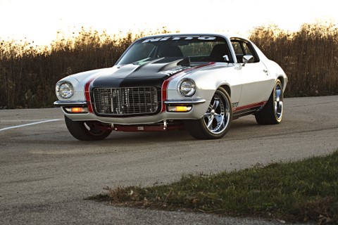

Hi Brett,
We can get you a complete subframe for $4250.00. That includes the trans crossmember, 11" Wilwood brake kit with your choice of black or polished calipers, power rack, billet coil overs, tubular a-arms, drop spindle with the 1 1/2" raised upper ball joint, and of corse the subframe. You can add $160 bucks to that for Afco coilovers. We are running 245/40R18 with 4.5" back space. With no modifications
Attachment 17184
