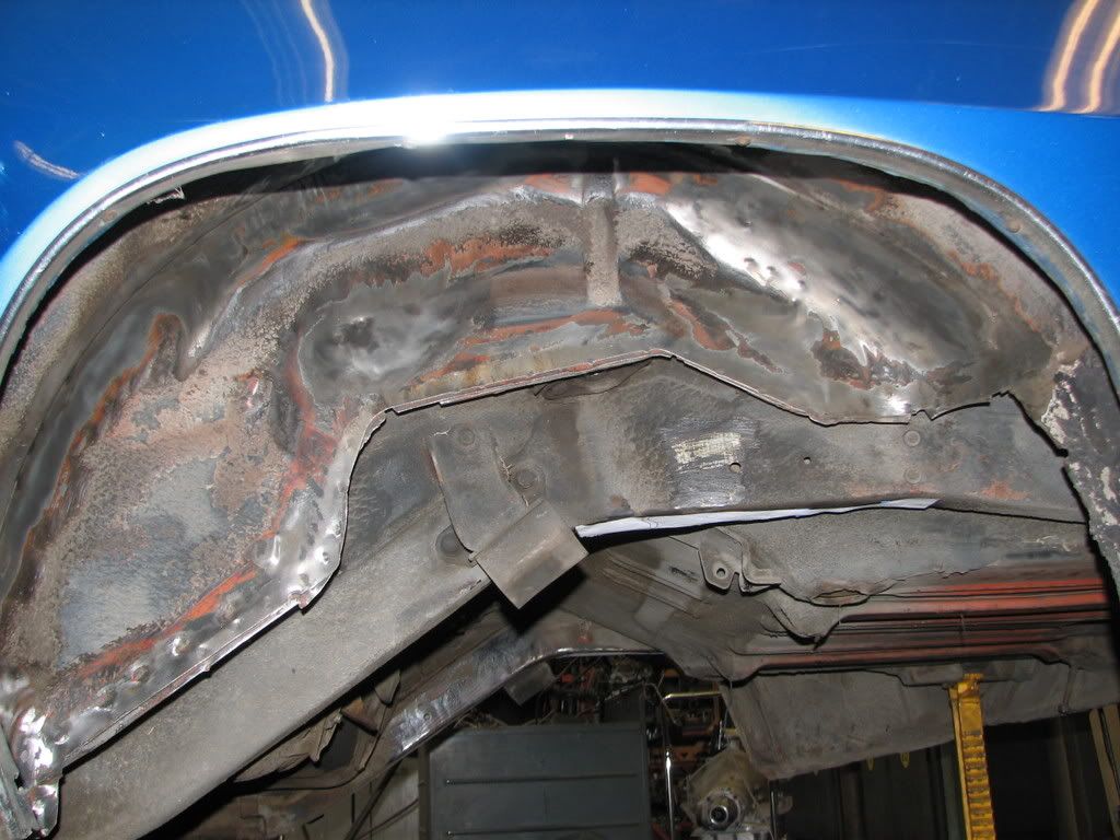

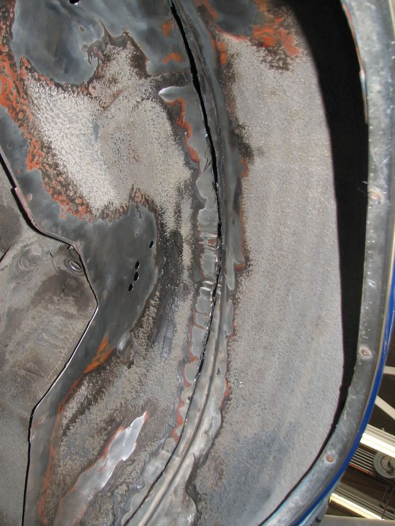

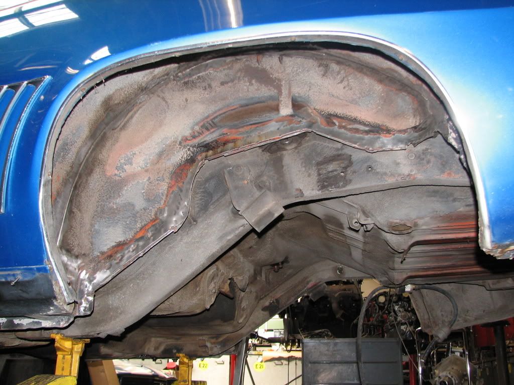

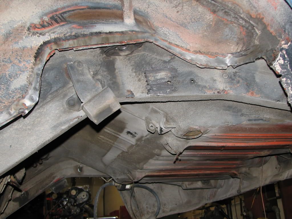

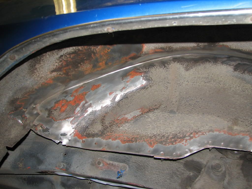

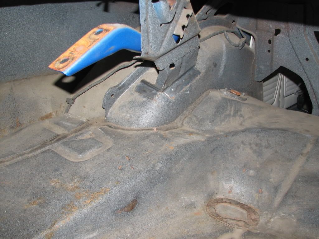

5. Now the fun starts, use the angle grinder with wire cupped brush and begin to clean off the paint and undercoating in the wheel wells:
http://i328.photobucket.com/albums/l...MiniTub003.jpg
http://i328.photobucket.com/albums/l...iniTub001a.jpg
http://i328.photobucket.com/albums/l...MiniTub002.jpg
http://i328.photobucket.com/albums/l...MiniTub001.jpg
In these pics I cleaned off more than I needed to. You really only need to find the welds that hold the rear seat brackets and deck lid braces. After that you can cut out the inner tub:

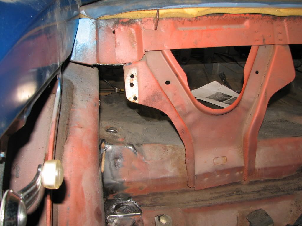

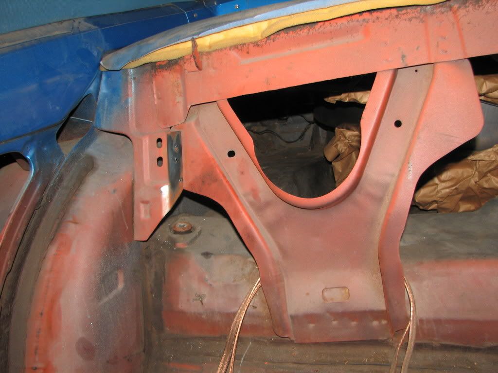

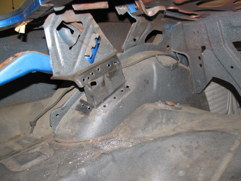

6. Next find the welds on the inside of the trunk that hold the deck lid braces to the inner tubs:
http://i328.photobucket.com/albums/l...MiniTub006.jpg
One thing that wasn't clear is, you need to resuse the deck lid braces. Make sure you are easy on them or you are going to need to fabricate new ones (DSE doesn't give you templates for this).
7. Now drill out the welds. For the ones holding to the inner tubs it is probably easier from the outside to do but inside might be easier to make sure you can resuse the braces.
http://i328.photobucket.com/albums/l...MiniTub014.jpg
http://i328.photobucket.com/albums/l...MiniTub015.jpg
I drilled them out from inside where I could then finished by drilling outside:[
http://i328.photobucket.com/albums/l...MiniTub016.jpg
http://i328.photobucket.com/albums/l...MiniTub017.jpg
Drill out the rear seat braces as well where it is held in place inside:
http://i328.photobucket.com/albums/l...MiniTub018.jpg
http://i328.photobucket.com/albums/l...MiniTub019.jpg
http://i328.photobucket.com/albums/l...MiniTub020.jpg

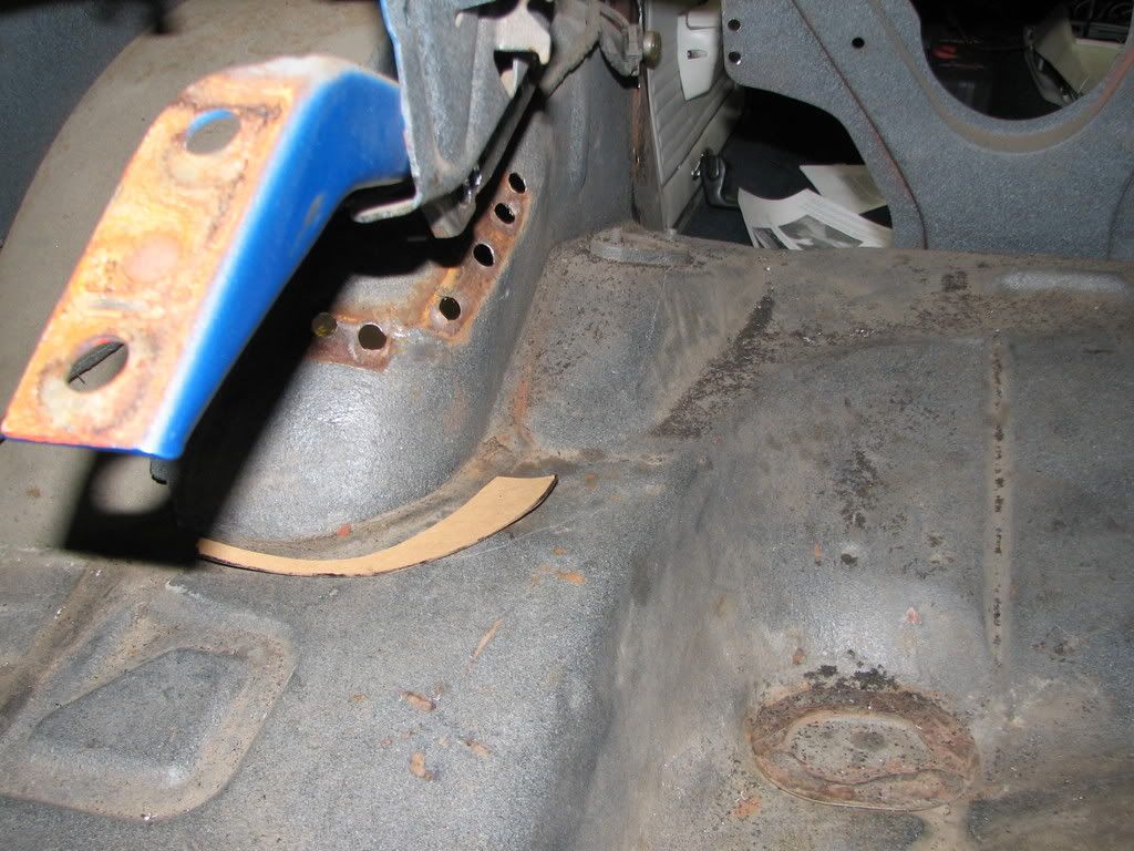

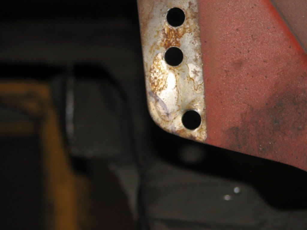

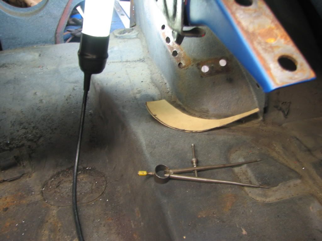

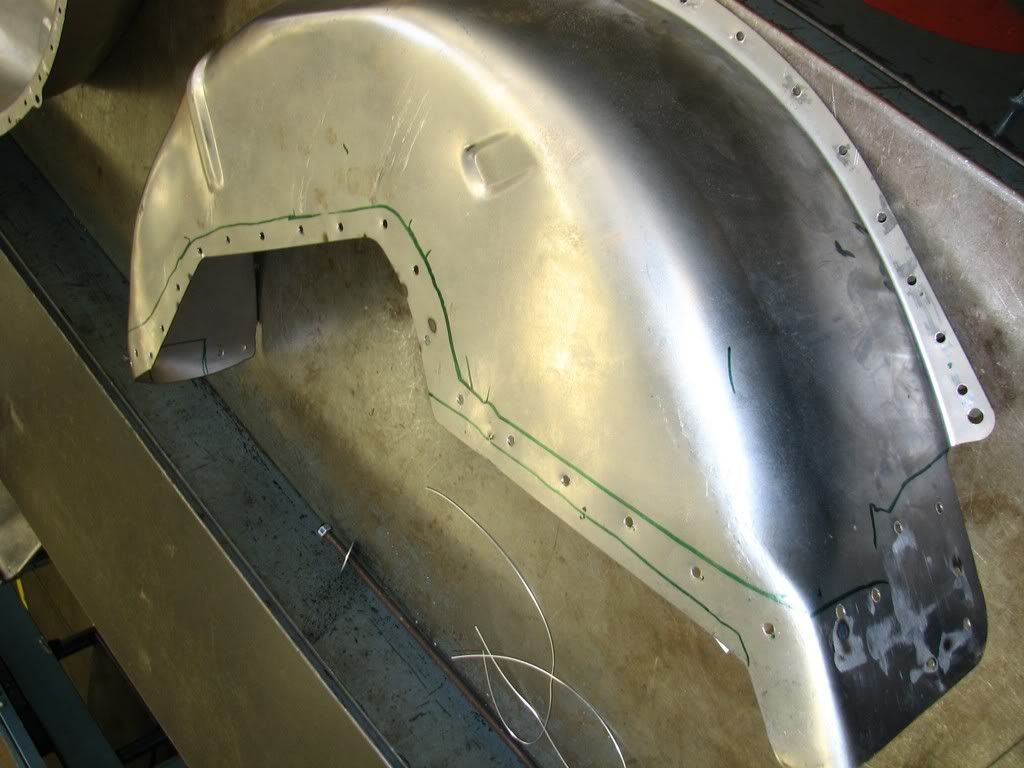

8. Follow the DSE instructions on drawing the lines you need. One thing that wasn't clear was how to get the radius at the end properly. What I did was take some paper and scribe the mini-tubs outline on the paper then take the paper and using it as a guide to scribe the same outline lining up with the lines I had already drawn:
http://i328.photobucket.com/albums/l...MiniTub022.jpg
http://i328.photobucket.com/albums/l...MiniTub023.jpg
I used to a scribe to draw all my lines.

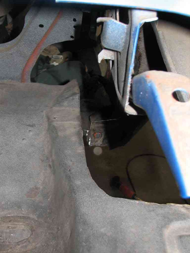

Plan on being in the trunk a lot for cutting, grinding and welding:
http://i328.photobucket.com/albums/l...iniTub026a.jpg

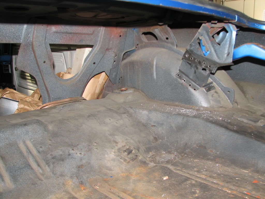

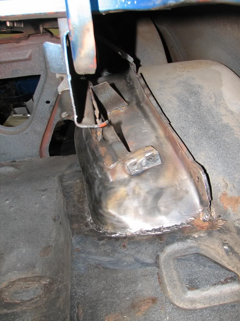

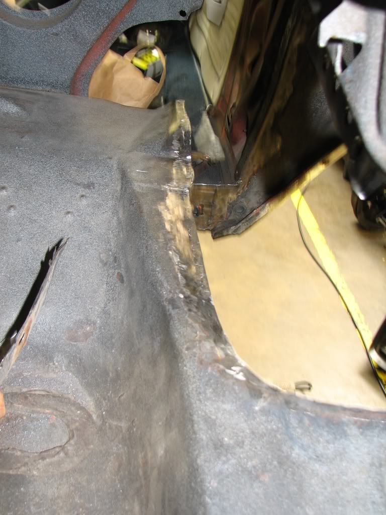

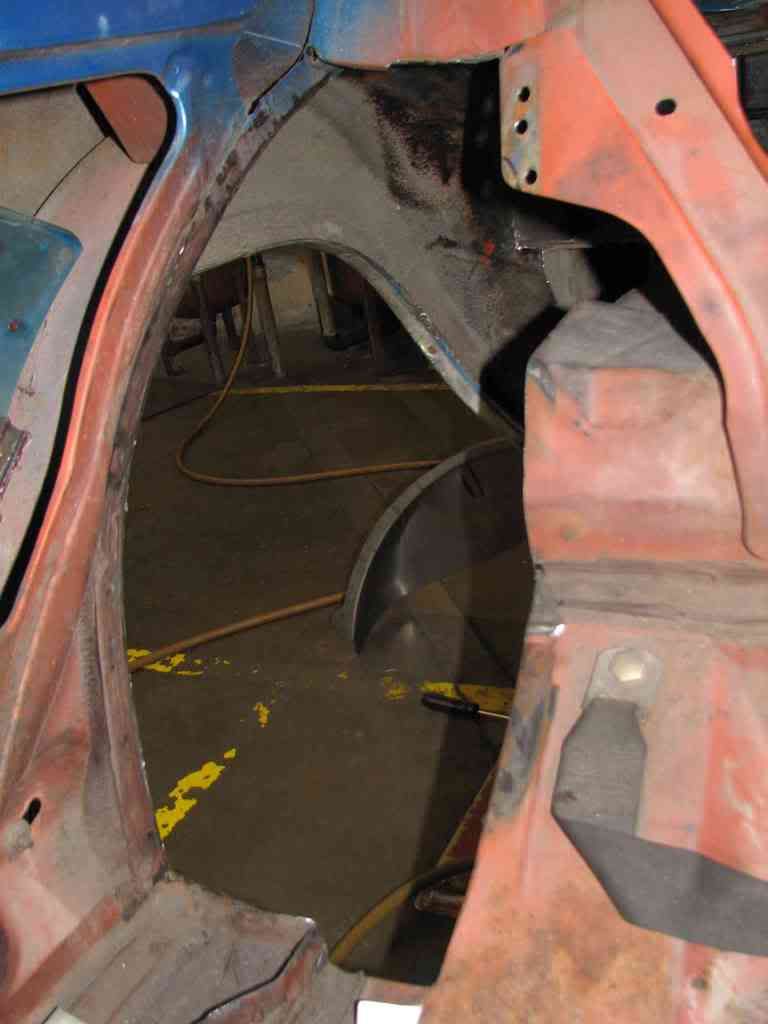

Once you have the tubs out it should look something like this:
http://i328.photobucket.com/albums/l...MiniTub027.jpg
http://i328.photobucket.com/albums/l...MiniTub030.jpg
http://i328.photobucket.com/albums/l...MiniTub029.jpg

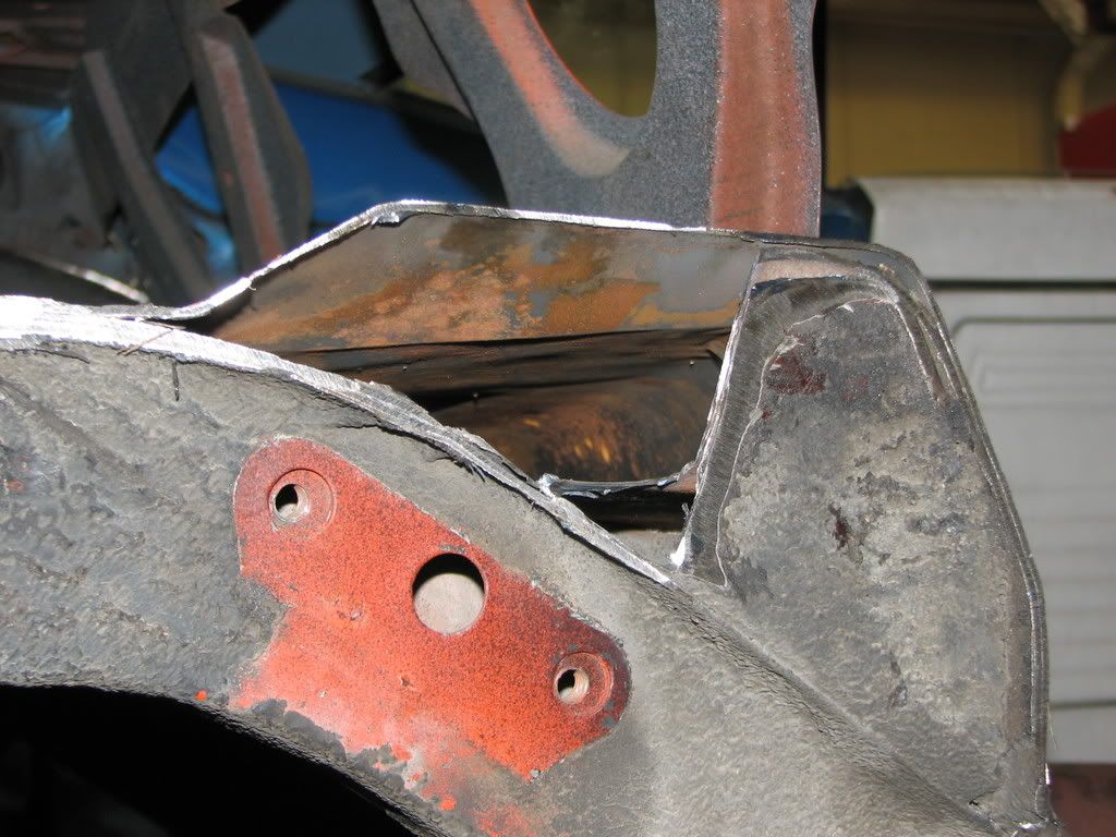

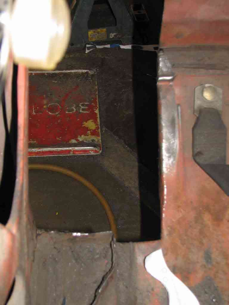

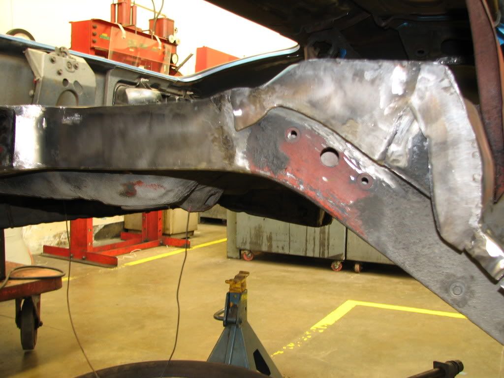

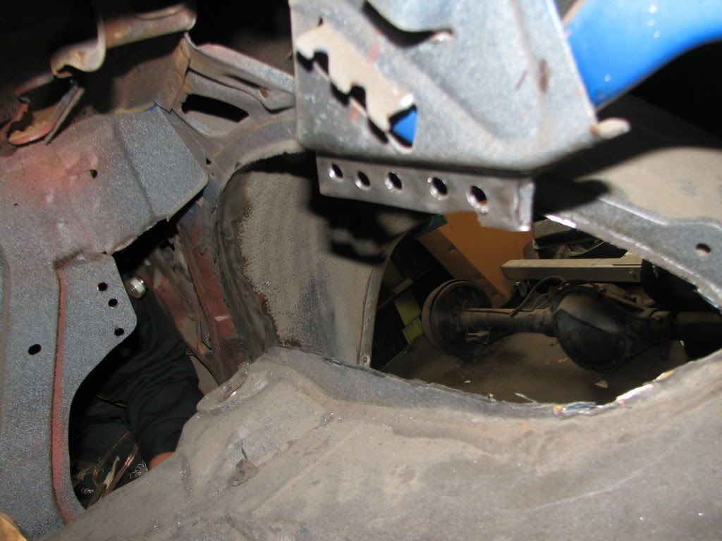

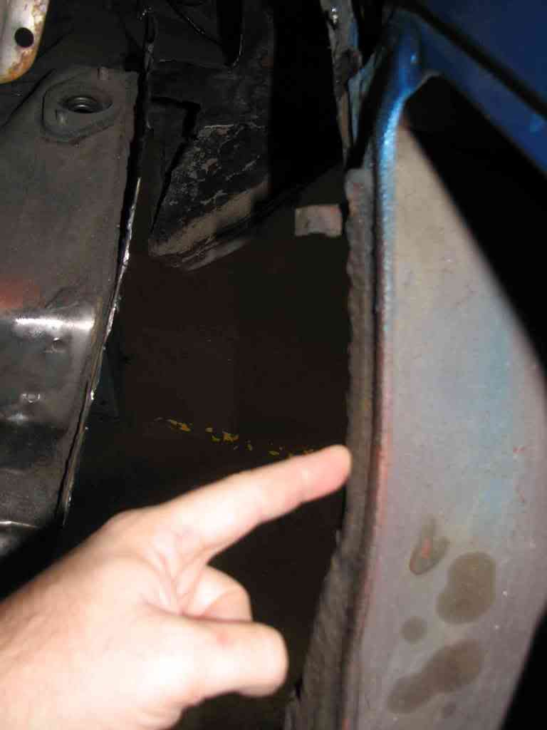

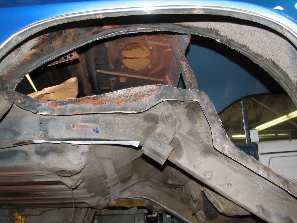

10. Now cut on your lines to remove the upper shock mounts and cut back the rear frame rail. I would cut short of the line you scribed. You can always cut more later. You want to cut just enough to fit the tubs and nothing more. I would cut short and grind to fit. Takes a lot longer but gives a much tighter cleaner install.
Just a bit more room:
http://i328.photobucket.com/albums/l...MiniTub031.jpg
Make sure to grind flush the top edge where you cut out the inner tub. You want it nice and clean so you can mount the new tubs to that flange:
http://i328.photobucket.com/albums/l...MiniTub033.jpg
I found that I need to clearance bit the tabs that had the old seat brace brackets so I could fit the mini-tubs in properly:
http://i328.photobucket.com/albums/l...MiniTub034.jpg
http://i328.photobucket.com/albums/l...MiniTub032.jpg
11. Now fold over your flaps as directed in the DSE instructions:
http://i328.photobucket.com/albums/l...MiniTub037.jpg

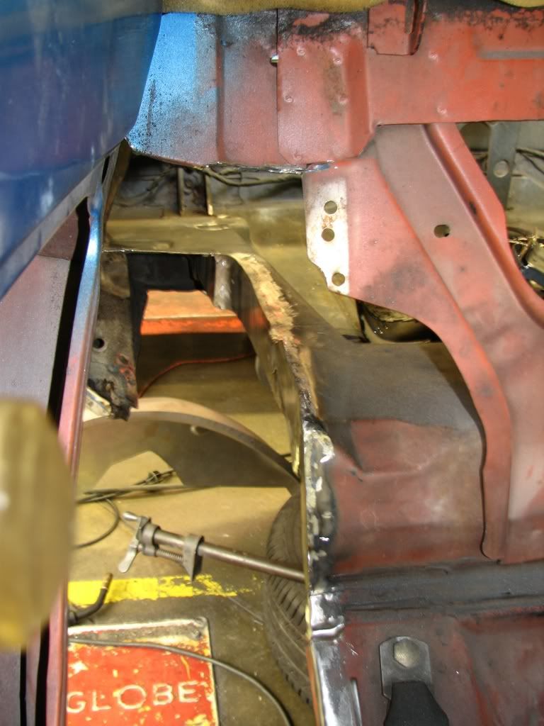

12. Clean up the cutout areas of the frame rails. I used the DSE templates to make sure the proper area was clear, although you could just make different close outs. But I wanted to follow the directions as close as possible since I had never done anything like this before:
http://i328.photobucket.com/albums/l...MiniTub038.jpg
http://i328.photobucket.com/albums/l...MiniTub039.jpg
13. Try to get the cut lines as straight as you can. They don't have to be perfect as you can kind of bend the mini-tub into place once it is in. You just need enough room so you can pop it in and get it placed correctly:
http://i328.photobucket.com/albums/l...MiniTub040.jpg
http://i328.photobucket.com/albums/l...MiniTub041.jpg

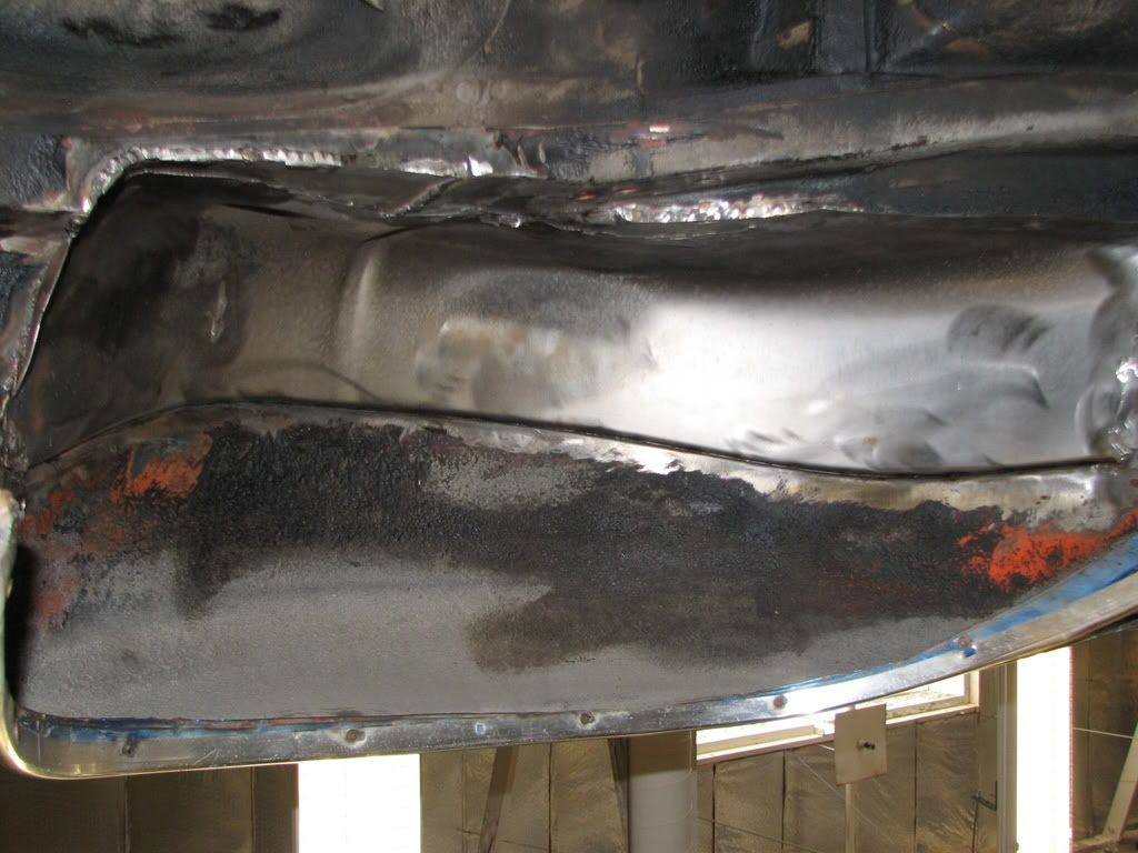

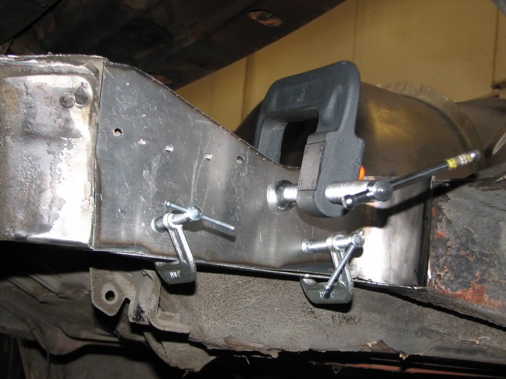

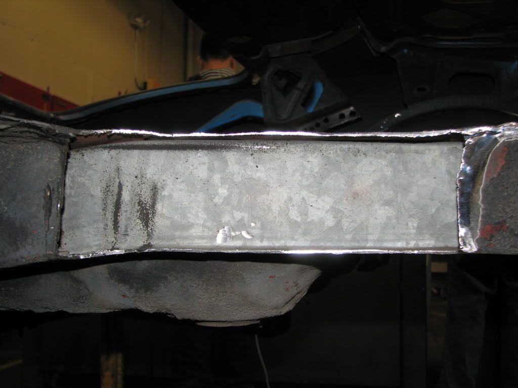

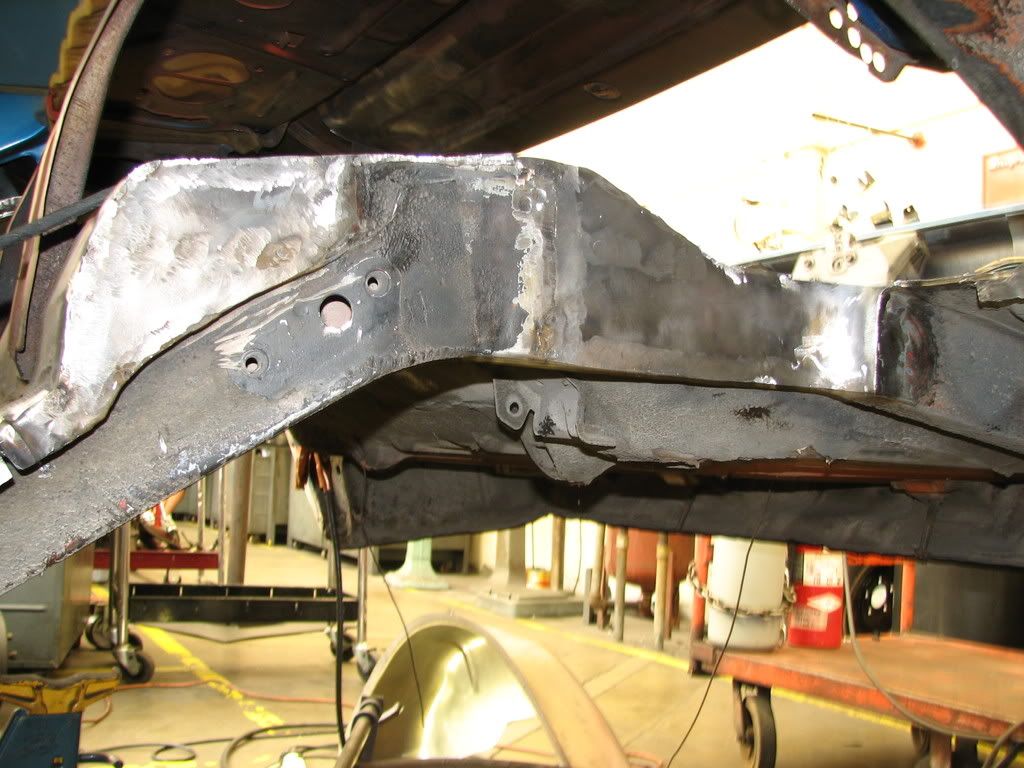

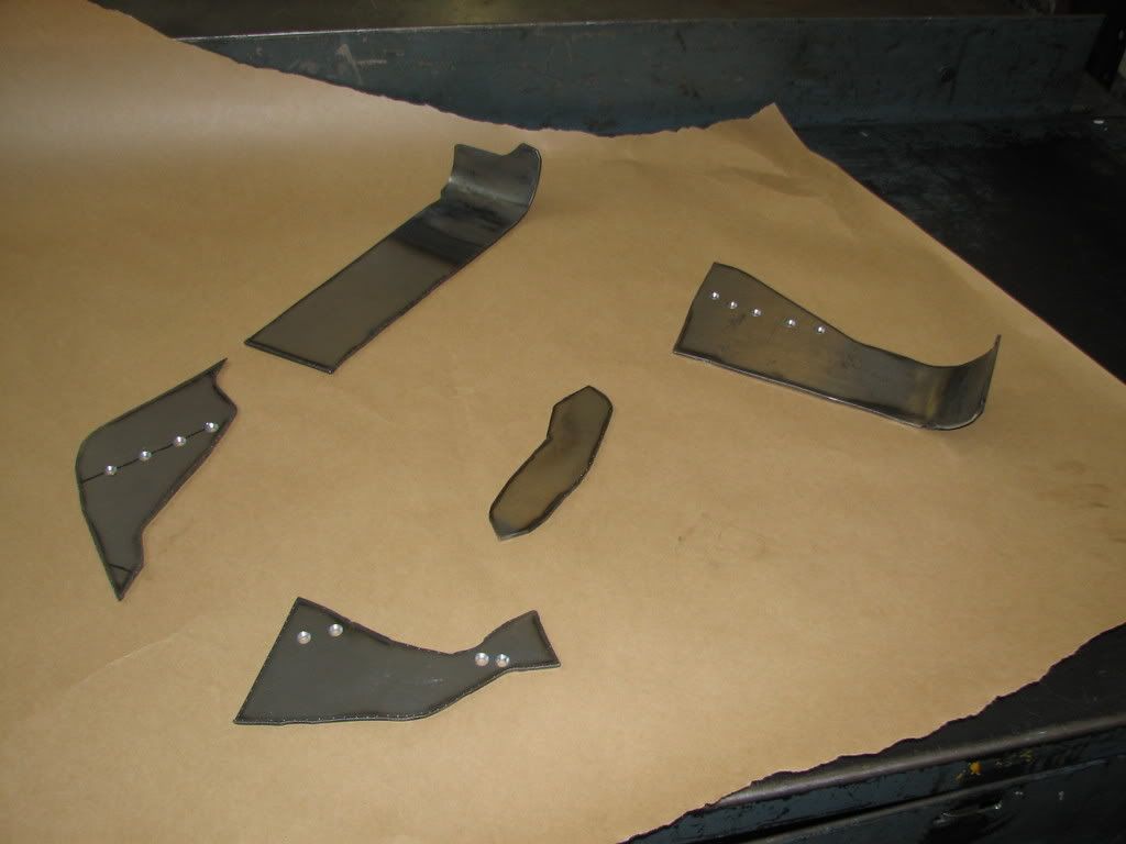

14. Now fabricate your close outs. This is where the plasma cutter or even a band saw with a metal cutting blade will really pay off. If none are available use your cut-off wheel. I drilled and counter sunk the holes for spot welding:
http://i328.photobucket.com/albums/l...iniTub041b.jpg
I also used a cutting torch (oxy acetylene) to heat up and bend the close outs to the proper radius to fit my open frame rails. It is much easier to bend 1/8" steel when it is red hot.

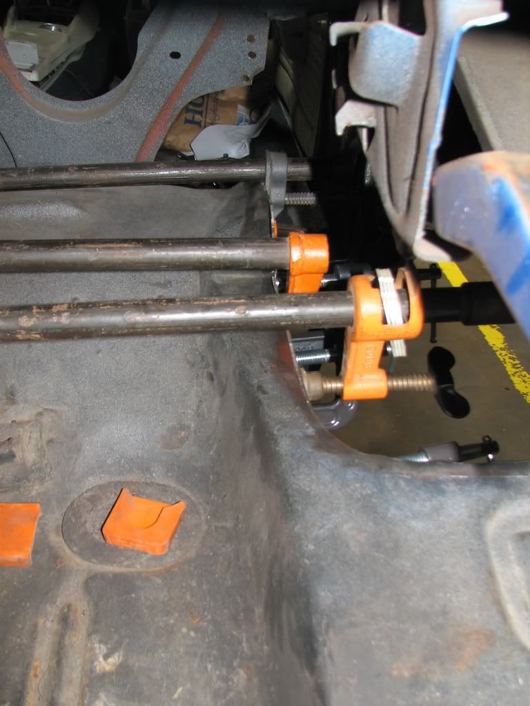

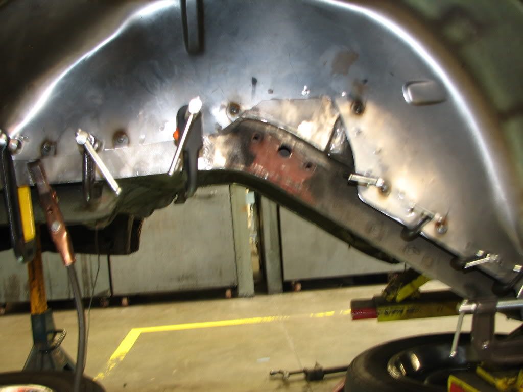

15. Now mock up the closeouts. This where the C-Clamps and Bar clamps come in really useful:
http://i328.photobucket.com/albums/l...MiniTub046.jpg
http://i328.photobucket.com/albums/l...MiniTub043.jpg
http://i328.photobucket.com/albums/l...MiniTub042.jpg
http://i328.photobucket.com/albums/l...MiniTub044.jpg
http://i328.photobucket.com/albums/l...MiniTub045.jpg
Grind flush as necessary.

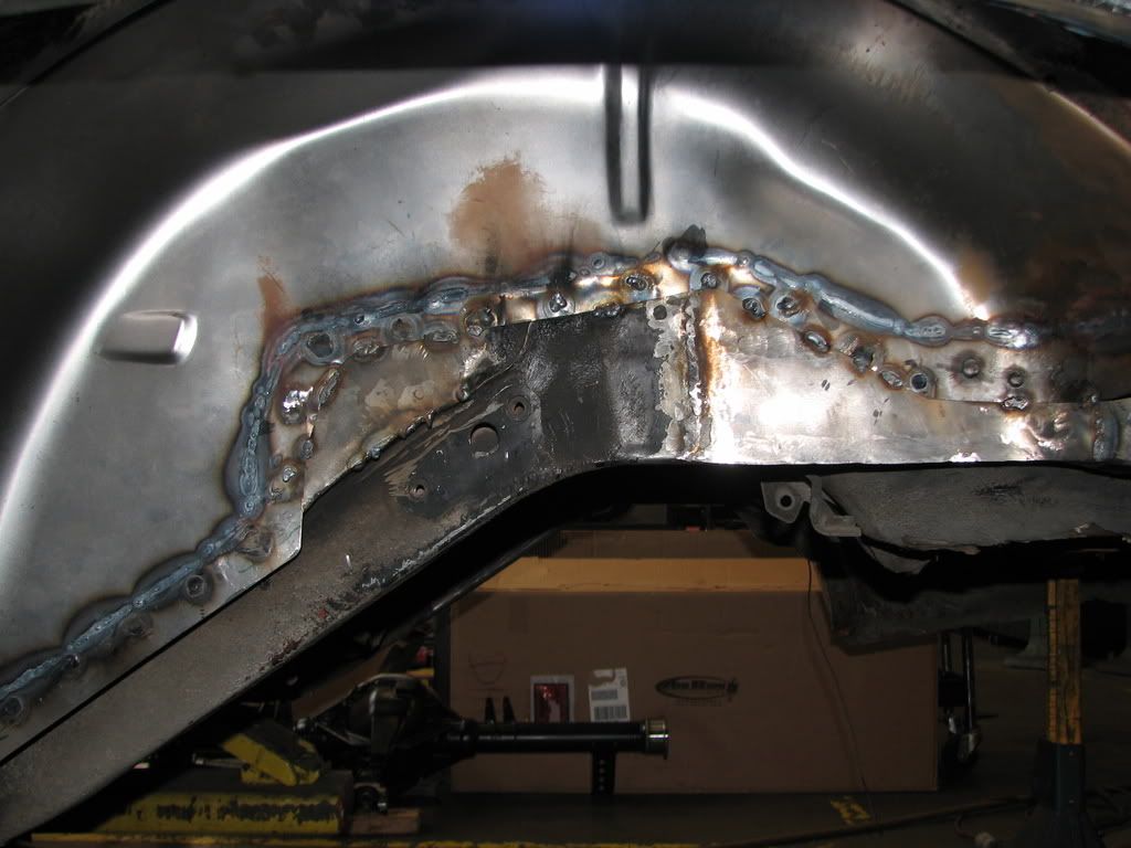

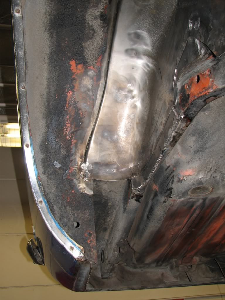

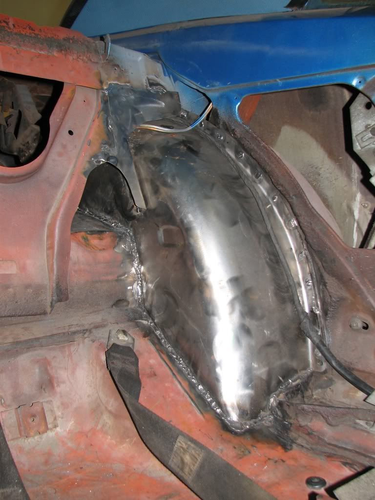

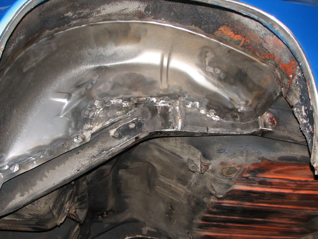

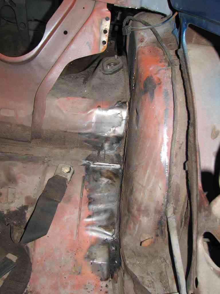

16. Now weld up the closeouts. Either do it yourself or leave that trail of mixed nuts to the six pack next to the welder for your buddy (dont WUI thou):
http://i328.photobucket.com/albums/l...MiniTub047.jpg
http://i328.photobucket.com/albums/l...MiniTub054.jpg
http://i328.photobucket.com/albums/l...MiniTub050.jpg
http://i328.photobucket.com/albums/l...MiniTub052.jpg
A comment on my welding. In the class I took I was decent at running a bead on a bench, but welding in the conditions for mini-tubbing is a complete different story. I am picky when it comes to my car and the work I do. So I had to grind down my welds a few times until I got what I considered acceptable looking welds. They still aren't what I would consider good, but this is all going to be painted anyways.

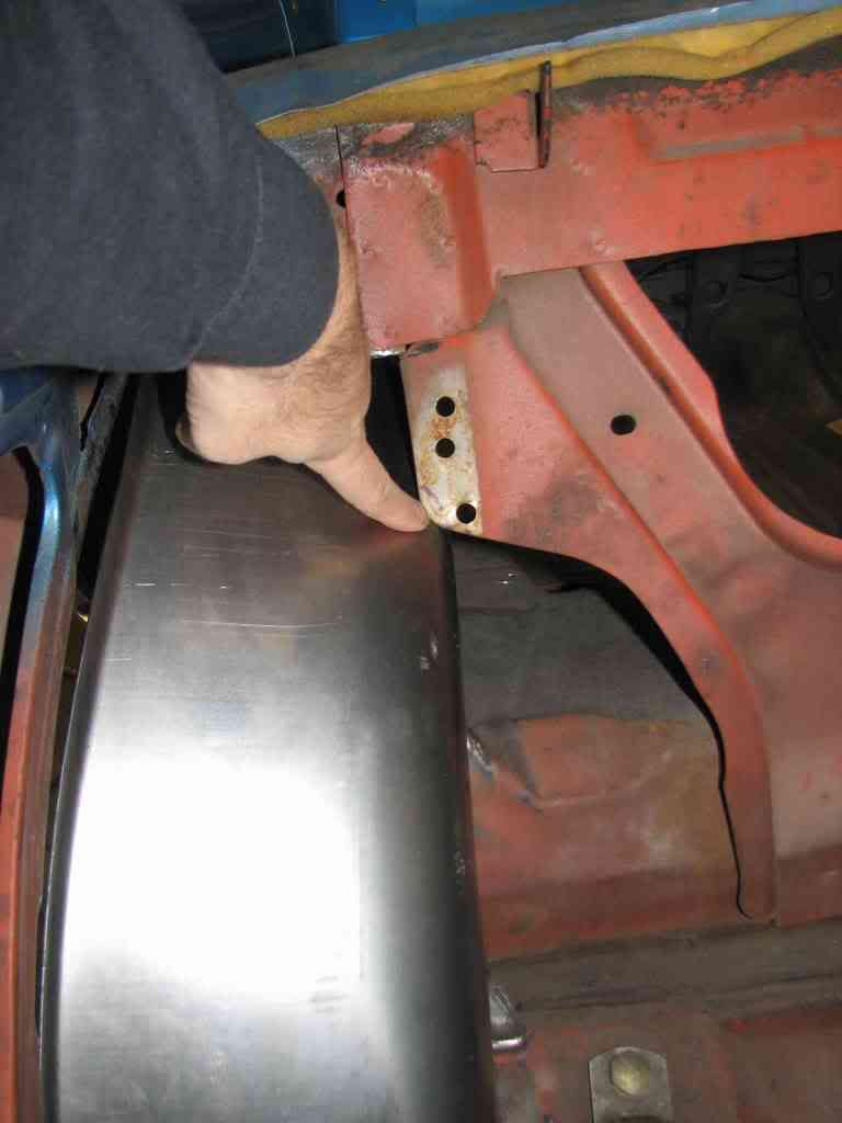

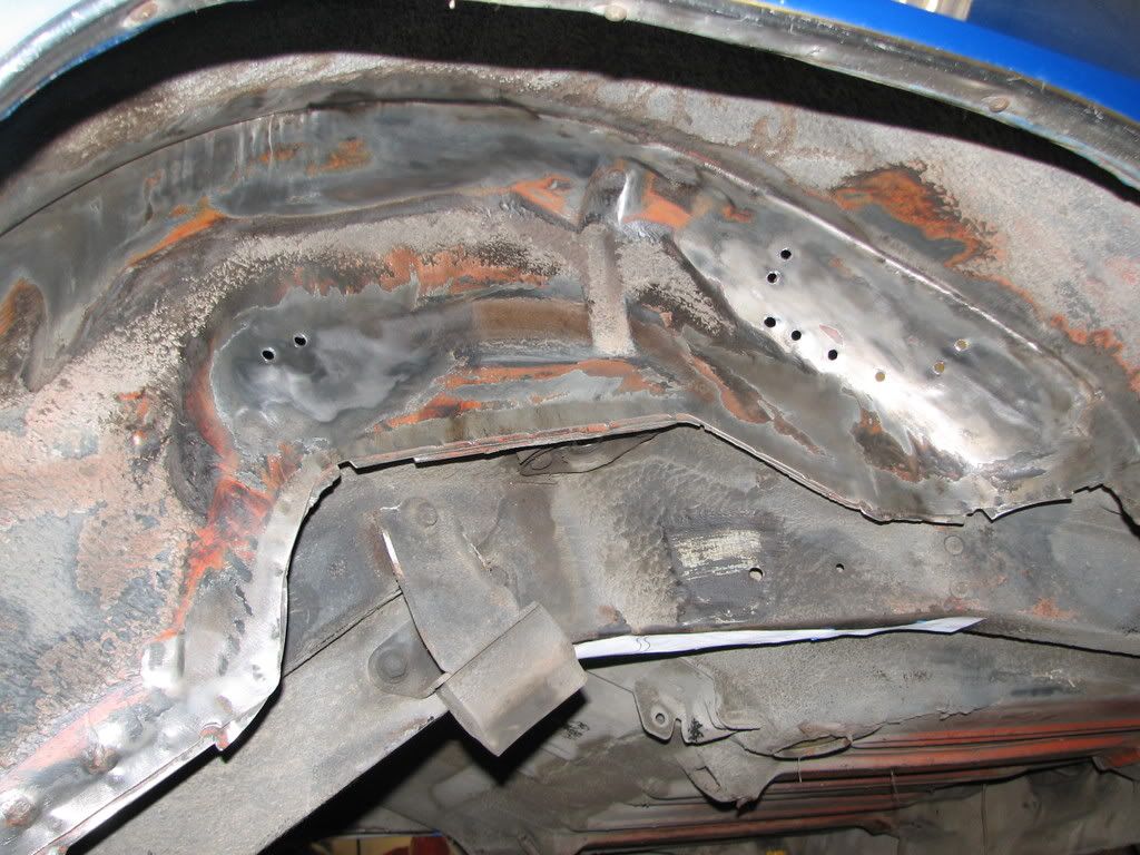

17. Now drill holes in the tubs for the spot welds. Draw the lines on the front back like in the DSE Video:
http://i328.photobucket.com/albums/l...MiniTub056.jpg
http://i328.photobucket.com/albums/l...MiniTub057.jpg

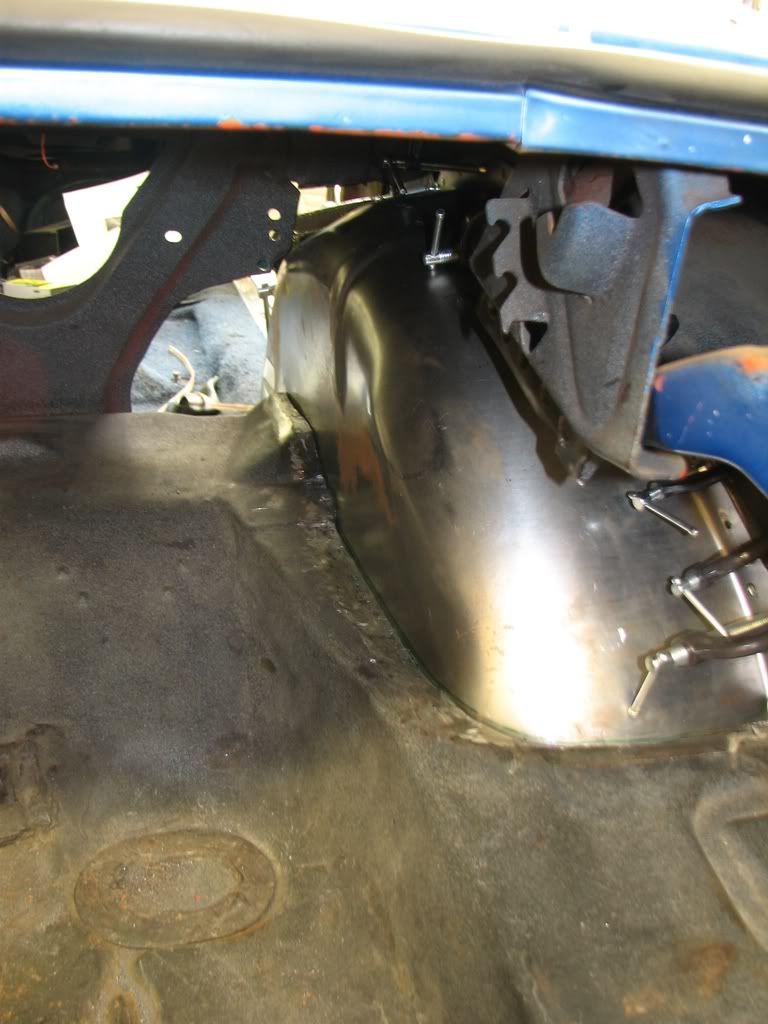

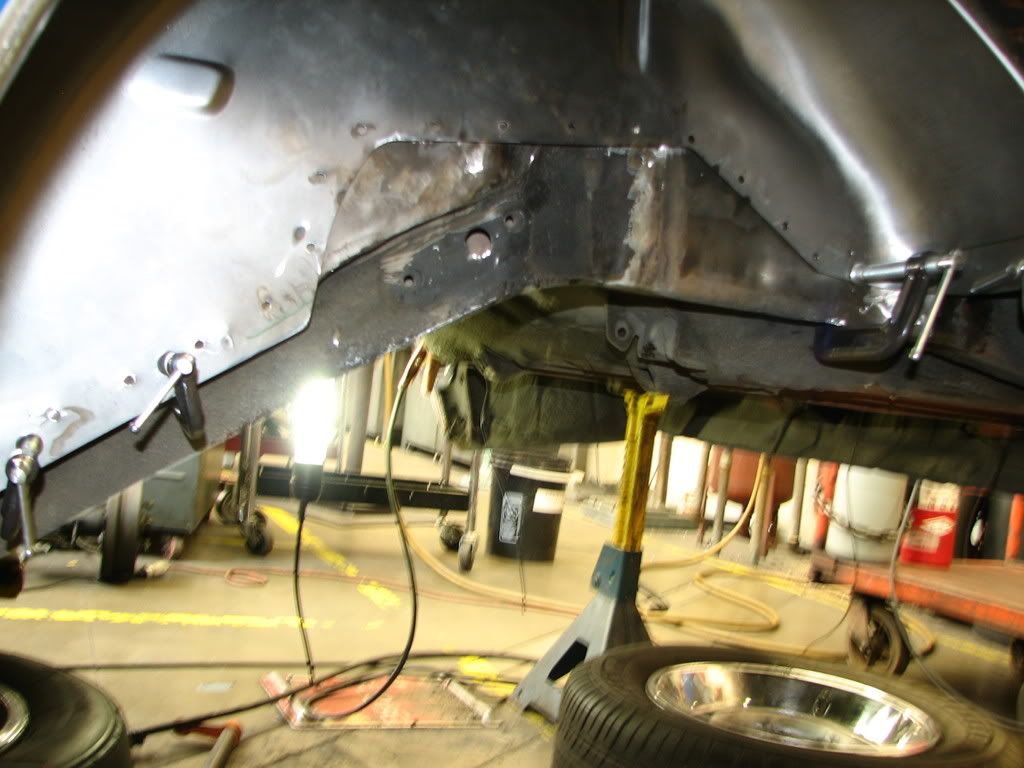

18. Mock it all up. Use the C-Clamps to get everything nice and tight. You want ZERO (0) gaps if possible:
http://i328.photobucket.com/albums/l...MiniTub058.jpg
http://i328.photobucket.com/albums/l...MiniTub059.jpg
http://i328.photobucket.com/albums/l...MiniTub061.jpg
http://i328.photobucket.com/albums/l...MiniTub062.jpg
You probably going to need a buddy help you an push down on the edges when you are ready to tack.

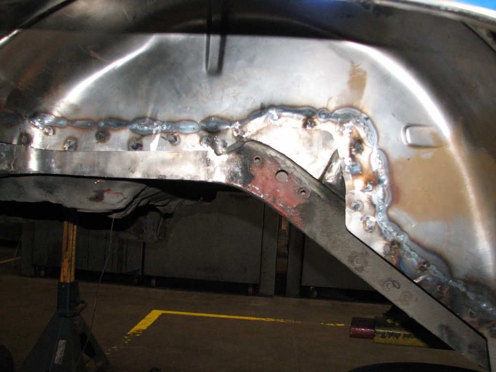

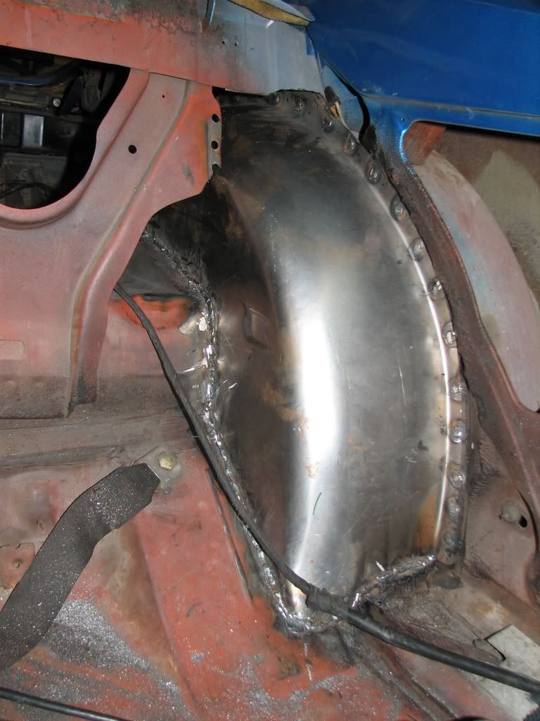

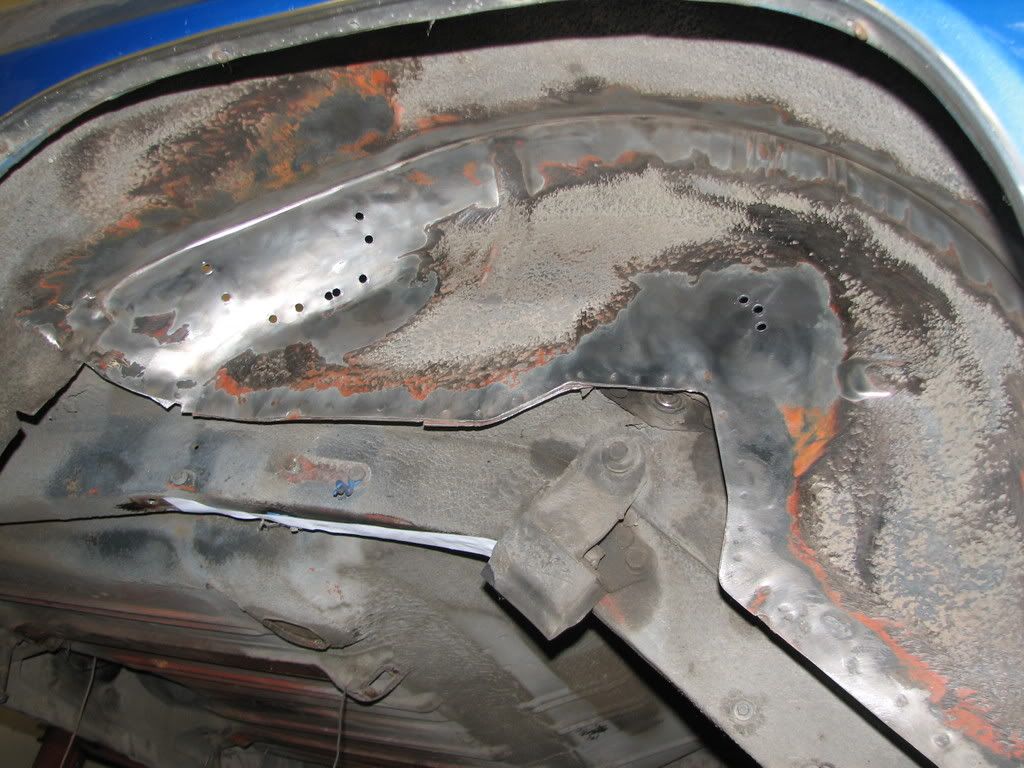

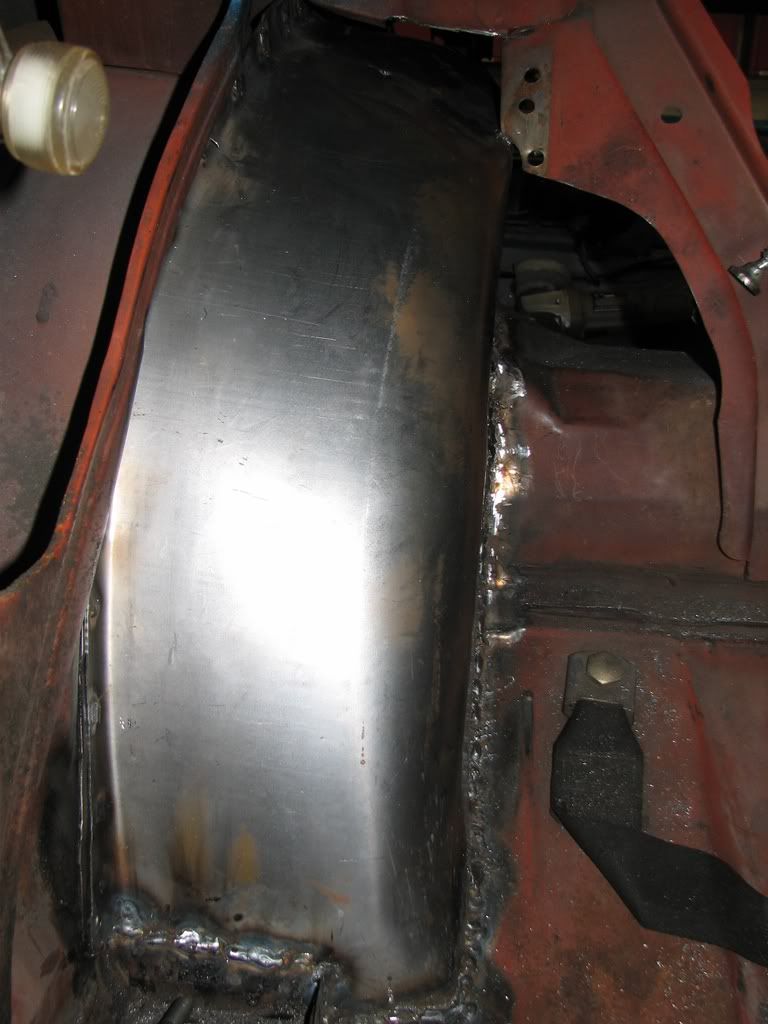

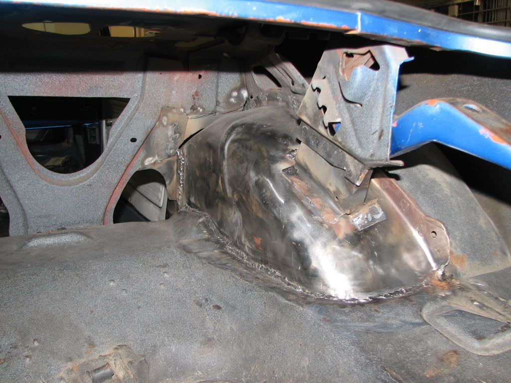

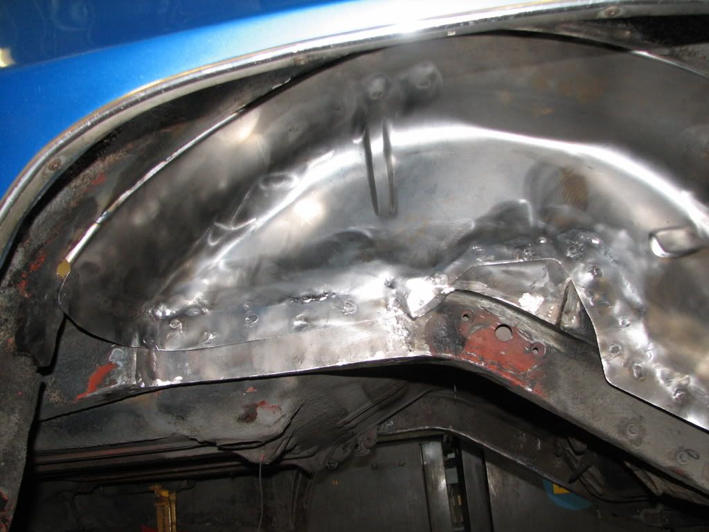

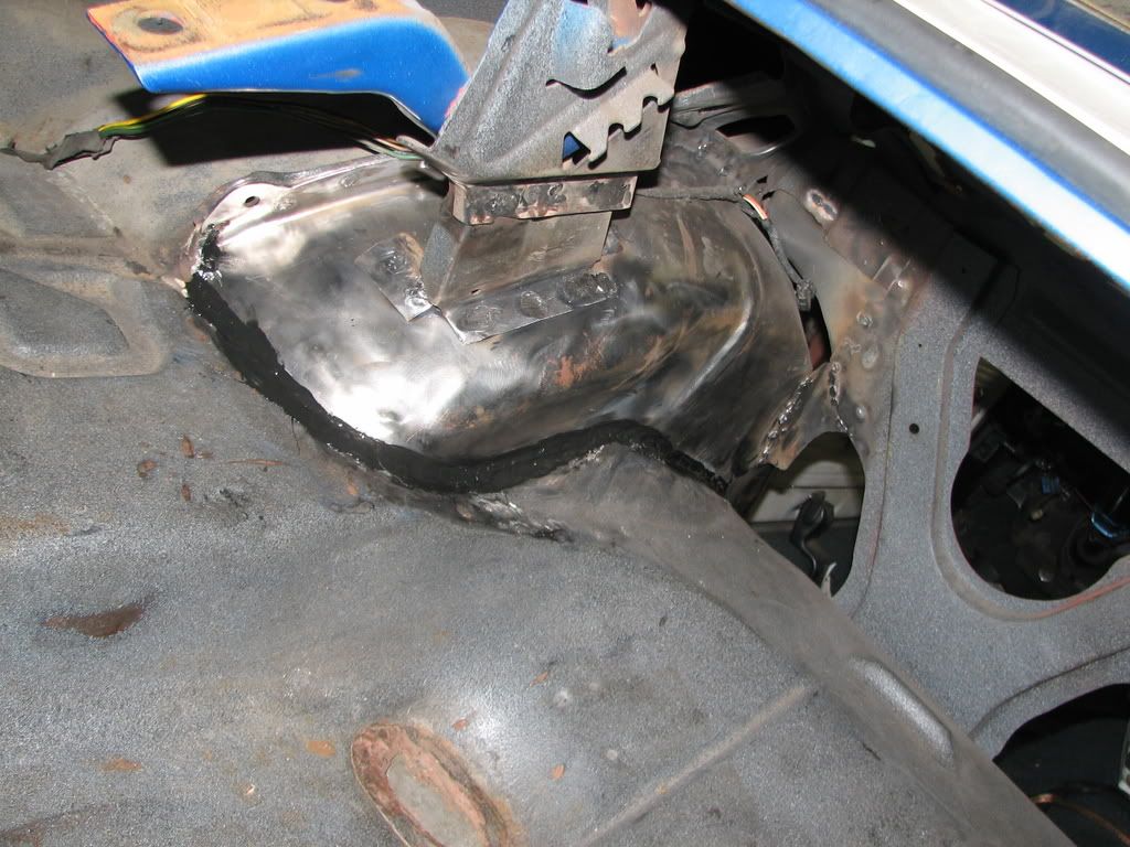

19. Buy more beer for your buddy, since it is time to weld up the inner tubs:
http://i328.photobucket.com/albums/l...MiniTub063.jpg
I welded up the inside seam between the inner tub and the trunk floor. This wasn't explict that I could tell in the video, but other installs looked like they did it this way:
http://i328.photobucket.com/albums/l...MiniTub064.jpg
http://i328.photobucket.com/albums/l...MiniTub065.jpg
http://i328.photobucket.com/albums/l...MiniTub068.jpg
http://i328.photobucket.com/albums/l...MiniTub069.jpg
http://i328.photobucket.com/albums/l...MiniTub070.jpg
http://i328.photobucket.com/albums/l...MiniTub071.jpg
After grinding a bit and cleaning up with a wire cupped brush on a grinder:
http://i328.photobucket.com/albums/l...MiniTub074.jpg

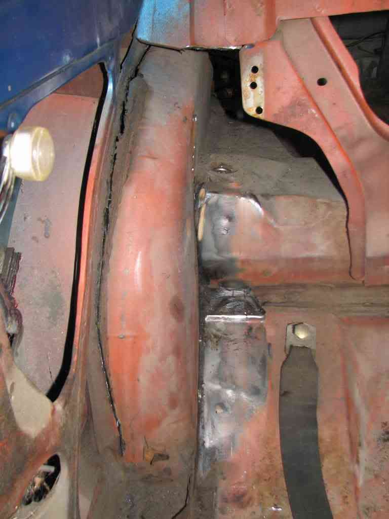

20. Now take the old deck lid braces and shorten them (I had pictures but somehow got misplaced). You are going ot need to do some custom fitment to make them just long enough to reach but not too long so that you can get them flush and get a good weld:
http://i328.photobucket.com/albums/l...MiniTub079.jpg
http://i328.photobucket.com/albums/l...MiniTub080.jpg
BBC69Camaro 04-20-2009 09:09 AM
21. Time for welding in the rear seat braces:
http://i328.photobucket.com/albums/l...MiniTub082.jpg
http://i328.photobucket.com/albums/l...MiniTub083.jpg

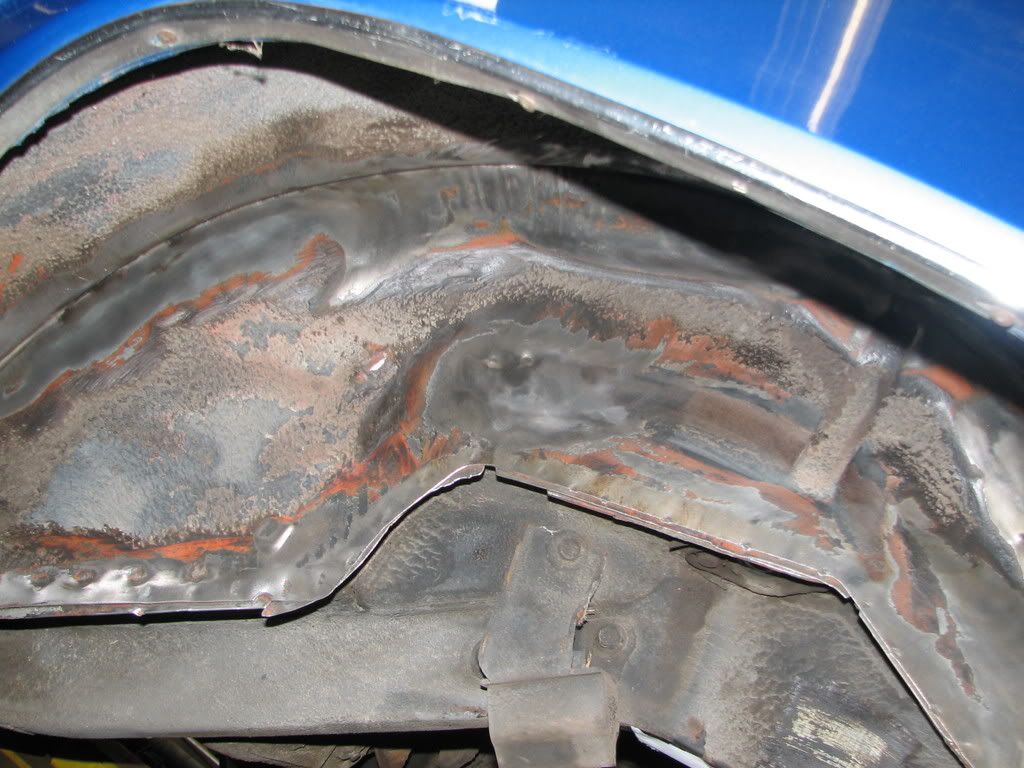

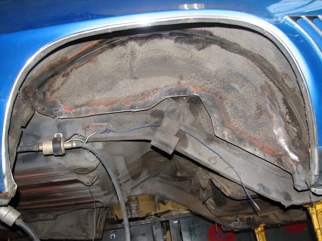

22. Grind down all spot welds and clean them up with a wire-wheel. You will probably find some spots that need more welding like I did, fix those spots as you find them. Pretty much everything should be welded now and should look nice and tight:
http://i328.photobucket.com/albums/l...MiniTub085.jpg
http://i328.photobucket.com/albums/l...MiniTub086.jpg
http://i328.photobucket.com/albums/l...MiniTub089.jpg
23. Seam sealing, one of the most important steps (least if you care about rust):
http://i328.photobucket.com/albums/l...MiniTub101.jpg
http://i328.photobucket.com/albums/l...MiniTub103.jpg
I used Eastwood's Seam sealer.

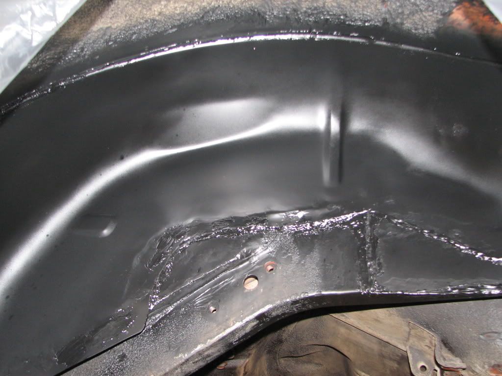

24. Prime and Paint, I used Eastwoods Extreme Chassis black and primer on the tubs:
http://i328.photobucket.com/albums/l...MiniTub116.jpg
You probably want to consider what you want to do for undercoating to protect them. I went with Lizardskin soundproofing formula and their ceramic heat insulation formula:
before:
after:
http://i328.photobucket.com/albums/l...ardSkin026.jpg
It dries a medium grey but really darkens over the course of about a week to dark grey.
I cleaned the entire undercarriage as well and painted it too (might as well make everything match). In person it looks pretty close to a factory finish. It isn't perfect by any means but my goal was a stock look and I think I succeeded. I may paint the underside with my leftover chassis black paint not sure, want to see how much it will darken (right now putting in rear suspension going to need to weld in the G-Bar frame anyways so more painting will happen after).
