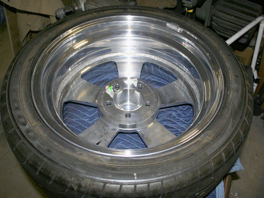

So then there is the CPP 13" setup. They use a full cast iron disc too and some cadillac escalade calipers ( as far as I have come up with, not for certain, CPP?) What I really like is the ability to use off the shelf pads when its time to change. But after checking the diameter its giving me .001" of clearance to remove the wheel. I have billet specialties 17" wheels and the center rib (two inches wide is all) on the wheel is 15". It opens up past that rib so the wheel wouldnt be spinning that close. But I dont think I can get my wheel over the caliper.

Hi Tobin. Yup, got it in my grubby lil hand. Actually it was the first one I checked out. What kills the deal is the same with the CPP brakes. The 7.74" from the center to the top of the caliper. 15.48" is .48" TOO much. Damn.. My Billet Specialties wheels have a rib that sticks out some and only allows a 15" clearance. Thanks though.
http://img.photobucket.com/albums/v3...ackofwheel.jpg
