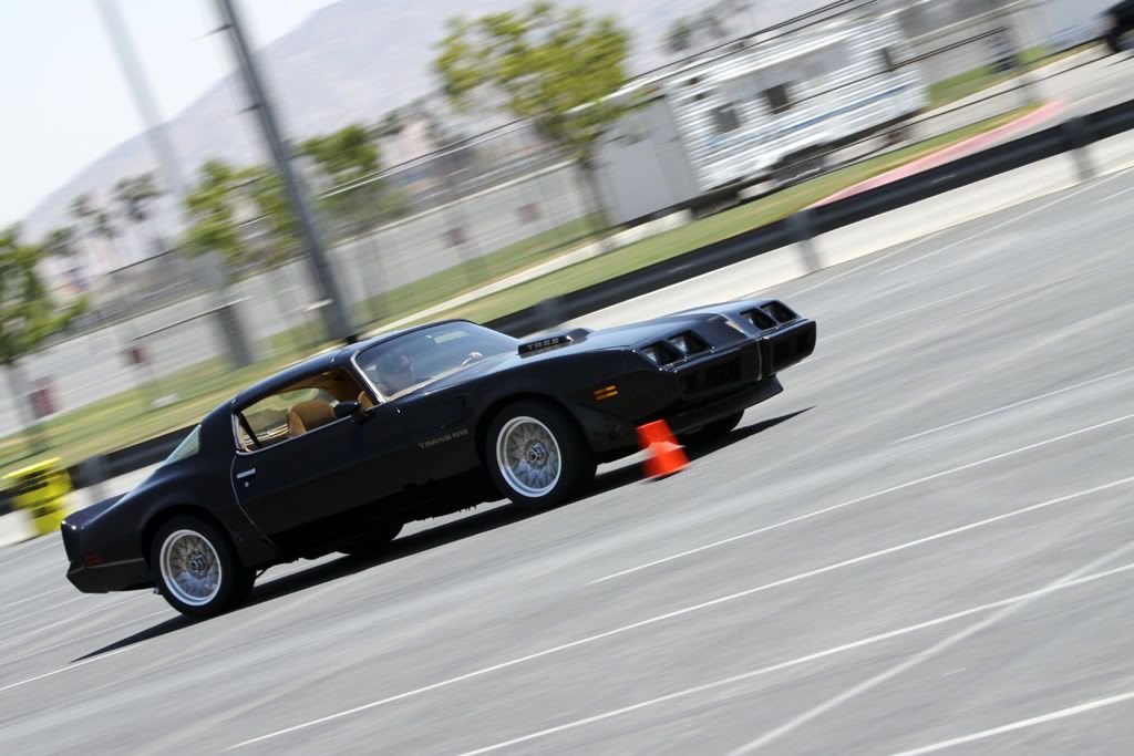

In fact, we just finished track testing a new system for the late 2nd gen Camaros Firebirds last week and the performance was incredible. We'll have video of that test soon, here's a shot in the meantime:
http://i22.photobucket.com/albums/b3.../Fontana03.jpg

Mary is running front and rear springs, subframe connectors, front and rear sway bars and a few home-brewed mods that she and her husband David have cooked up. However the '80 T/A in that picture was a totally stock old Pontiac before we installed the complete TVS plus upper and lower A-Arms and Subframe connectors and it ran nearly as fast through the slalom as my personal '99 Z28 SS with sticky tires. Check it out:
