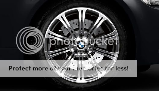

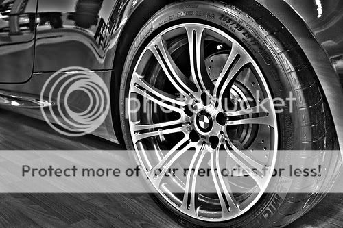

Euro wheels
That's what I was thinking. I'm actually considering taking the wheels off my M3 and putting them on my Camaro. I know the rears are 19x9.5. I need to double check the offset, but again, I'm building this from the ground up so I can do whatever I want at this point. Any other opinions out there? I was also thinking of some other exotics (IE) Lambo, Ferrari, etc.
I'm sure someone out there has already done this.
Here are a few different pics of the M3 wheels
http://i543.photobucket.com/albums/g.../BMWwheel2.jpg
http://i543.photobucket.com/albums/g...s/BMWwheel.jpg
Rhino 05-19-2009 08:05 AM
I'm pretty sure the Murcielago and some Diablos are 5x120, but I believe the center bore is larger requiring the use of a hub centric spacer. Newer models step up to 135mm. I have no idea about offset, but remember some of them being at 0mm.
Ferrari's I'm not so sure about, but thought they were a little smaller.
If you're looking at wheels off of higher end exotics, you're obviously not too worried about cost. Why not go with a set of one offs with a really high backspacing. Most modern wheel companies can do them with a very small lip if that's what you're looking for. This way you'll also have the correct bolt pattern and not have to use a spacer.
