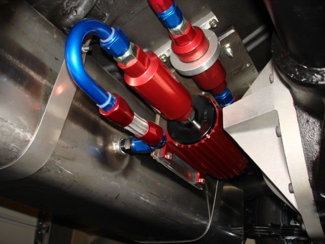

67ragtp 05-25-2009 06:02 PM
http://i168.photobucket.com/albums/u...Picture073.jpgThe small piece feeding the pump is #10 into a 100micron/10 micron out and #10 all the way to the "Y" under the hood then #6 coming out of the "Y" feeding the rails and # 6 going into the regulator. The return coming out of the regulator is #6 for 30 inches(just behind the upper control arm) then increases to #8 braided line all the way back to the tank. A-1000 pump.

I think I might be chasing it down, the 10 micron filter didn't look to bad although it was a bit dark, so I figured let me replace it today. I think the pump is flowing a bit better. When I snap the throttle now it goes right up to 45 psi from 40 at idle with the vacuum line connected, but the the second the throttle blades shut it dips down to 36 and settles at 40. Im starting to wonder now if the pump is taking a dump. what do you think?
