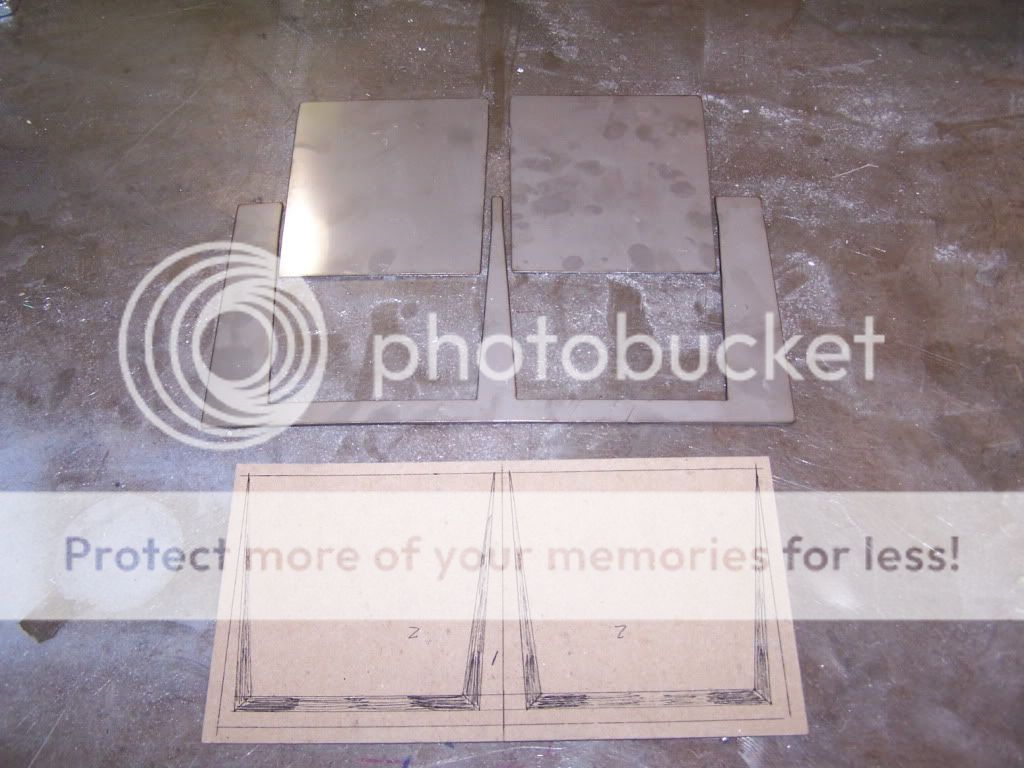

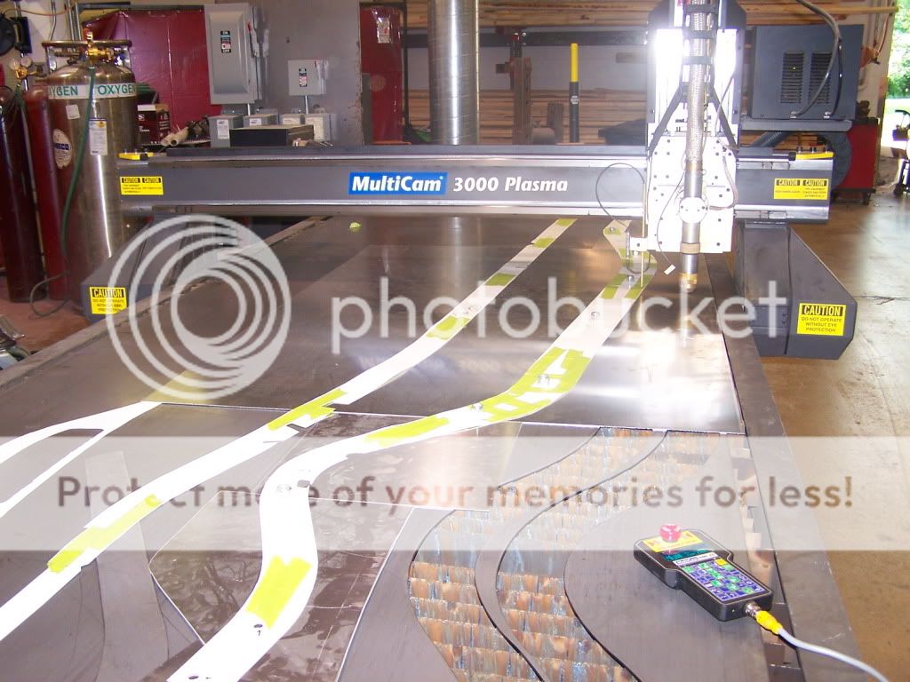

Scanning paper frame rail templates into the computer system with the optical tracer on the plasma table
http://i563.photobucket.com/albums/ss79/RS-Perf/4.jpg

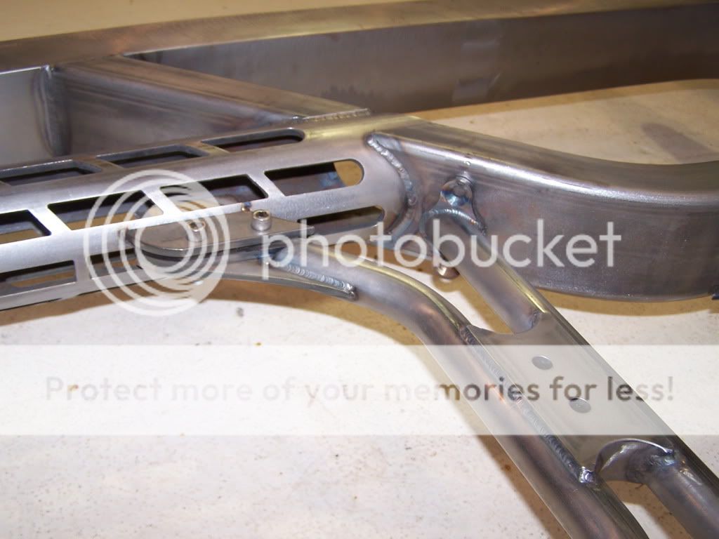

Set of completed frame rails
http://i563.photobucket.com/albums/ss79/RS-Perf/5.jpg

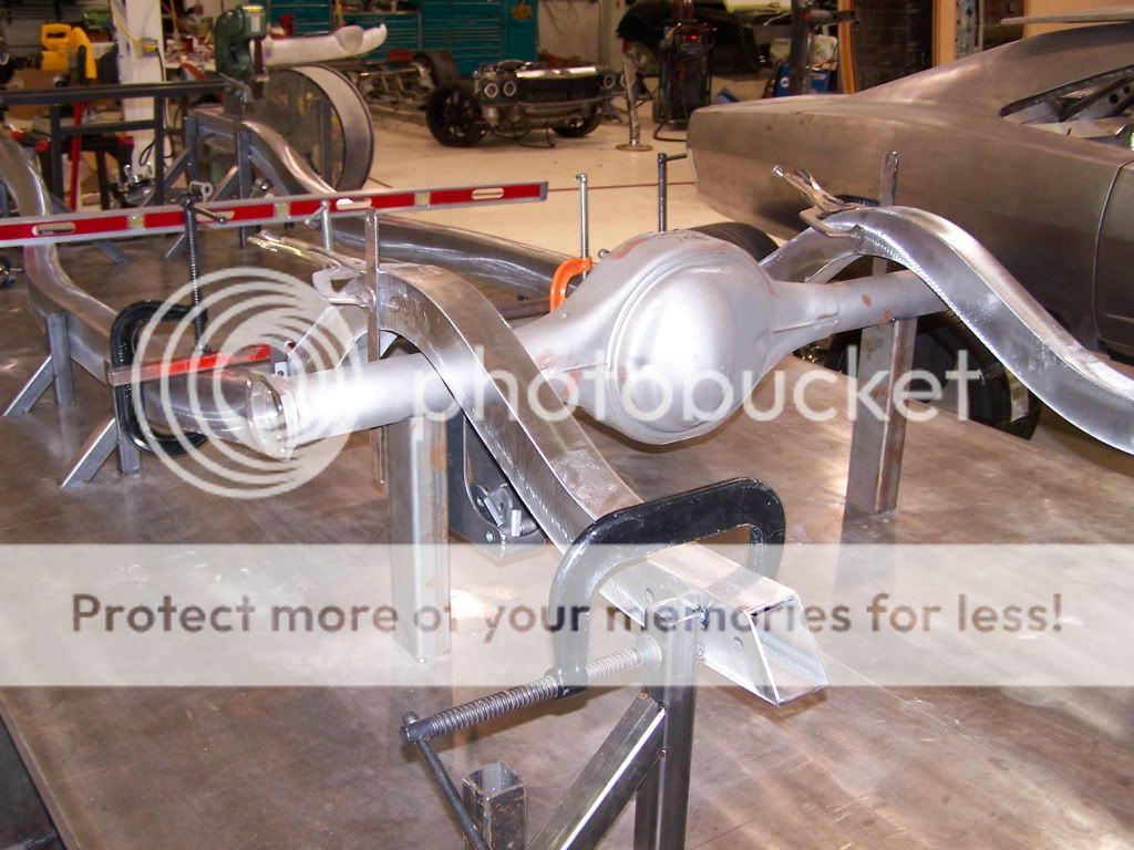

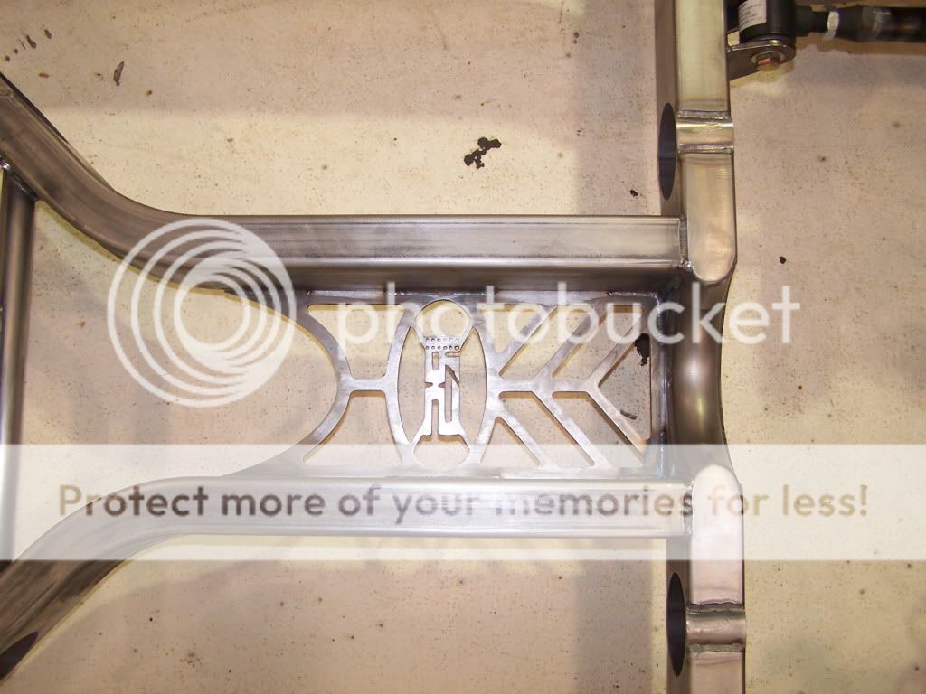

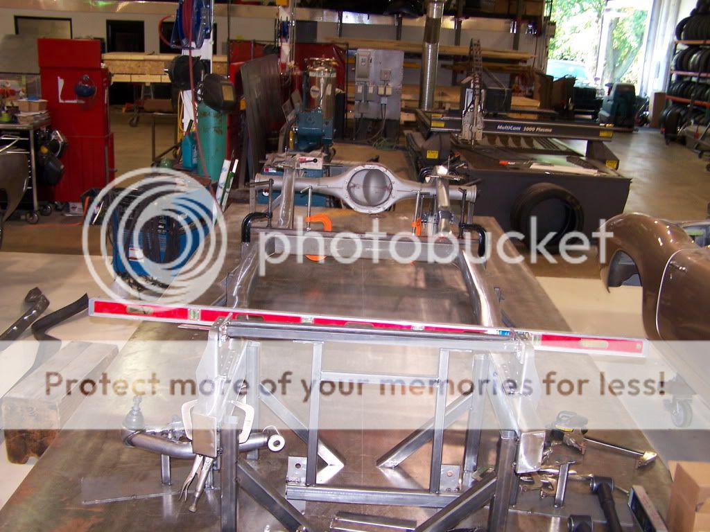

Early stages of fixturing frame rails and designing crossmembers and suspension mounting points
http://i563.photobucket.com/albums/ss79/RS-Perf/6.jpg
http://i563.photobucket.com/albums/ss79/RS-Perf/7.jpg

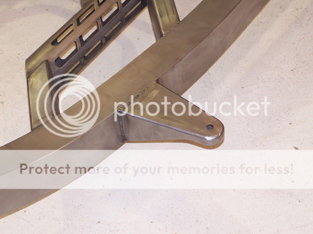

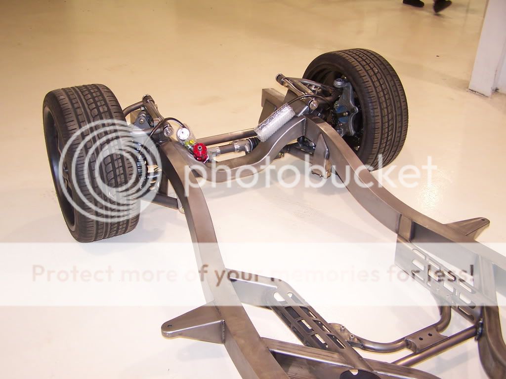

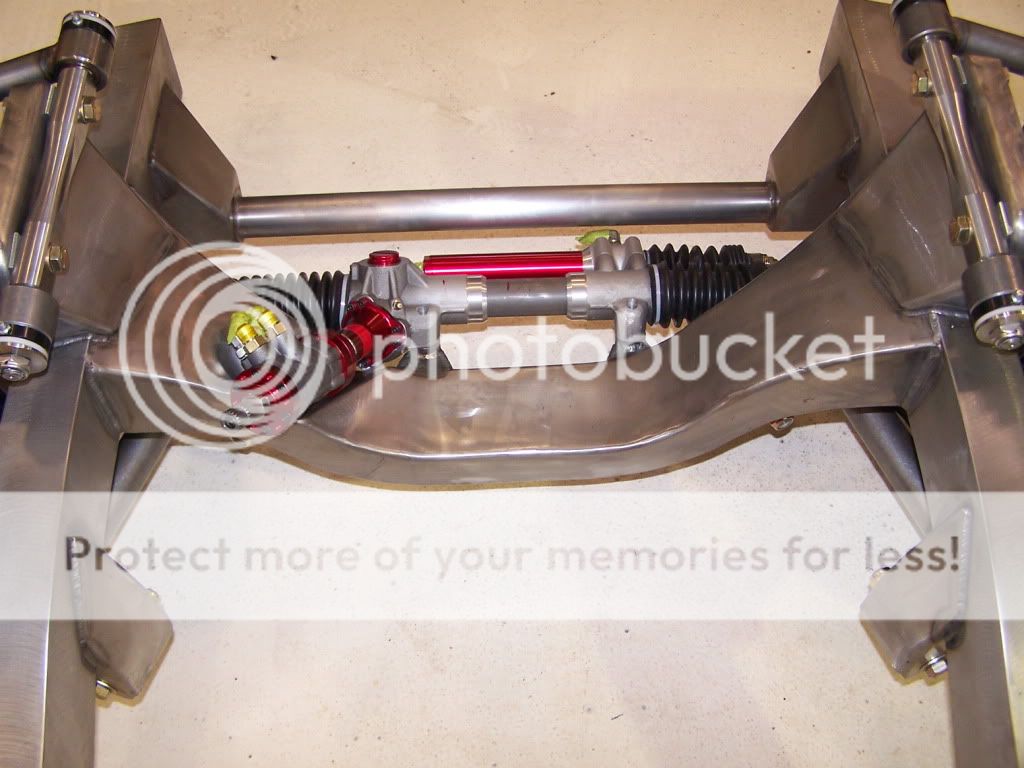

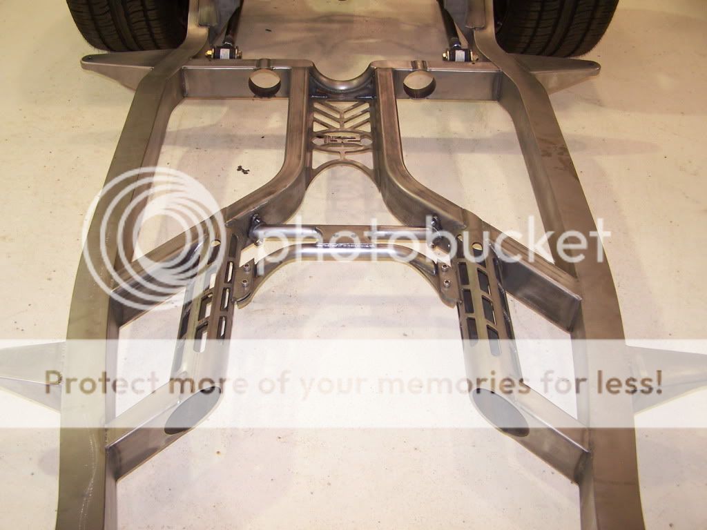

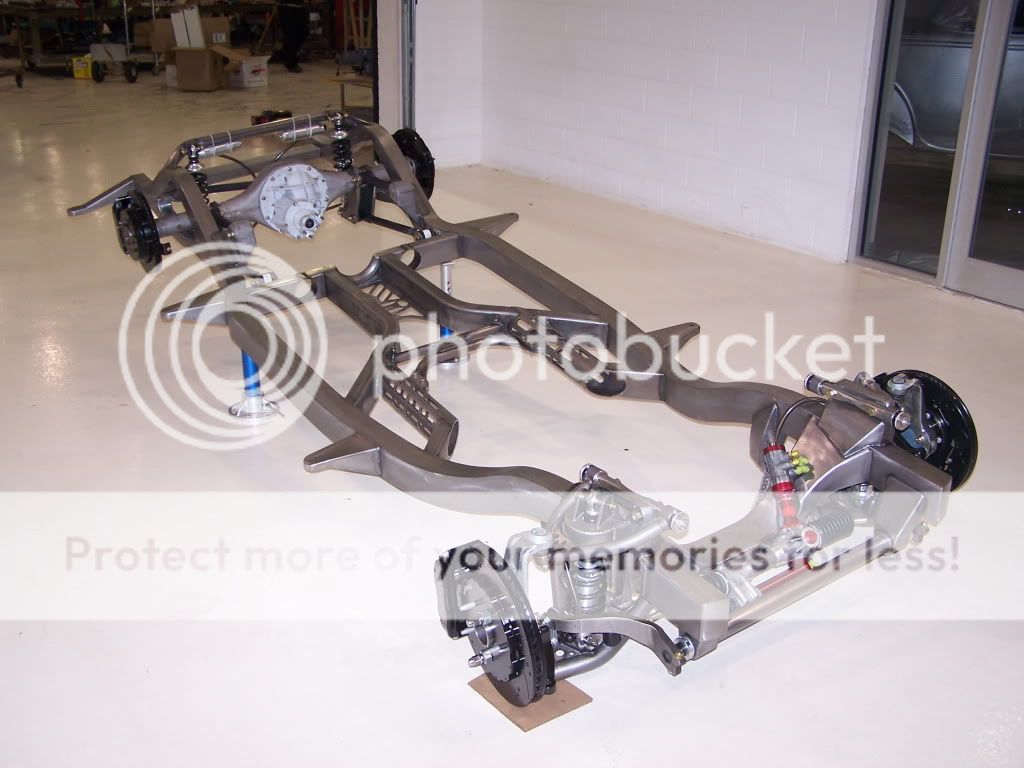

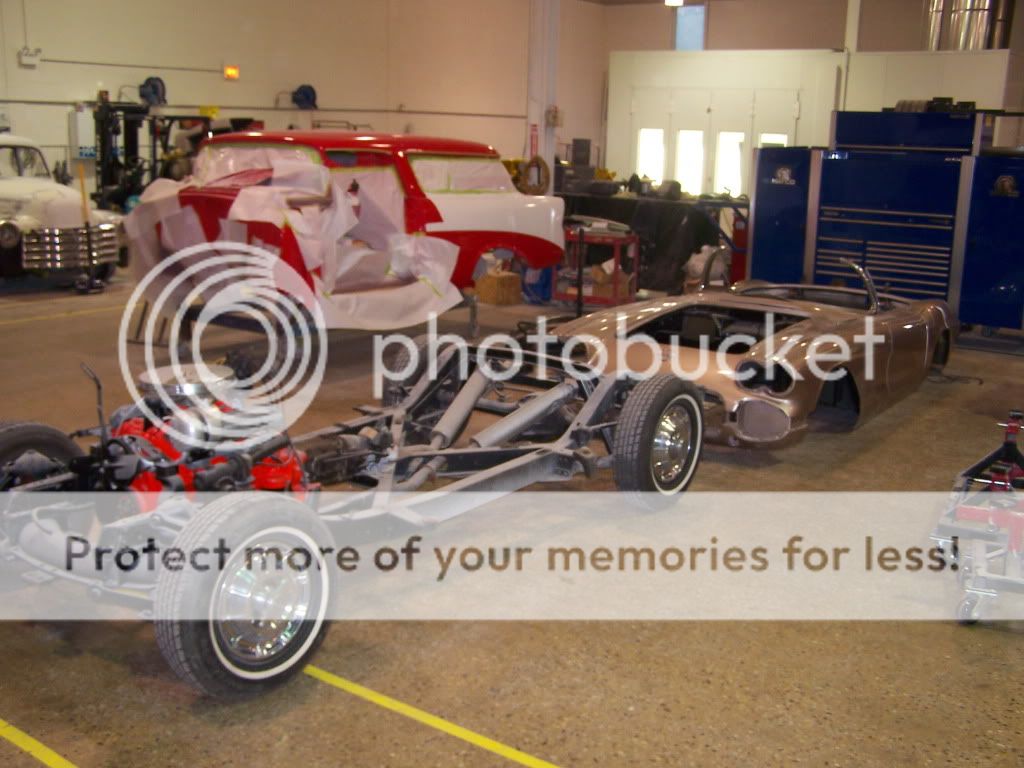

Roadster Shop 06-09-2009 06:09 PM

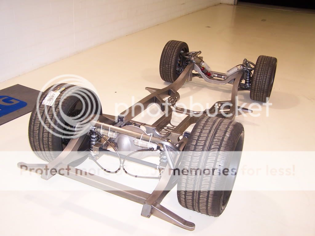

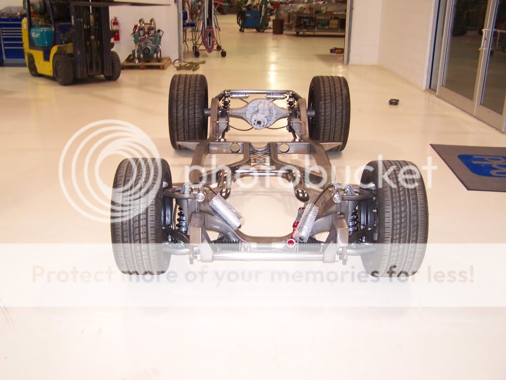

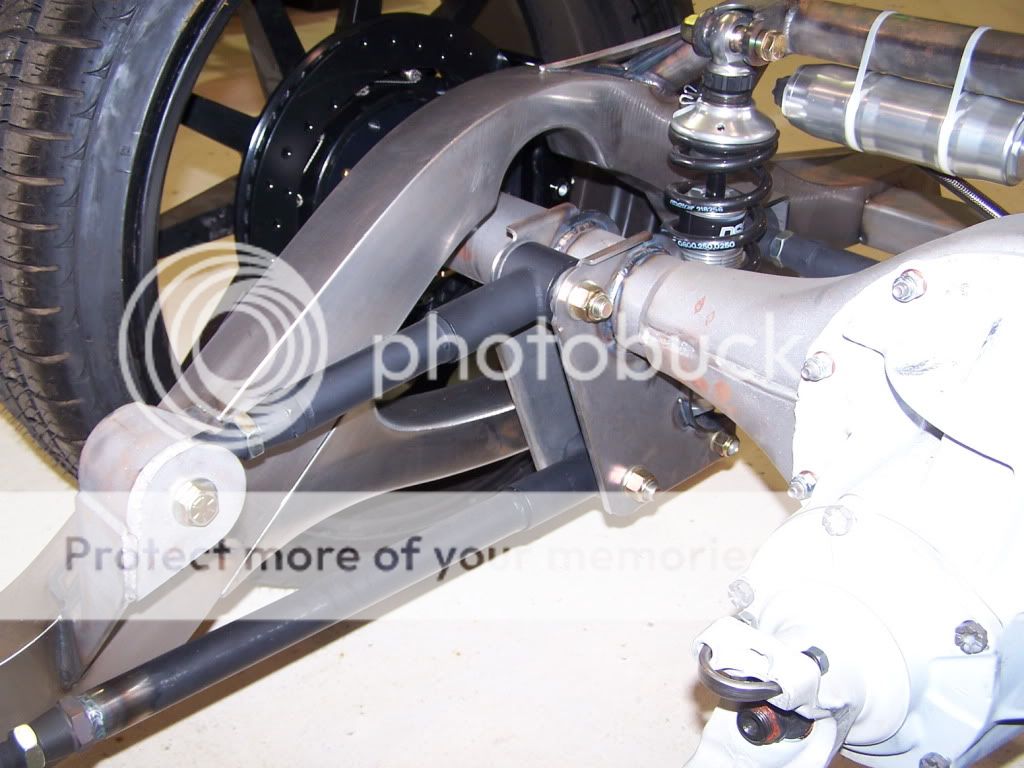

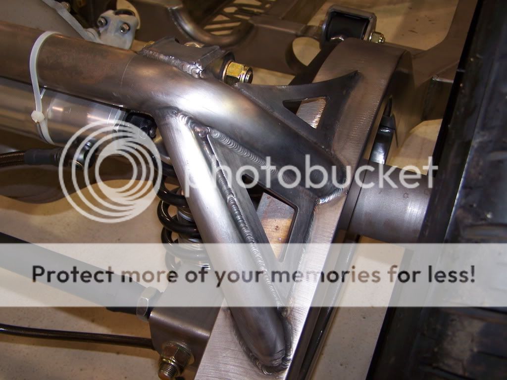

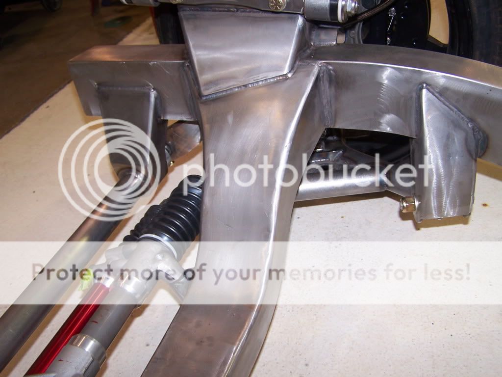

Here is the completed chassis. (Brakes have been changed later in the build)
http://i563.photobucket.com/albums/ss79/RS-Perf/8.jpg
http://i563.photobucket.com/albums/ss79/RS-Perf/9.jpg
http://i563.photobucket.com/albums/ss79/RS-Perf/10.jpg
http://i563.photobucket.com/albums/ss79/RS-Perf/12.jpg
http://i563.photobucket.com/albums/ss79/RS-Perf/13.jpg
http://i563.photobucket.com/albums/ss79/RS-Perf/14.jpg

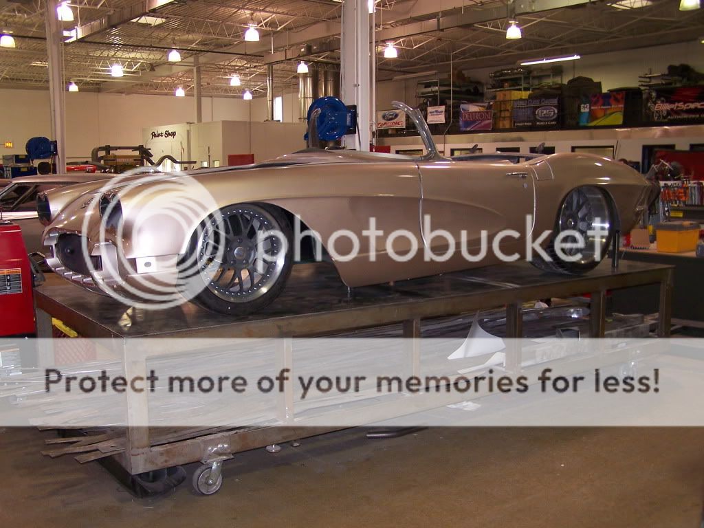

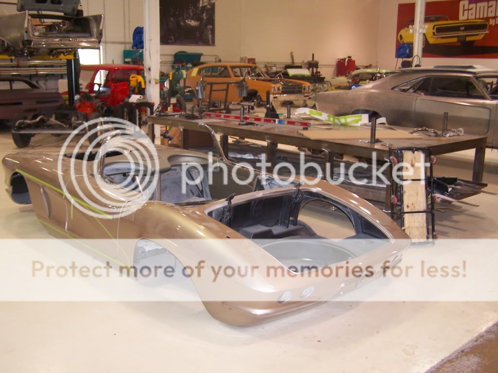

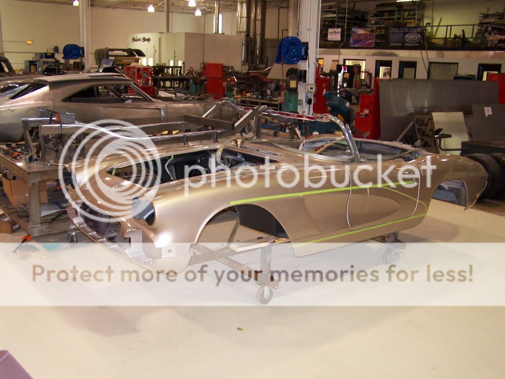

Roadster Shop 06-09-2009 06:16 PM
Rough mock up to determine ride height and stance
http://i563.photobucket.com/albums/ss79/RS-Perf/24.jpg
Body sitting on the chassis table to determine the ride height before the chassis was built.
http://i563.photobucket.com/albums/ss79/RS-Perf/25.jpg

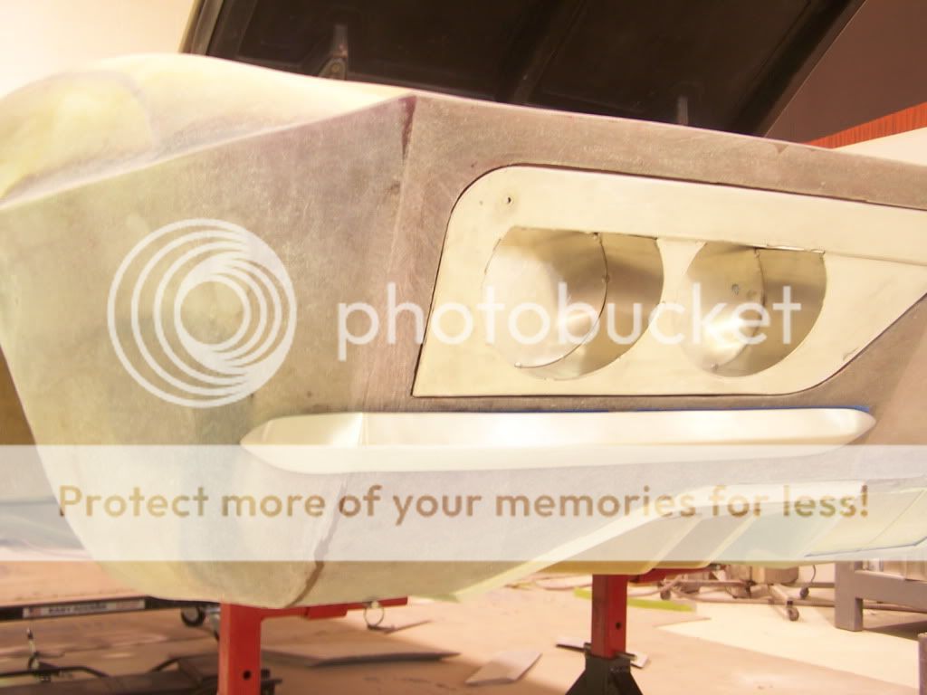

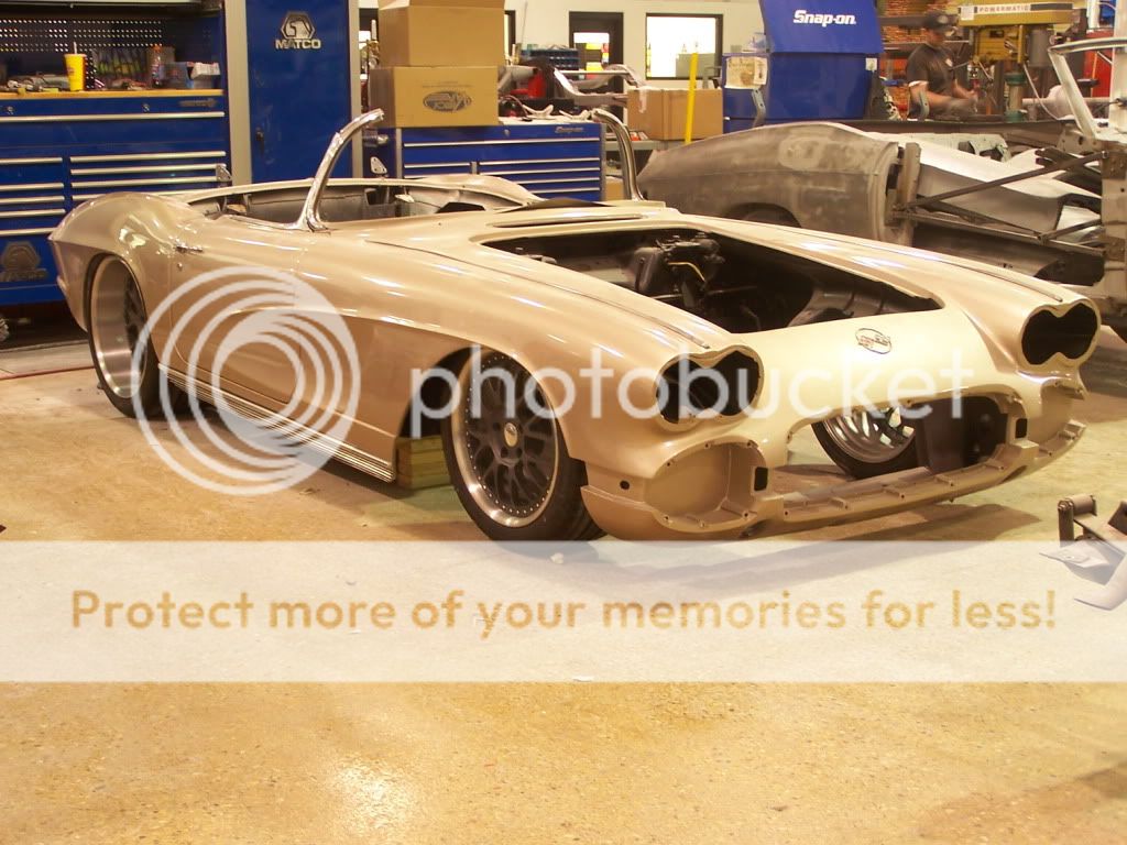

Clay mock up, begining to lay out the new rear body line off the wheel opening.
http://i563.photobucket.com/albums/ss79/RS-Perf/27.jpg

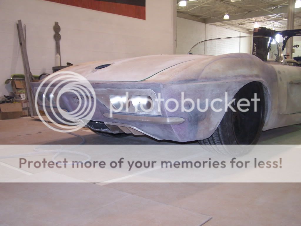

A little further along in the sculpting process. The stock bumper recesses, tail light holes, and license plate have been filled in fiberglass to completely redesign the rear of the car. The rear corners have been brought out and sharpened for a mroe aggressive look. We have also wrapped the line off the rear wheel opening into a rear spoiler.
http://i563.photobucket.com/albums/ss79/RS-Perf/28.jpg
