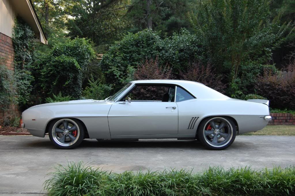

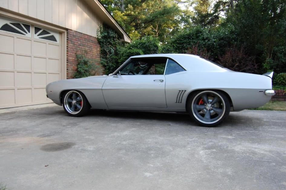

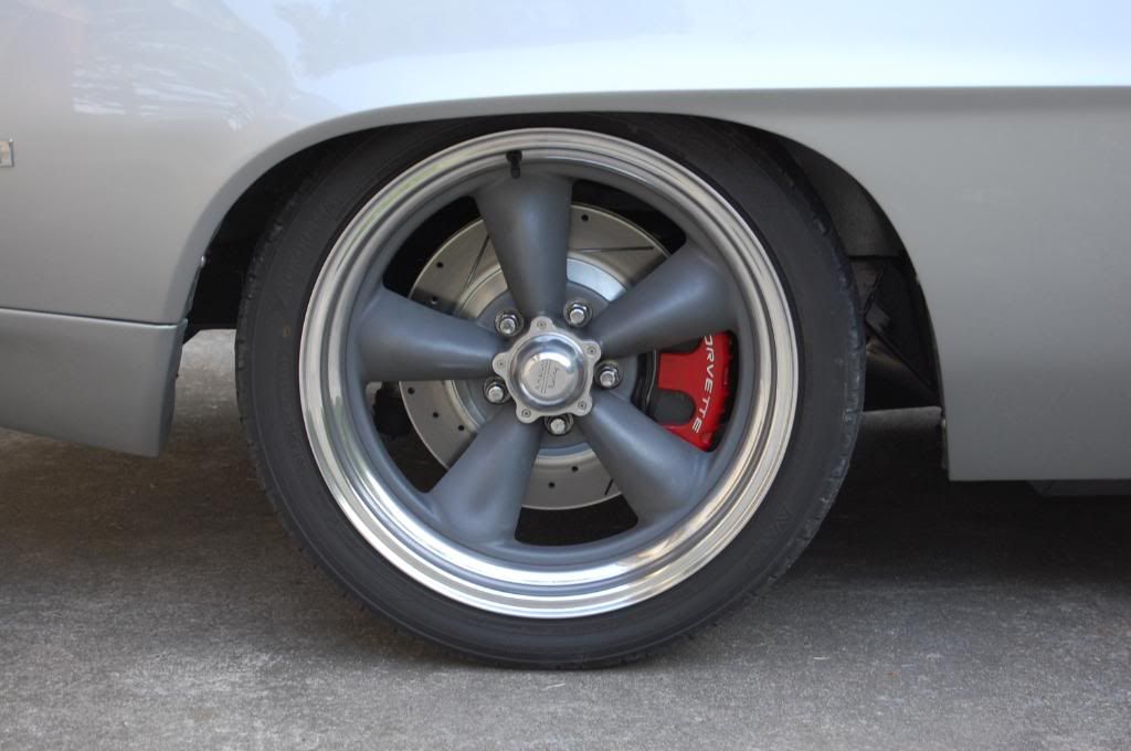

I got around to upgrading the brakes on my 69... I had C5 on the front and 97 model Camaro calipers on the rear. I was never really happy with the look so I gave Tobin at KORE3 a call and he sent me these. http://i235.photobucket.com/albums/e...1/DSC_0594.jpg http://i235.photobucket.com/albums/e...1/DSC_0595.jpg http://i235.photobucket.com/albums/e...1/DSC_0592.jpg

i cant seem to put my finger on what you exact setup is just by the pics,im guessing its either a z51 size rotor in the front or a hybrid kit but in the rear that looks like a front caliper. could you tell me what exactly your running? looks great! also are you rear wheels custom widened or some thing cause they dont look to be step lips like the fronts in those pics.

Yes its a hybrid kit, I made the brackets to adapt the C5 calipers to the C4 spindels... and on the rear I cut the brackets I got from Baer and modified them to accept a C5 front caliper. It was a pretty easy mod with a little 1/4'' plate and a piece of 3/8'' for the front. The wheels...Yeah they have been played to death, but you cant beat them on a budget. They are a 20x10 reverse hoop and 3.75 backspacing. Thanks for the compliments
