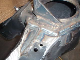

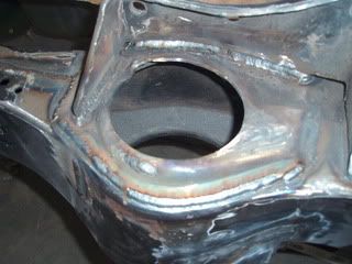

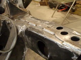

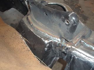

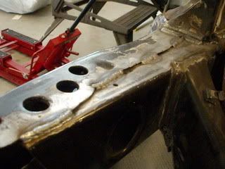

After some quick research I decided that fully welding the subframe was more for aesthetic reasons. So, we (my dad and I), just stitch welded the rails and concentrated more on the UCA mount. This was done using a millermatic 175 (220V) and gas shielded wire. Here's some pics so far. Its not done yet.

..... And we did not make a jig, just took our time.

That came out very good btw.
