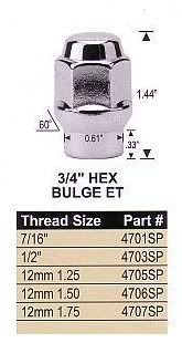

Tobin, Yes that is exactly right, and I use them on everything. Also, its the only lug we sell, and stock.
Yes, we have them for 1/2, 7/16, 12x1.5mm, and more.
OD is 0.61" fits 99% of the wheels out there. The shoulder is actually .33" long, to be technically correct.
http://i37.photobucket.com/albums/e9...ns/ET_Lugs.jpg
