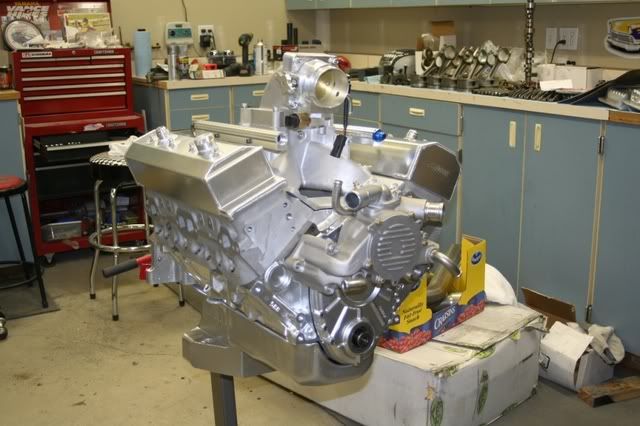

I just finished redoing the oil / breather / pcv system on my Nomad... I was tired of oil dripping out the SINGLE breather I had... and the "kinda" PCV I made up. Since there's little vacuum to be had on an 8 stack EFI... there's no real good way to do a proper PCV... So I just gave the crankcase lots of room to breathe. Added two weld in breathers -- a weld in oil fill bung -- and a breather/catch can down in front of the radiator (it's still above the pan!) -- I plumbed the breather catch can to a 3/8 NPT Male to -10 AN fitting in the fuel pump block off plate...
http://i919.photobucket.com/albums/a...d/IMG_0966.jpg
http://i919.photobucket.com/albums/a...d/IMG_0968.jpghttp://i919.photobucket.com/albums/a...d/IMG_0980.jpghttp://i919.photobucket.com/albums/a...d/IMG_0965.jpg
