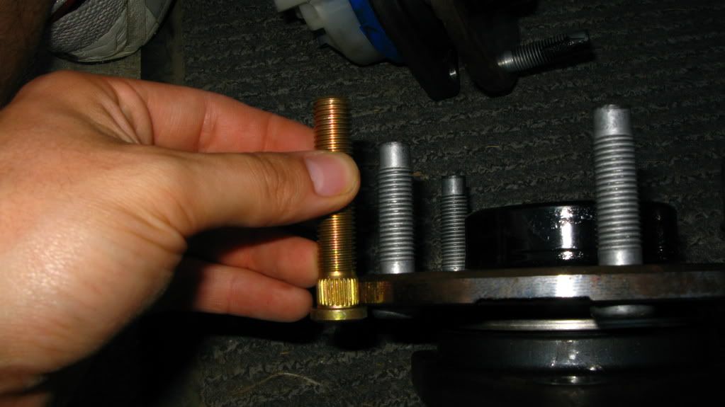

sik68 07-23-2009 05:08 PM
ARP 7708's for me:
http://i207.photobucket.com/albums/b...o/IMG_0618.jpg
