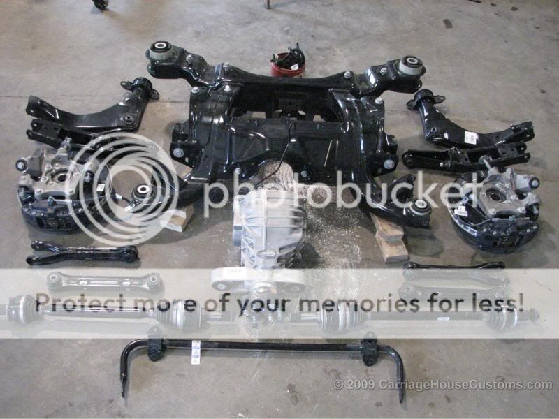

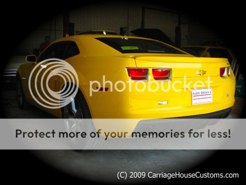

I thought that this might be something that you folks were interested in - if nothing else - to see how the new Chevy Camaro is built (or in our case - UN-built).. One of our customers is having us build a new (and I mean NEW) racecar for him and I thought I would post a link to the website and some pics in case you were interested in watching Carriage House Custom Automotive's website and build progress..
This is going to be an exceptionally nice road race car that's being built to run wheel-to-wheel in NASA's American Iron series and hopefully we'll be able to get Homologation into the SCCA's American Sedan class as well..
So far all the neighborhood kids think we're working on Transformer's Bumblebee Camaro.. :)

Here's just a few pictures for starters;
http://i420.photobucket.com/albums/p...IMG_3155_2.jpg
http://i420.photobucket.com/albums/p...S/IMG_3156.jpg
http://i420.photobucket.com/albums/p...Rear_Susp0.jpg
http://i420.photobucket.com/albums/p..._Drop_Eng2.jpg
http://i420.photobucket.com/albums/p...Driveline1.jpg
http://i420.photobucket.com/albums/p...Eng-Trans1.jpg
http://i420.photobucket.com/albums/p...Rear_Susp1.jpg

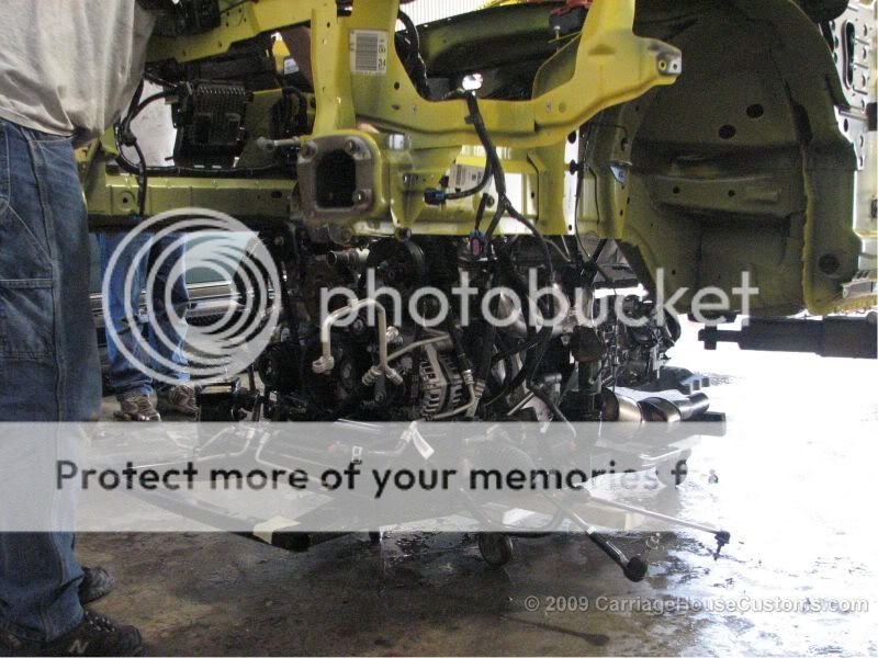

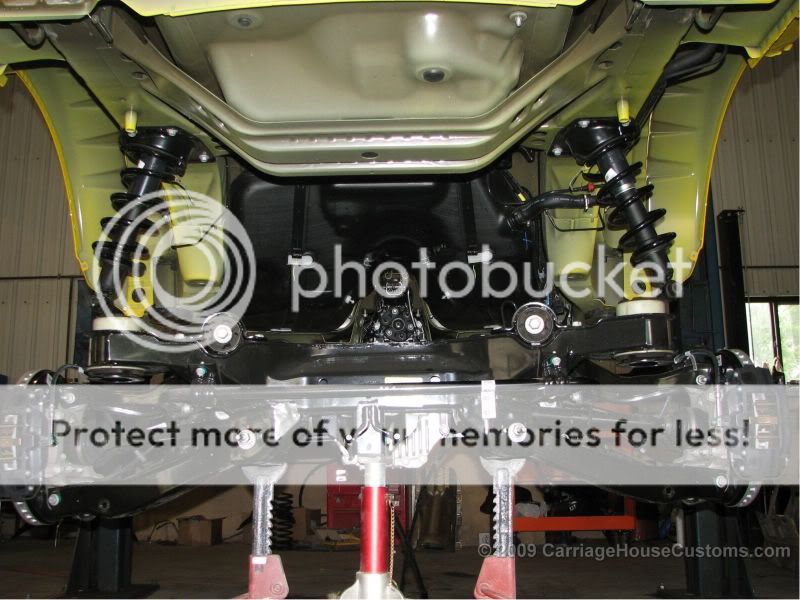

The original Engine, Trans and Rear-end/suspension are going back in after we finish the chassis. The engine will get a custom set of headers and probably a tune. We may end up pulling the TR6060 trans and installing another ""lighter" one like the TKO600.
First thing is to get all the sound deadener out of it and get the cage built - then it's on to suspension mods..
We get a lot of questions like - Why not start with a BIW?
Actually when you start with a BIW, it's nothing more than just the body. To purchase the engine and driveline as well as all the suspension, wiring harness, ECU, etc - well - you end up paying a substantial amount over what the dealer will sell you the car for... Another Plus is that the car has a VIN. Not that having a VIN is important to a Race-Only car such as this one, but with all the racecars being stolen. stripped and sold for parts, it makes sense to have most of those parts stamped with the VIN.

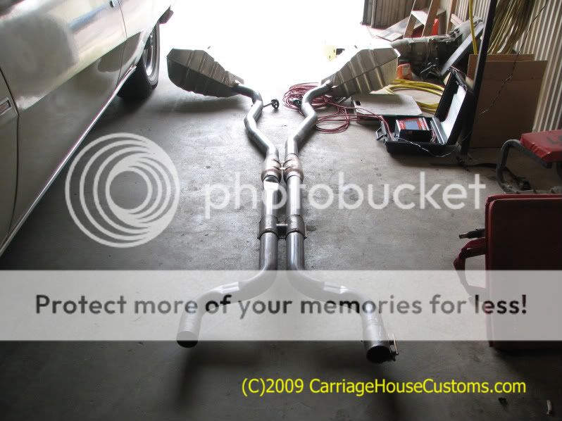

At 3,840# with 3/4 load of fuel, you can see this girl needed to go to Weight-Watchers.. Gradually she's shaping up and will be one very wicked contender on the track.

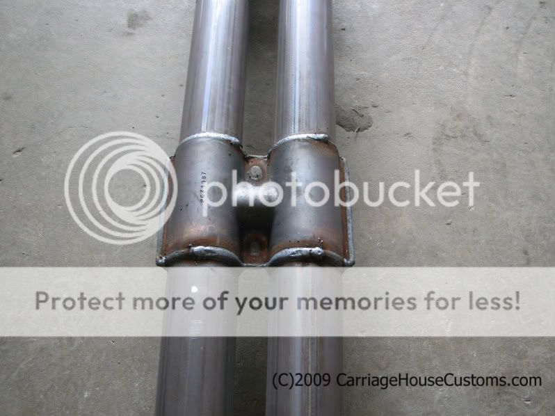

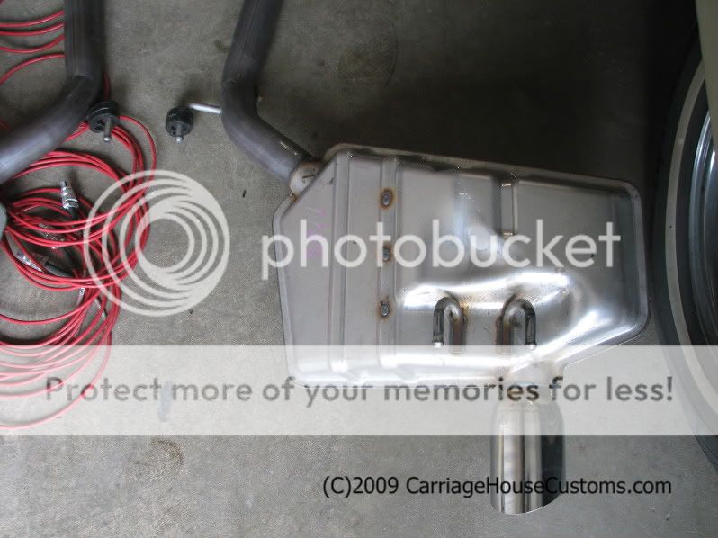

Here's some other shots of the exhaust system and components;

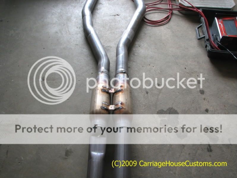

The whole 9 yards - This system weighs in at 75# not including the manifolds and cats;
http://i420.photobucket.com/albums/p...S/IMG_3234.jpg
The Balance Tube (H-Pipe)
http://i420.photobucket.com/albums/p...S/IMG_3238.jpg
The Resonators
http://i420.photobucket.com/albums/p...S/IMG_3237.jpg
Big-Mufflers
http://i420.photobucket.com/albums/p...S/IMG_3236.jpg

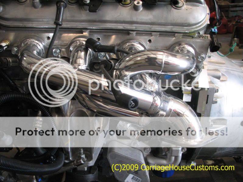

Cast Iron Exhaust manifolds (although they look like they'd flow well)
http://i420.photobucket.com/albums/p...S/IMG_3457.jpg
Replacement Doug Thorley headers (5# lighter than the iron manifolds)
http://i420.photobucket.com/albums/p...S/IMG_3387.jpg
http://i420.photobucket.com/albums/p...S/IMG_3384.jpg
