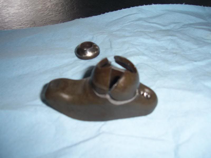

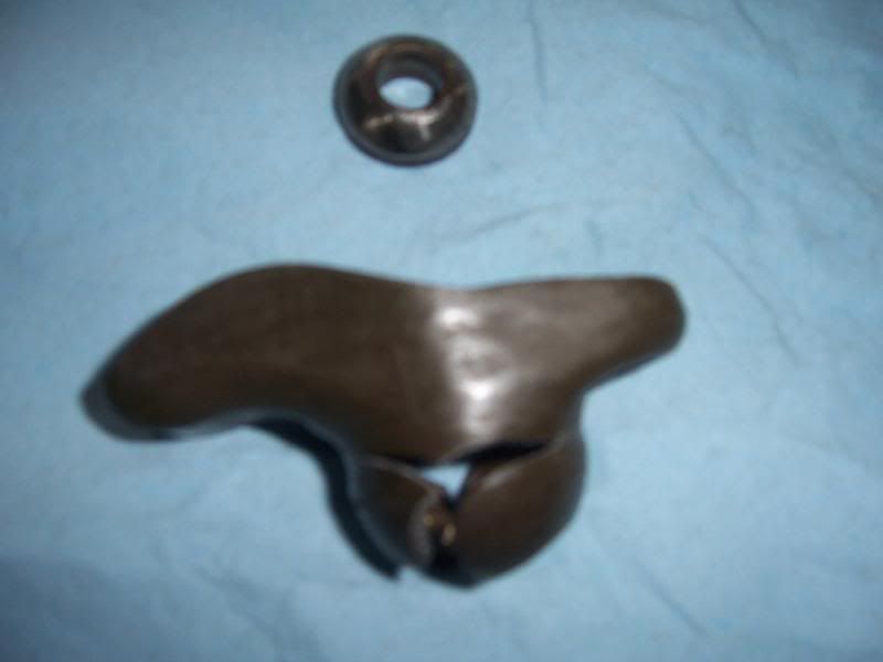

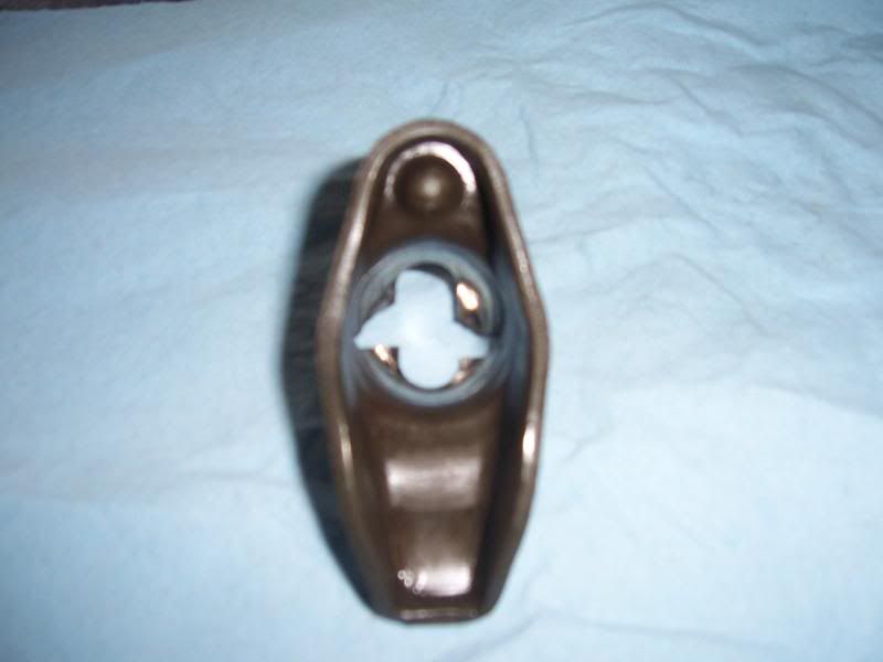

I went to take the car for a spin today and enjoy the weather a little. I warmed her up and then proceeded down the road. About 1/4 mile into the trip I noticed the sound of an exhaust leak or puffing from the driver side exhaust. A few seconds later I start to hear a light tapping from the motor. Instantly I pull it over, shut it off, and pop the hood. Everything looks OK. Start it up and I get a loud tapping from driver side #1 cylinder. Pull the spark lead and it stops. Great....something let loose in the new motor. Managed to limp it home and pull the valve cover and this is what I found....
http://i20.photobucket.com/albums/b2...Failure002.jpg
http://i20.photobucket.com/albums/b2...Failure003.jpg
http://i20.photobucket.com/albums/b2...Failure004.jpg
None of the parts of the rocker actually broke off....just spread like an orange opening up. I spotted a few very fine particles but nothing major. So now I would like to find a good quality upgrade rocker set that I can still fit under my stock 396 valve covers. Any ideas?

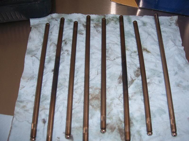

I have a bent #2 pushrod and several are slightly darkened in the centers. Is this discoloration from stress?

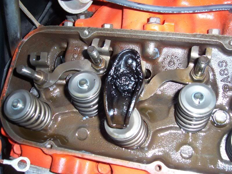

#7 exhaust rocker looks to be getting super hot as the oil is burning on the rocker and nut. Any ideas what is going on here? This is the only one that has an issue.

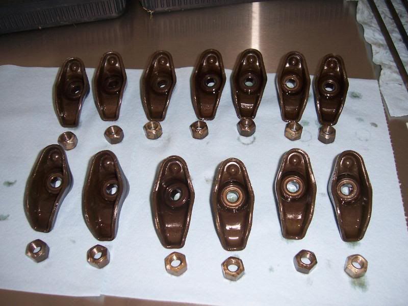

All the other rockers seem to be fine. I don't have any galling on the pushrod tips at all. I noticed the guide plates on the pass side have a little wear but there is nothing really on the pushrods themselves.

If the lift is beyond the mechanical abilities of the rocker, they bind and break through eventually. The rocker that has the "ball-o-sludge" is due to lack of lubrication at some point. It got hot and the oil that made it to the rocker was baked in place. You need a good set of roller rockers or a set of long slot stamped rockers. Use cam lube on the pivot balls for the initial start-up.
