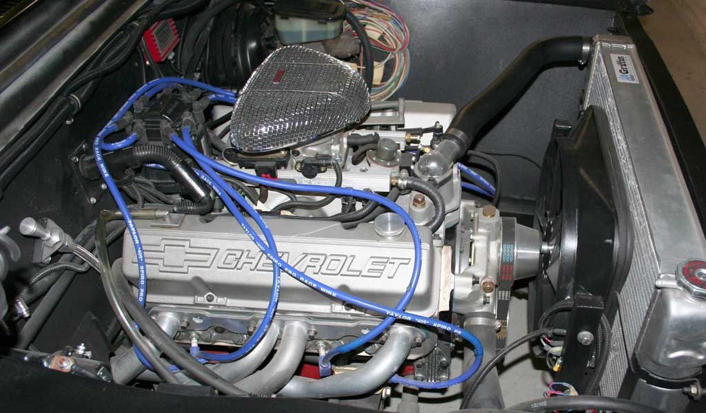

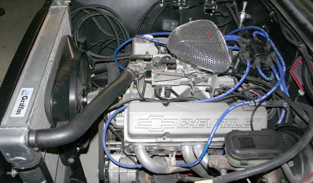

But all I have for the finished firewall are some hard to see pics after the engine was dropped in. And as you can see, she isnt done yet. This was after the cam run in. Got sidelined from the engine compartment to the suspension build up. Got lots of great pics of that though LOL
Hard to see the firewall pics :)
http://img.photobucket.com/albums/v3...s%20Nova/2.jpg
http://img.photobucket.com/albums/v3...va/drivers.jpg
http://img.photobucket.com/albums/v3...a/passside.jpg
So anyway. Wish I had more to show. Like right before I dropped the engine in. But those were the film days, processing wasnt cheap. But I woulda thought I would have at least taken one shot. Maybe it was blurry who knows. And really, its not a show quality job. I never intended for this car to be that, I dont have the money. But I did want a solid car, one that wouldnt rattle, rust or was ugly. Major gap between ugly and show :)
