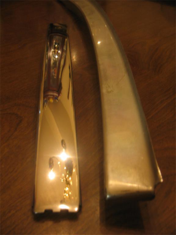

DocJr 09-25-2009 10:01 PM
Update
2 Attachment(s)
Thanks JamesJ for the response. Upon doing a little more research I found that I could in fact sand off the top coat. I have it to my desired reflectivity, now I have to decide how to re protect it if you will.
Should I powder coat them? Will you see the coat?
Should I anodize them? Do you think it will keep the same luster?
It definately needs to be protected, it's soft.
Heres a few pics.
Thanks again.
slhsdr 09-26-2009 07:50 AM
I'm new to this forum, but i have had this same problem on many gm cars. my solution to this is 1of 2 ways. first if the car stays in the garage i just polish as you have and reinstall. every once in a while i hit them with mothers to bring back the high gloss because the will dull over time. the other way i do it is to polish them and then clear coat them. it makes them a little duller but shinier than original but you don't have to polish them. Ive been satisfied either way.good luck with your choice.steven

E.rodz 10-28-2009 06:07 PM
after your done polishing your going to want to powdercoat them . if you clear anodize the aluminum will turn kind of whitebut clear powdercoating will retaine the look it has when your done polishing.
