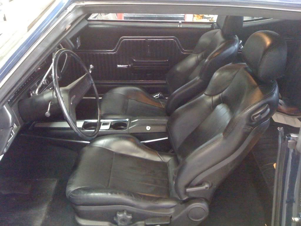

finally new seats
After a long debate on whether to redo my factory 70 chevelle bucket seats or just buy new ones i made a decision. they are nice and comfortable, most importantly, very adjustable! they really dont clash too bad with the rest of the interior either, im debating on whether i should put the chrome trim on the hard backs just to bring them around like the factory seats were..
here are some pics. enjoy.. http://img.photobucket.com/albums/v3...b/d794daca.jpg http://img.photobucket.com/albums/v3...b/ee4988d8.jpg http://img.photobucket.com/albums/v3...b/024ec0eb.jpg http://img.photobucket.com/albums/v3...b/3727b103.jpg http://img.photobucket.com/albums/v3...b/51357a65.jpg |

good guesses.. they are acually from a hyundai tiburon!:willy:
btw. they are just as black as the rest of the interior. i dont know why they look charcoal in the pics..

i just drilled four holes in the floor pan. i used some really thick 2" shim washers we have and some shim stock. only the front two mounts need a 3/4 inch shim cut. then i used the washers top and bottom to pinch the floorpan. i was going to build some nice brackets because i planned on bedlining the floor while i had the carpet out. well turns out the floor pans were flawless. no rust or anything so i just rolled the carpet back far enough to work. i really like the fact that that butt of the seat is adjustable up and down. the offer far superior support than the factory seats too.
