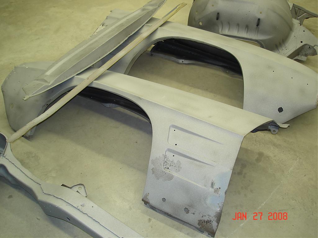

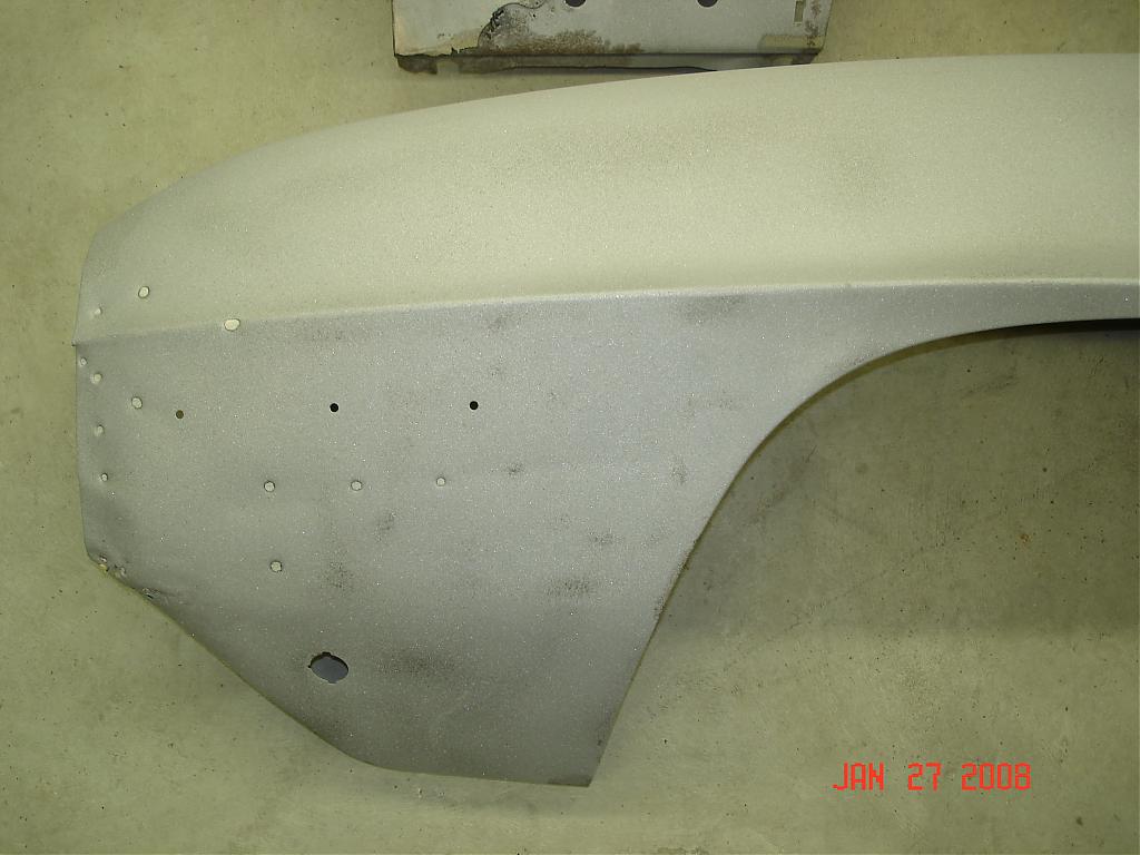

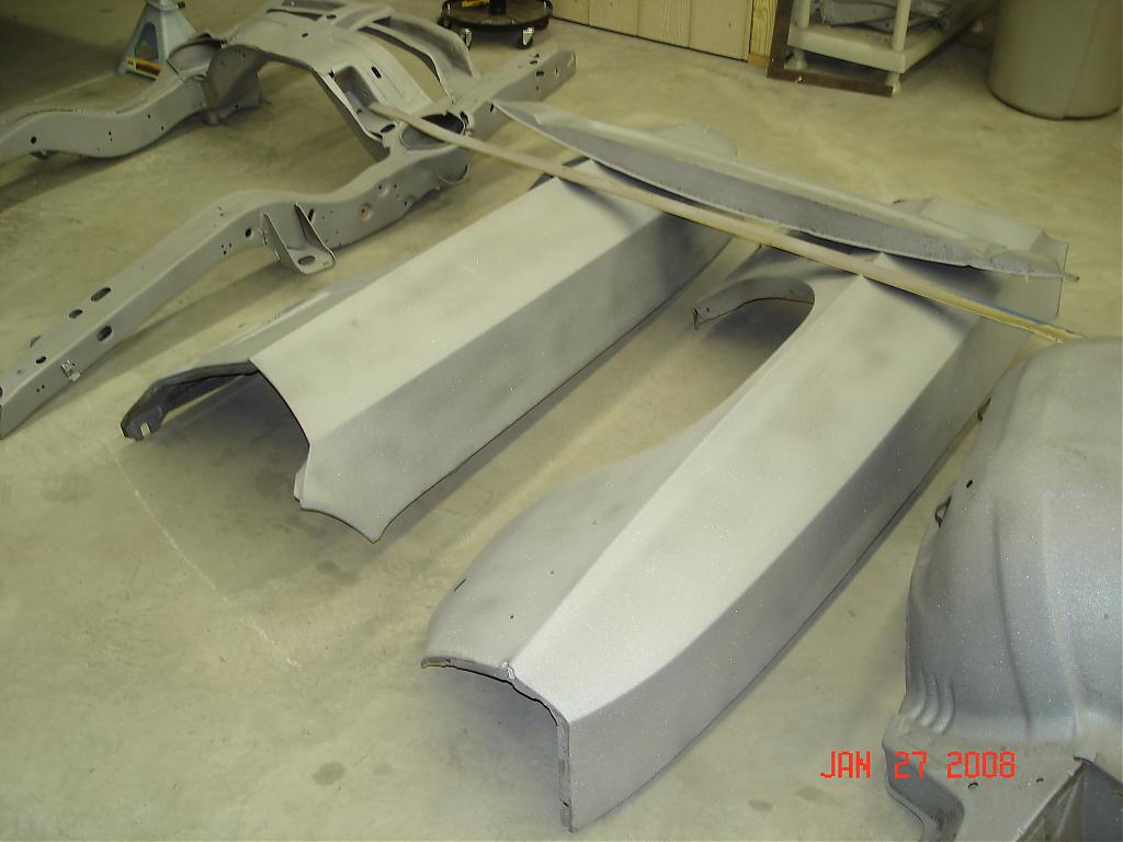

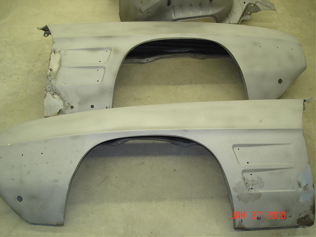

Are my fenders on my '69 Firebird too bad to repair?
At the moment I can't recall what condition the supports are behind the fenders.
I would like to keep all the original metal I can.
Thanks for the help.
Ron Fox 09-25-2009 12:56 PM
Everyone's thoughts please.
Thanks.
Mrfixit 09-28-2009 09:36 AM

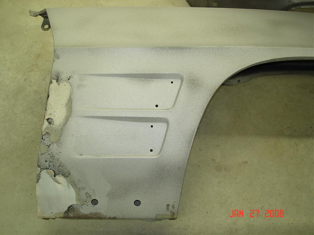

How does the inner support look? Is it solid? If so, then repair the originals. You'll work harder making re-pops fit then fixing your originals. Patch panels are available from National Parts Depot. You can't beat the fit of an original fender. Be sure to weld up the holes in the front of the fender.

Another '69 Firebird owner expressed his concern of the crispness of the lines on the "scoops" of the patch panels. I have not seen a "scoop" patch panel so I am not sure how straight the lines are. I wonder what the scoops look line on a full fender repo?
I plan on repairing the originals since everyone seems to have problems with the linement of repos.
