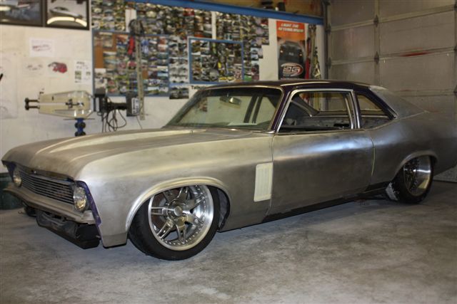

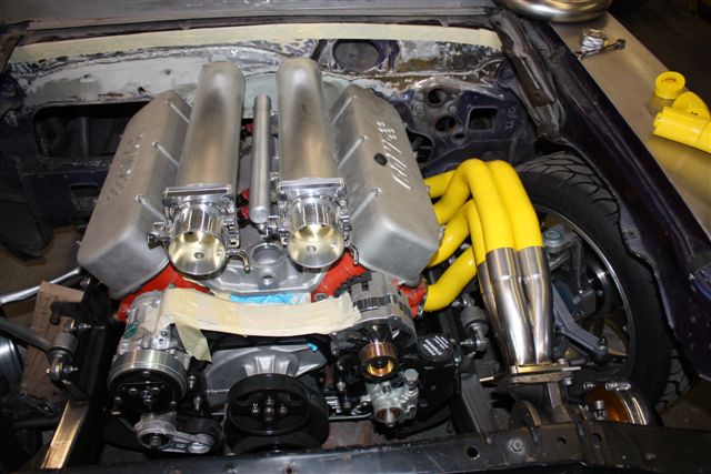

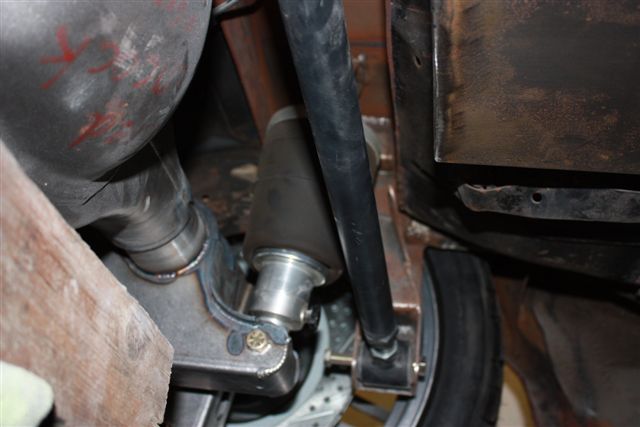

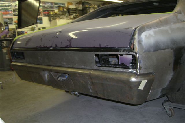

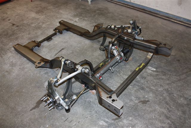

Erik Johnston's 70 Nova Build
This project is too special not to share with all that use this sight.
Rushforth Design
J-Rod and Customs built
A JCS project.
Motor/Trans
Twin Turbo Big Block Chevy
Gen. V .060 over (468ci) w/torque plates
Plato honed for plasma molly rings
J&E turbo pistons
World Products Merlin Heads 2.190, 1.880
Comp Cams,
Valves
Springs
Collars and Keepers
Cam, solid roller .661 lift, 291 duration
Endurex solid roller lifters
Hi-Tech 3/8" 4130 Chromemoly pushrods
Forged crankshaft
Eagle H beam rods, 6.385"
90lb fuel injectors
Super T04E 60's
Cloyes stree true roller timing set
TH400,Gear vendors
Vintage Air front runner
Wheels
Rushforth Wheels
Rear 305/30/19s
Front 245/40/18s
Style: Whiplash
Centers are Smoked Titanium with brushed/cleared barrels.
Suspension
DSE Rear four link 9" rear end
DSE Mini tubs
Custom Frame connectors
Art Morrison front sub frame
C6 vette front suspension
Air Ride Technologies Shock Waves front/rear
Baer Pro+ 14" rotors, 6 piston calipers
Baer Track kit rear
Body
Exquisite, subtle styling by Jason Rushforth. Performed by Jared Hancock
6pt cage
Functional fender vents for turbos
See photos, Rendering coming.
Hood
Rushforth design
Featured in Chevy Rumble Mag.
Built by J-Rod and Customs
Interior
N/A
Paint
N/A

96z28ss 10-07-2009 01:15 PM
Looks like an awesome build.
First time I have seen those exhaust legos used.
I have never seen those before....great idea/tool!! :thumbsup:

96z28ss 10-07-2009 06:05 PM
Originally Posted by awr68 (Post 239357)
I agree!!
They are super expensive!
