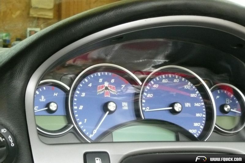

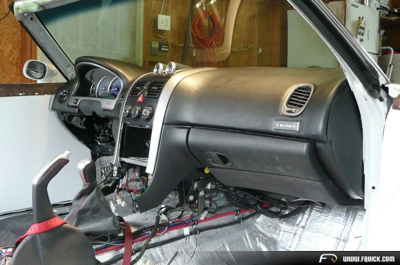

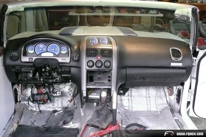

Samhatco 01-07-2010 11:46 AM
It can be done ...
This is my 69 TA that I put an 04 GTO dash in
http://www.fquick.com/images/vehicle...7994290971.jpg
http://www.fquick.com/images/vehicle...7994290975.jpg
http://www.fquick.com/images/vehicle...7994290974.jpg
http://www.fquick.com/images/vehicle...7994301057.jpg
http://www.fquick.com/images/vehicle...7994301056.jpg
Seats are from an 04 BMW M3 vert.
Sam

badmatt 01-08-2010 05:50 AM
looks FRIGGEN AWESOME! I love my GTO interior..
