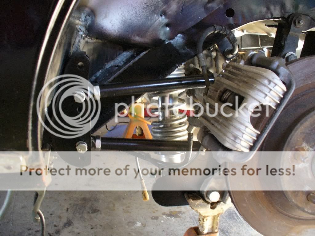

I built my own for my 67 Camaro. Really wasn't too hard to do. Here's a pic.
http://i539.photobucket.com/albums/f...g/P1000693.jpg
http://i539.photobucket.com/albums/f...g/P1010162.jpg
http://i539.photobucket.com/albums/f...g/P1010564.jpg
68brdlvr 10-15-2009 02:38 PM
That is just what the doctor ordered! I was wondering what to do about the forward links as most setups cut open the back seat...now i know. Other than just running them forward and apart does the location of those links hurt performance or are they just there to hold things put?
Thanks very much.
Beach Cruiser 10-16-2009 05:31 AM
I made mine adustable so that I could move them around if I raise or lower the car. It also has some effect on anti squat but I havn't tested anything yet. you can see that I made mine from Speedway products tie rods and qa1 endlinks so I can also adjust the kingpin angle on the rear (if it really matters). Mine are also longer than stock. I do have minitubs installed, with out those you would be inside the inner fender. If it helps you I have the .dxf files for most of the components that I had my buddy waterjet for me. That should be worth at least a case of beer to you! :cheers:

a .dxf is a cad drawing file that your local shop can use to CNC the parts out with a plasma or waterjet table.:thumbsup: Way better than the old tourch or cutoff wheel method.
