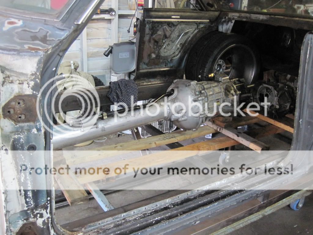

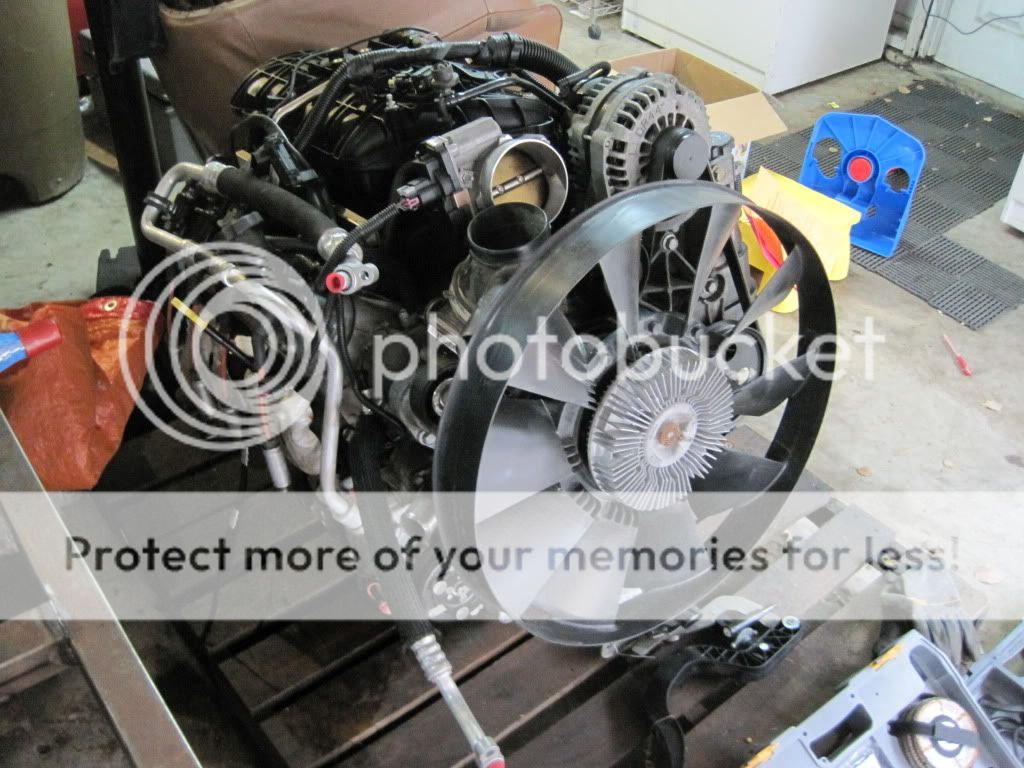

Here's the start of my next build, named "All in"
I came to the name as I evolved to my final Build Plan (at least as final as these things get...). Being an SS, I started with the idea that I might just leave it alone, put a V8 in it and set it up as just a nice solid street car. Then I started considering a Pro Street or Pro Touring build. Obviously, PT is where my heart is and so once I dropped a bunch of cash on a C5 drivetrain I decided I was prety much "All In."
Build Plan:
1963 Chevy Nova SS
Scott's Hotrod IFS
Full tube chassis from front clip back
2004 C5 Corvette drivetrain (Bellhousing, Torque tube, rear mounted T-56, and IRS)
LS2 - STS twin turbo setup?
As you can see from my starting point, I've got my work cut out for me. But afterall, the journey is the fun part!

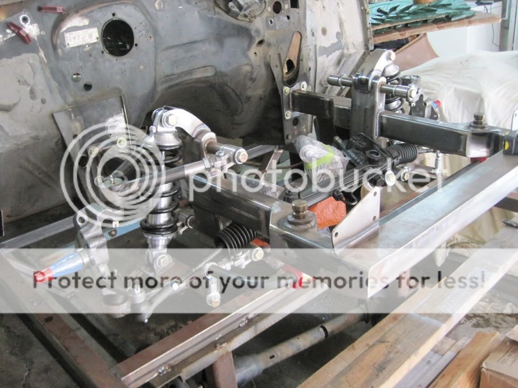

Picked up my IFS from Scott's the other day, and I'm stoked. Literally, it is a metalic work of art... perfect TIG welds throughout. Can't wait to get going on the install
I went with the Power Rack, Sway-bar, and Wilwood 12" brake upgrade

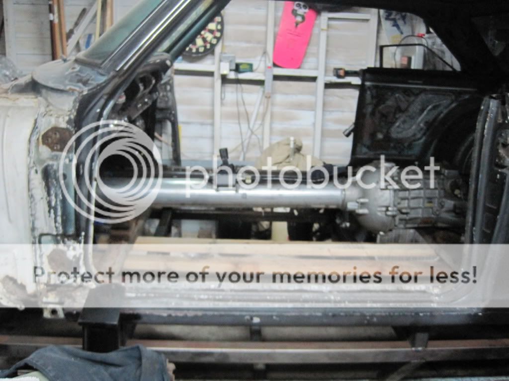

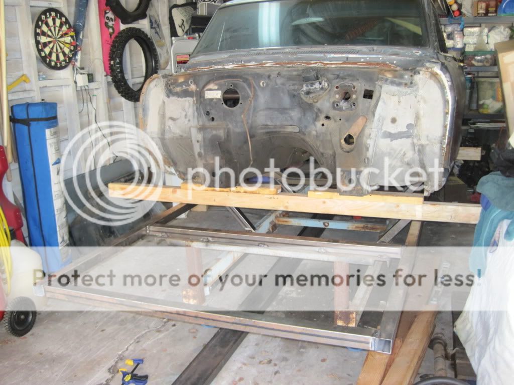

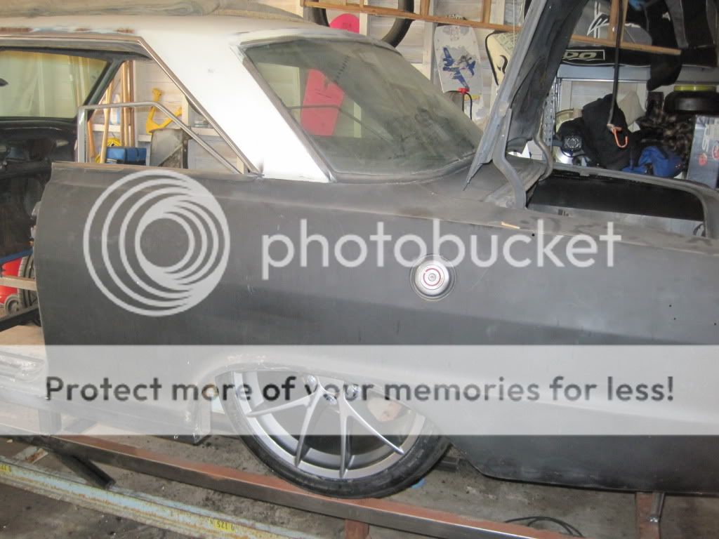

SoCal_63 SS 10-14-2010 02:00 PM

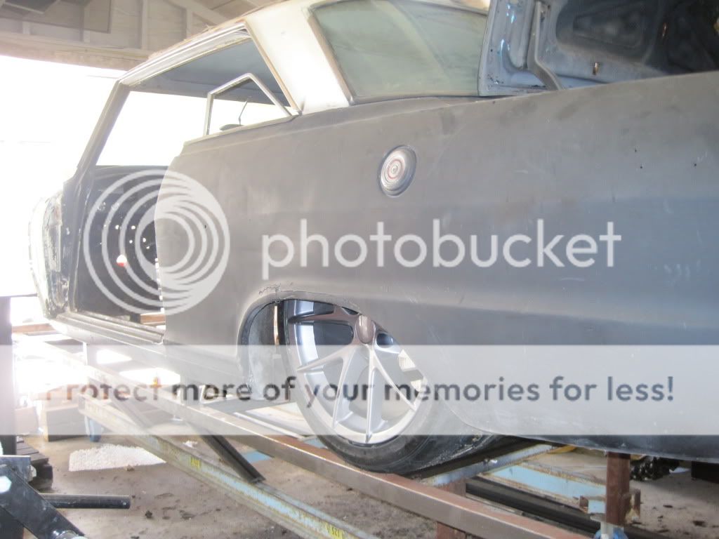

Ahhh... where to begin. Plans shifted a little, but making some slow progress...
Going up on the Fab Table:
http://i814.photobucket.com/albums/z.../100212142.jpg
http://i814.photobucket.com/albums/z...2-12135417.jpg
http://i814.photobucket.com/albums/z...2-12135453.jpg

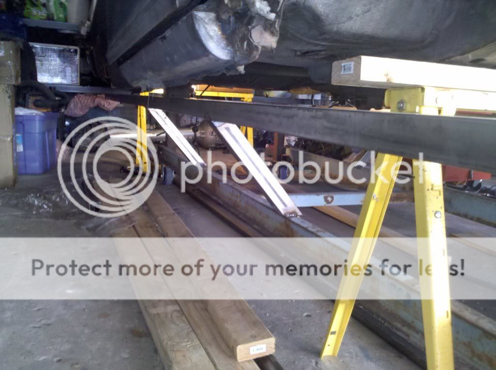

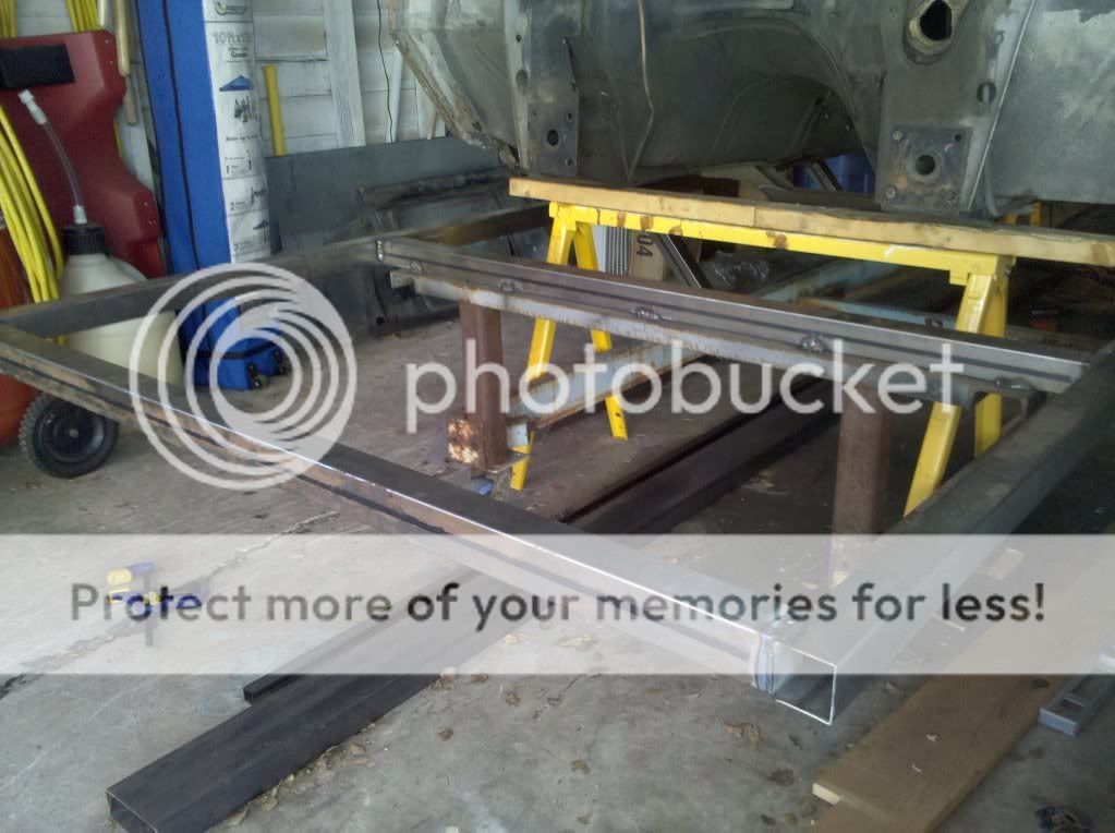

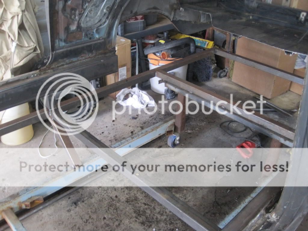

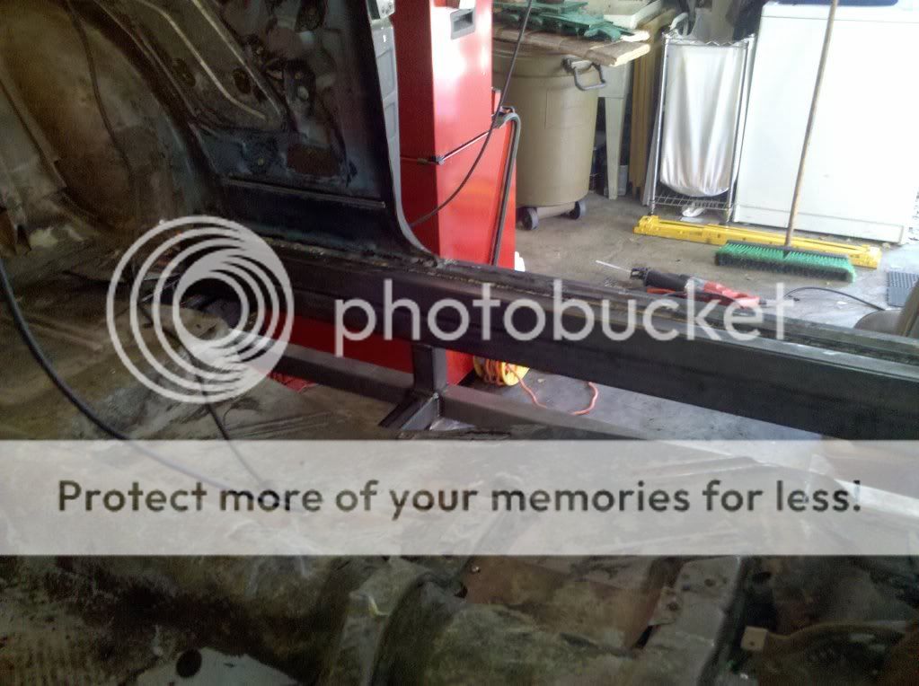

Perimeter rail installation begun:
http://i814.photobucket.com/albums/z...2-18133529.jpg

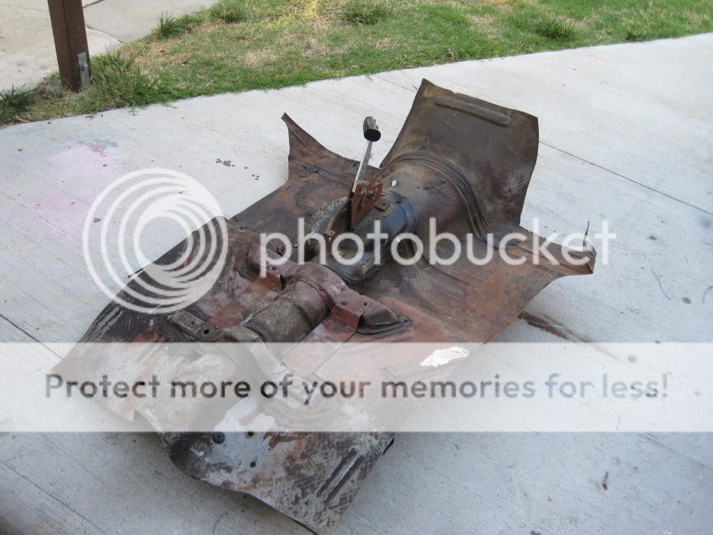

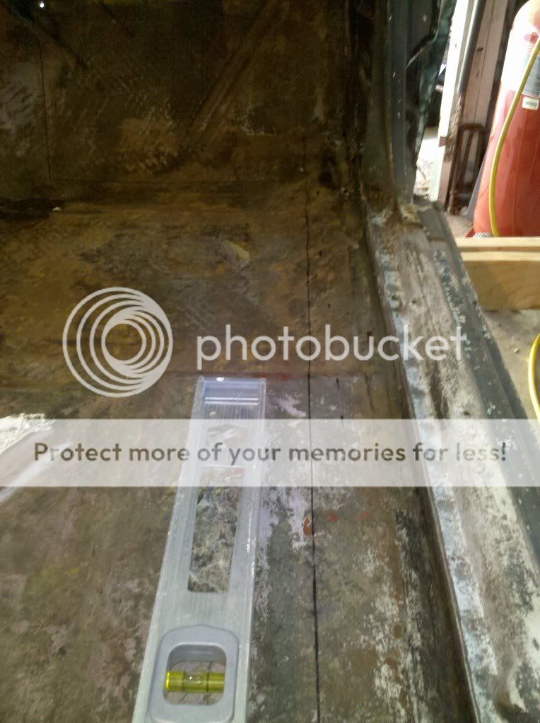

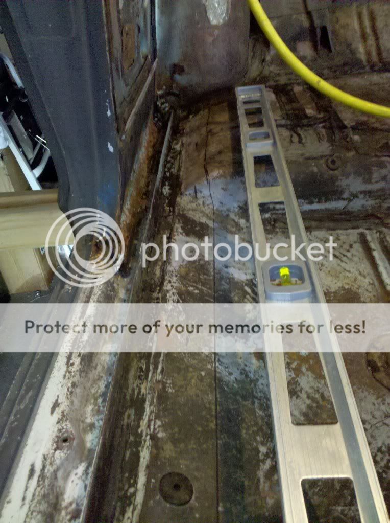

Floors marked:
http://i814.photobucket.com/albums/z...2-18133511.jpg

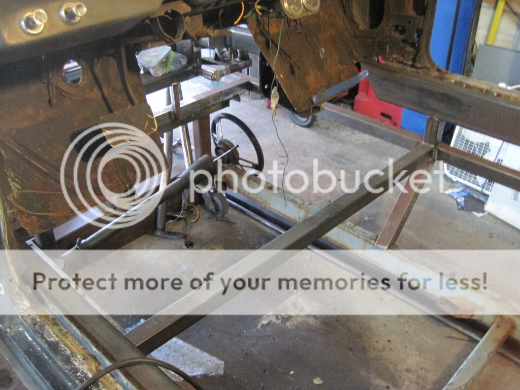

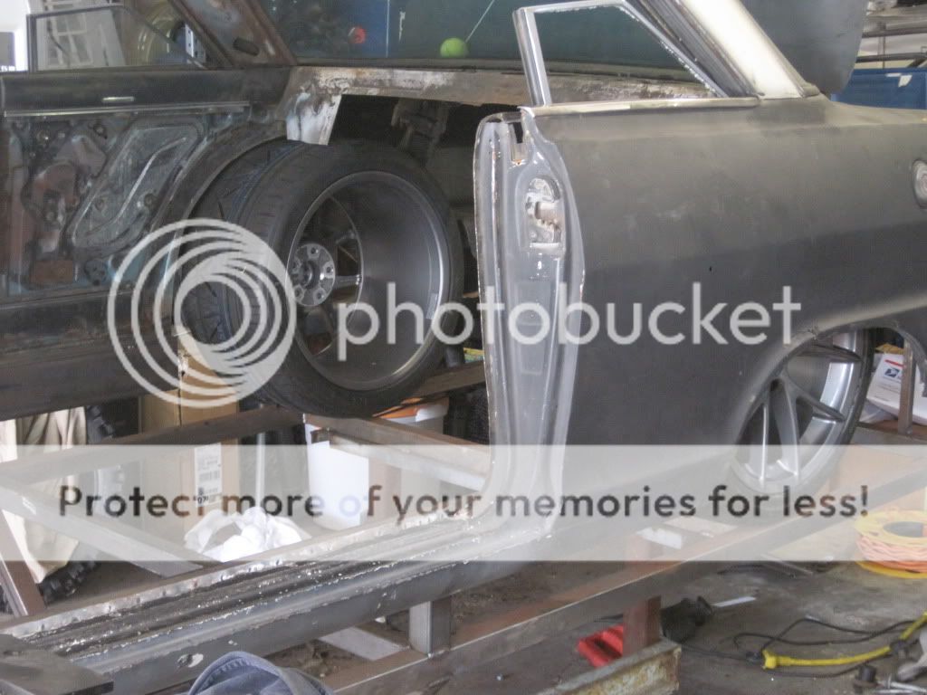

3" section removed in order to insert the rail, but keep the car sqaure until it is tack welded down to the table:
http://i814.photobucket.com/albums/z...4-18143834.jpg
Next, clean up the actual area where the perimeter rail will be welded to the car, tack weld to the table at ride height, and remove the rest of the floor...
We'll see how much time I get in the next few days/weeks..

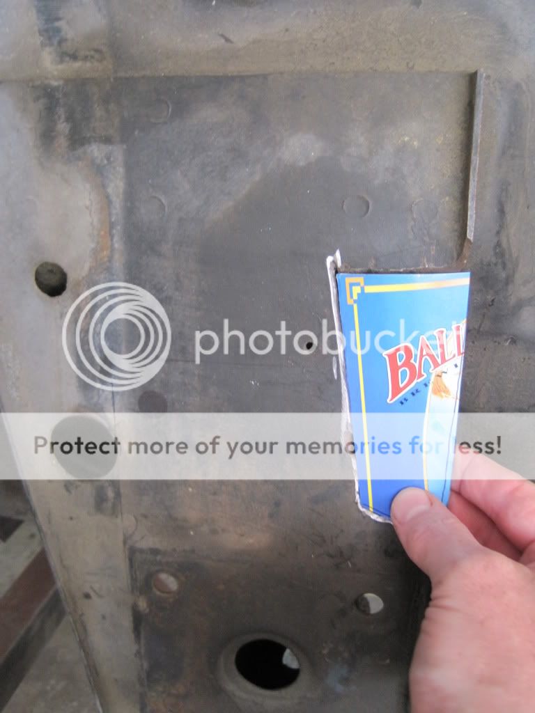

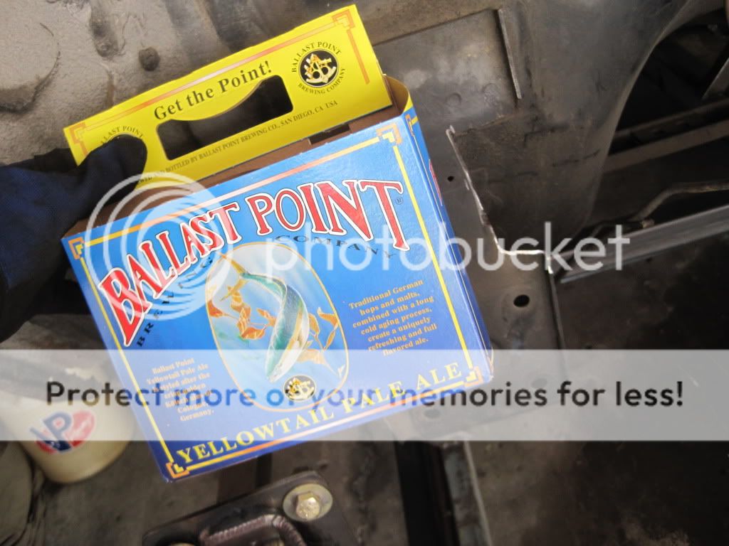

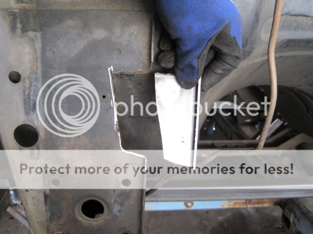

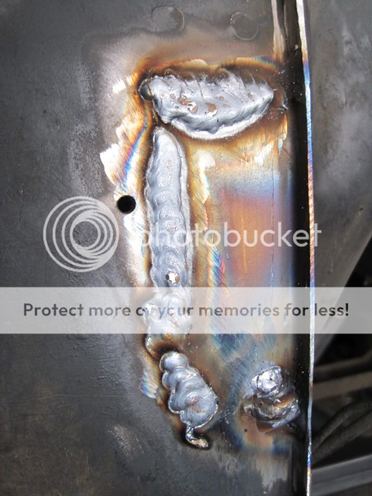

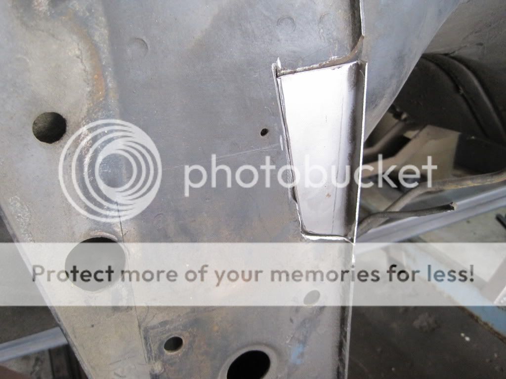

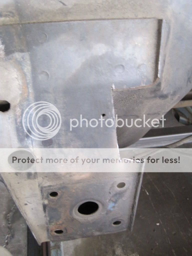

SoCal_63 SS 10-14-2010 02:18 PM
Repair of front subframe flange
Someone decided to cut a notch out of the front sub-frame, here's what we did to repair...
Passenger side damage:
http://i814.photobucket.com/albums/z...2010-06-07.jpg
Getting cleaned up:
http://i814.photobucket.com/albums/z...2010-08-10.jpg
Clean:
http://i814.photobucket.com/albums/z..._2010-0610.jpg

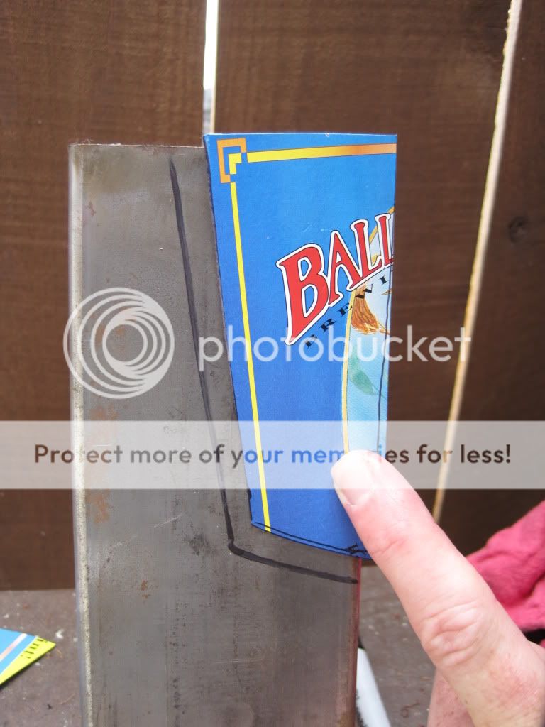

Template material:
http://i814.photobucket.com/albums/z...2010-06-10.jpg
Template cut out:
Transfer to metal:
Cut to shape:
Test fit:
Tacked, checked, and finished:

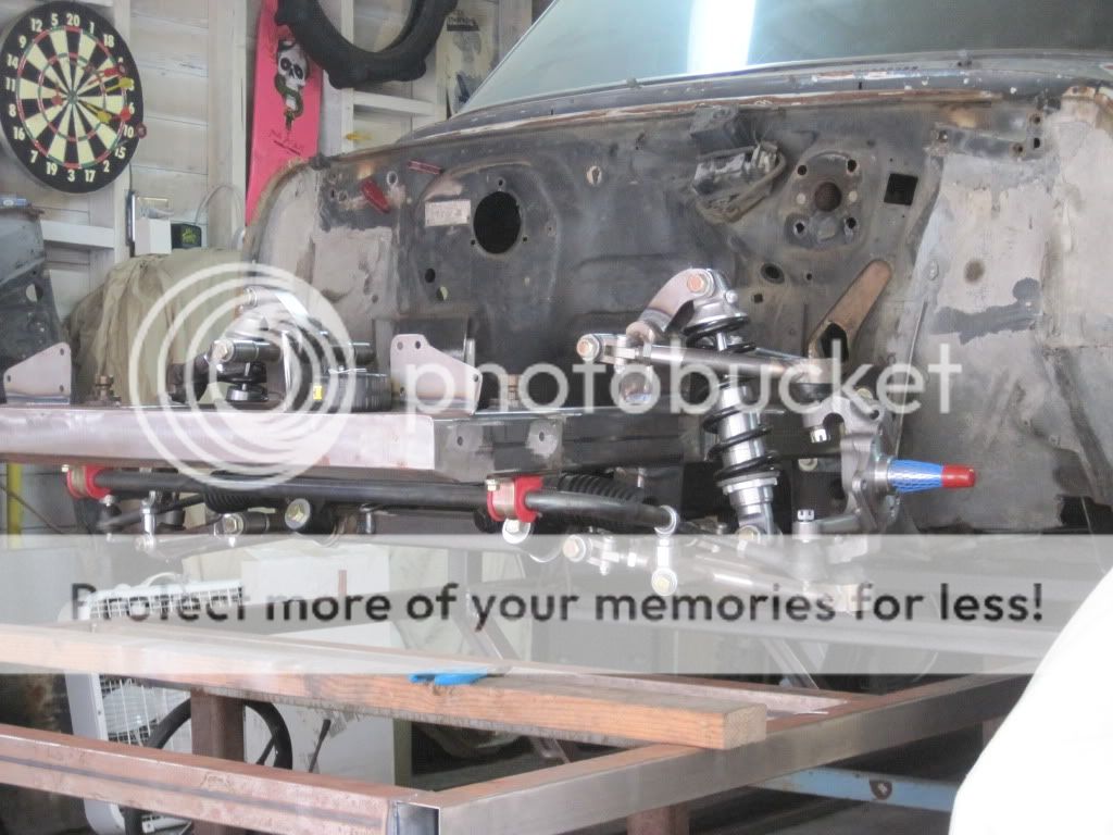

SoCal_63 SS 10-14-2010 02:31 PM

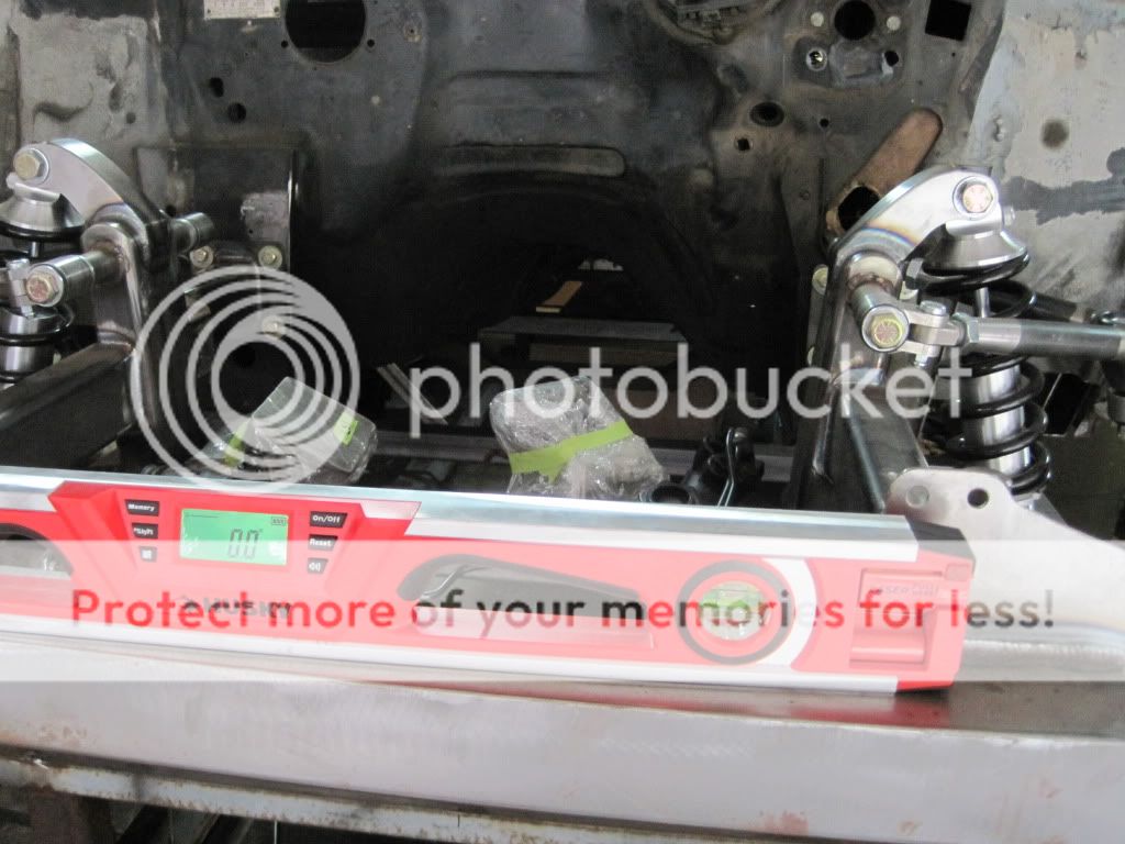

Scott's Hotrod's IFS
The Scott's Hotrods IFS was next. Note that the mounting location was moved up into the car 3”, essentially lowering the front end by that much and getting that low and mean stance:
http://i814.photobucket.com/albums/z..._201006-10.jpg
Leveled and tacked to the table:
