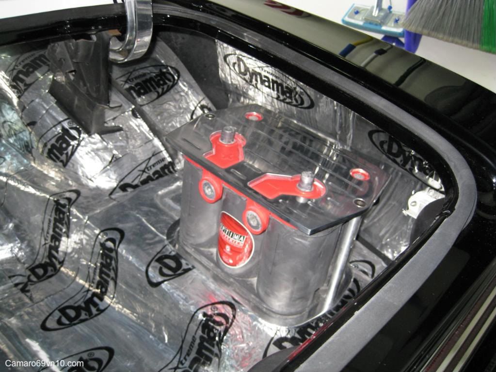

Flash68 11-03-2009 01:09 AM
trunk it! I have the Billet Specialties battery trunk tray kit.
