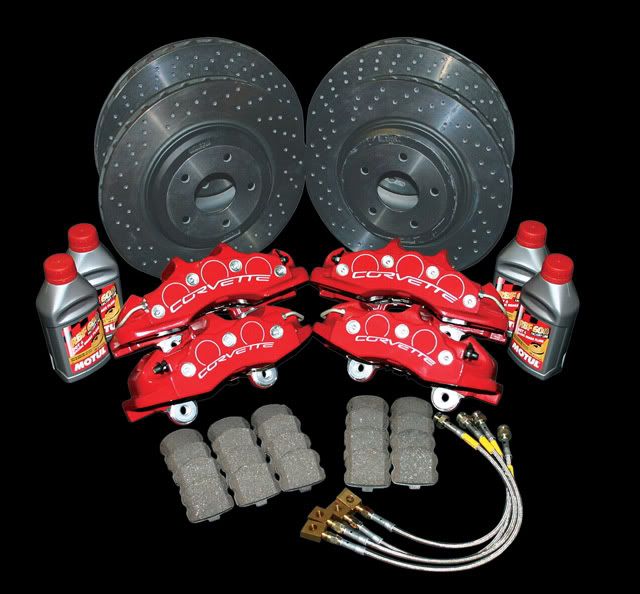

speedjohnston 11-03-2009 06:25 PM
This is what my buddy bought. You can get the package for under 2000.

comp-spec 11-03-2009 07:10 PM
C5 - C6 brakes are the same
C6 .. Z06 are bigger but are a bolt on
You need to run a 18in or bigger front wheel with the C6 Z06 brakes
