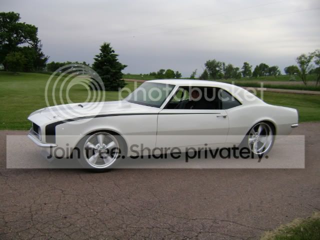

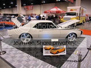

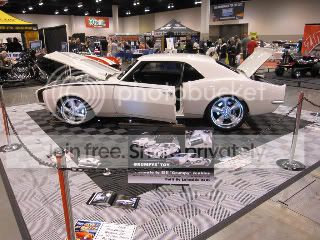

Does anybody know where I could find build pics of the "Grumpy" Jenkins tribute camaro built by Roger Burman at Lakeside Rods & Rides. It has to be one of the coolest 67-68 camaro builds I have seen lately. I believe I came across a website a week ago that had build pics, I cannot locate now and could use some help. I have tried the shops website and they do not have any pictures of this car yet.

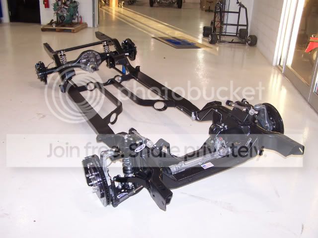

We (Roadster Shop) built the chassis and did a lot of the early metal work. Lakeside Rods took it from there and finished the car... and did a killer job with the finished product.
Here is a link to our web site with all of the work that we did on the car. There are not any good pictures, but this was the pilot car for our complete Camaro chassis as well.

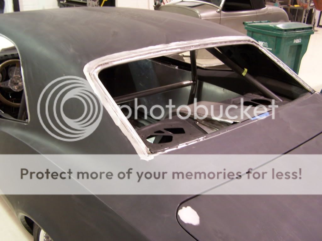

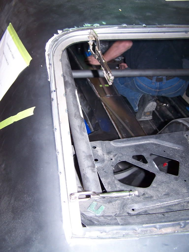

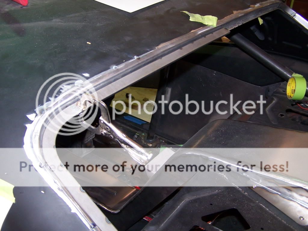

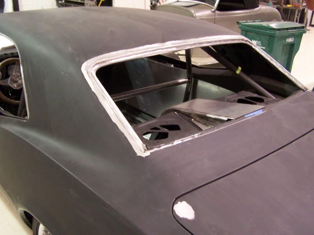

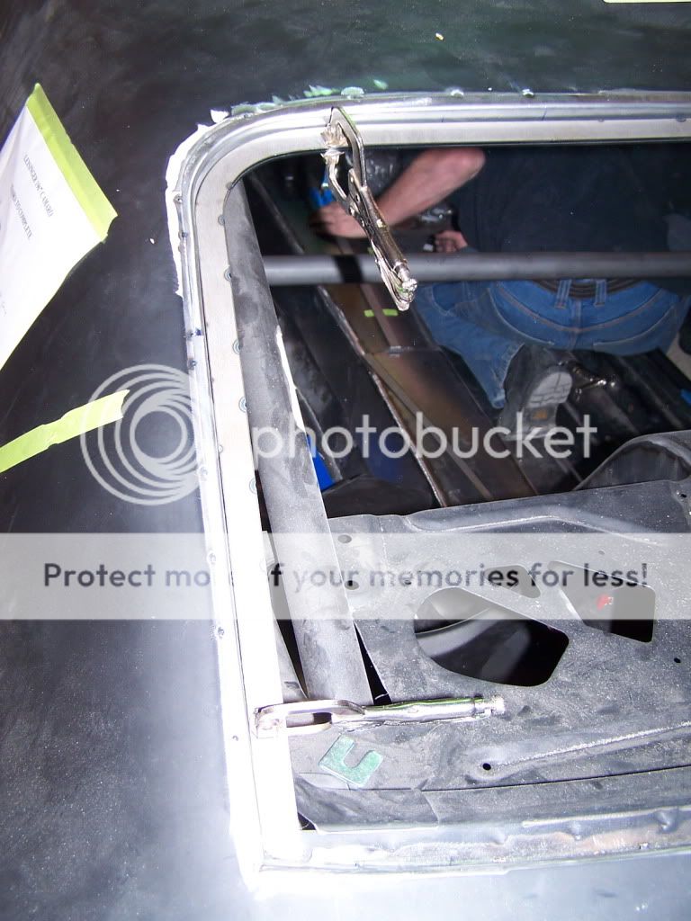

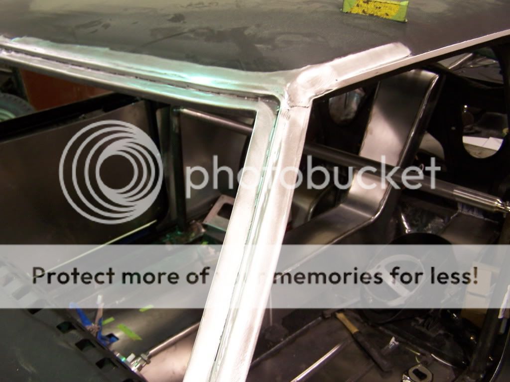

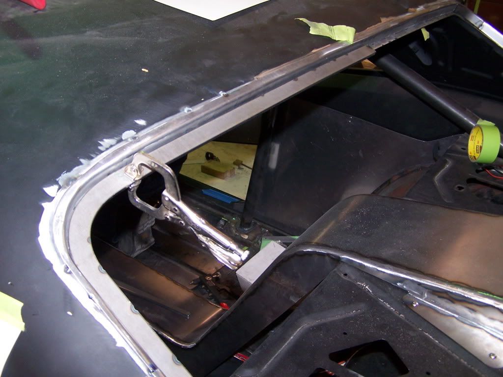

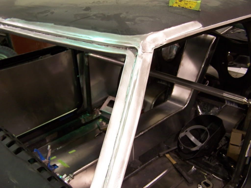

Does anybody have finished interior pictures? From the rendering by Eric, it looks pretty cool. Another question, is the front and rear glass flush mounted? I cannot tell by the pictures I have seen thus far but looks like they might have custom made a wider flange to flush mount it. Not like what was used on project "Evade".
Roadster Shop 11-13-2009 03:51 PM
I don't have any great pictures of how it was done, but basically, we added metal to the window opening so it met the stock glass. We fabbed a 90 degree bend and formed it to the shape of the window opening to take up the space between the glass where the stock molding would go. Then cut a new flange for the glass to mount to. Welded everything up and metal finished it.
http://i563.photobucket.com/albums/s...Picture123.jpg
http://i563.photobucket.com/albums/s...Picture124.jpg
http://i563.photobucket.com/albums/s...Picture175.jpg
http://i563.photobucket.com/albums/s...Picture141.jpg
