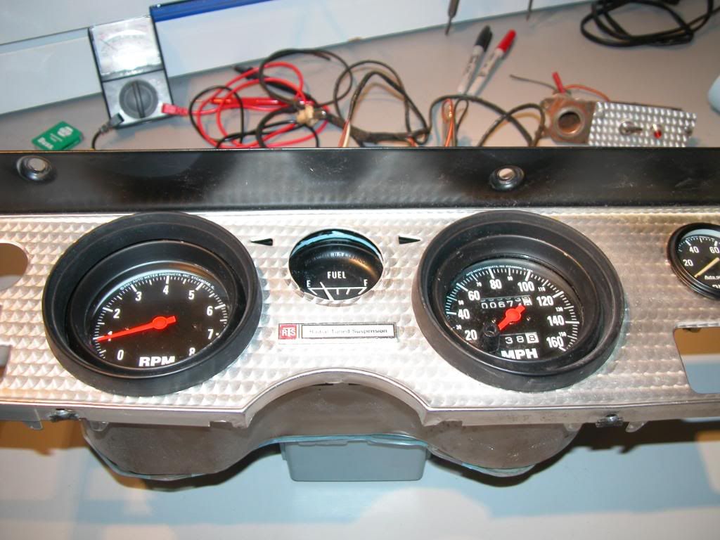

I planed on sinking some Auto Meters into my stock Bezel
I bought one of the 2-5/8" gauges and it fits perfectly into the smaller openings,
but the larger two holes are 4" I dont believe I'll have enough material to open up
the holes to fit a 5" speedo and tach and I'm not to sure about using the 3-3/8 gauges..
I am hoping that someone makes a 4" but have not had any luck finding any :(

this is for the Road Runner
http://i5.photobucket.com/albums/y17...nner/Gauge.jpg

NOT A TA 11-15-2009 06:46 PM
The Autometer 5" gauges are not 5" they are less. Even the outside of the trim ring is less than 5". In the second pic someone put the 3 3/8" Autometer gauges inside the stock trim rings of a Firebird dash panel.
The opening necessary for an analog 5" Autometer is 4 9/16" so you'd need to enlarge the opening by a little over 1/4" all around.
If you're interested in the Autometer gauges, go to their site and pick a gauge. On the page for each particular gauge there's a link to a page with all the dimensions for all of the various models they sell. They're not exact though, the dimensions I listed above are exact for the cobalt series.
http://i240.photobucket.com/albums/f...shbuild053.jpg
http://i240.photobucket.com/albums/f...build012-1.jpg
