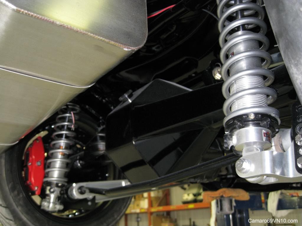

I am installing my G Link on my 68 Camaro. Does anyone have photos of the install with a 9"?

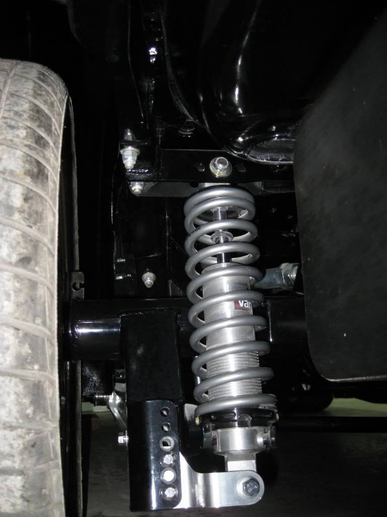

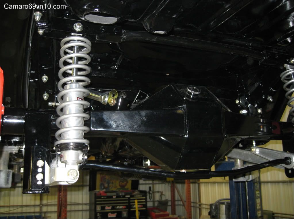

markd 11-18-2009 07:24 PM
How about these pics????
http://i254.photobucket.com/albums/h...0/DSCF2075.jpg
http://i254.photobucket.com/albums/h...0/IMG_0891.jpg
http://i254.photobucket.com/albums/h...0/IMG_0892.jpg
http://i254.photobucket.com/albums/h...0/IMG_0893.jpg
http://i254.photobucket.com/albums/h...0/IMG_0894.jpg
http://i254.photobucket.com/albums/h...0/IMG_0890.jpg
http://i254.photobucket.com/albums/h...0/IMG_2717.jpg
http://i254.photobucket.com/albums/h...0/IMG_2356.jpg
Good luck with the install!
Mark
