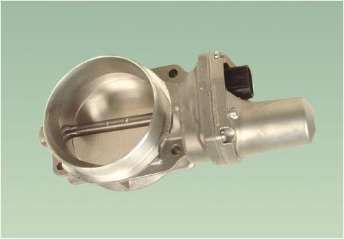

what computer are you going to use? That will determine if you need throttle by wire or not, they're set up one way or the other, not both.
The throttle by wire tb's have no cable hookup or throttle arm on them at all; they have a round cylindrical motor that opens and closes the blade.
Looks like this:
http://ecx.images-amazon.com/images/...gL._SL500_.jpg
LowchevyII 11-20-2009 12:11 PM
Ah, thanks Jody,
I dont know what computer im gonna use yet, but ive been hearing to probably stick with the the comp that came with whatever im pulling the motor out of so since its an LQ4 it will be cable driven out of a truck. So ill probably be sticking with Cable driven then and the factory computer.
