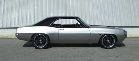

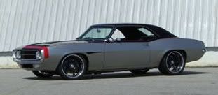

Yep, They look and fit great! Here's one we put 19s on that needs to come down another inch or two but the wheels fit great.

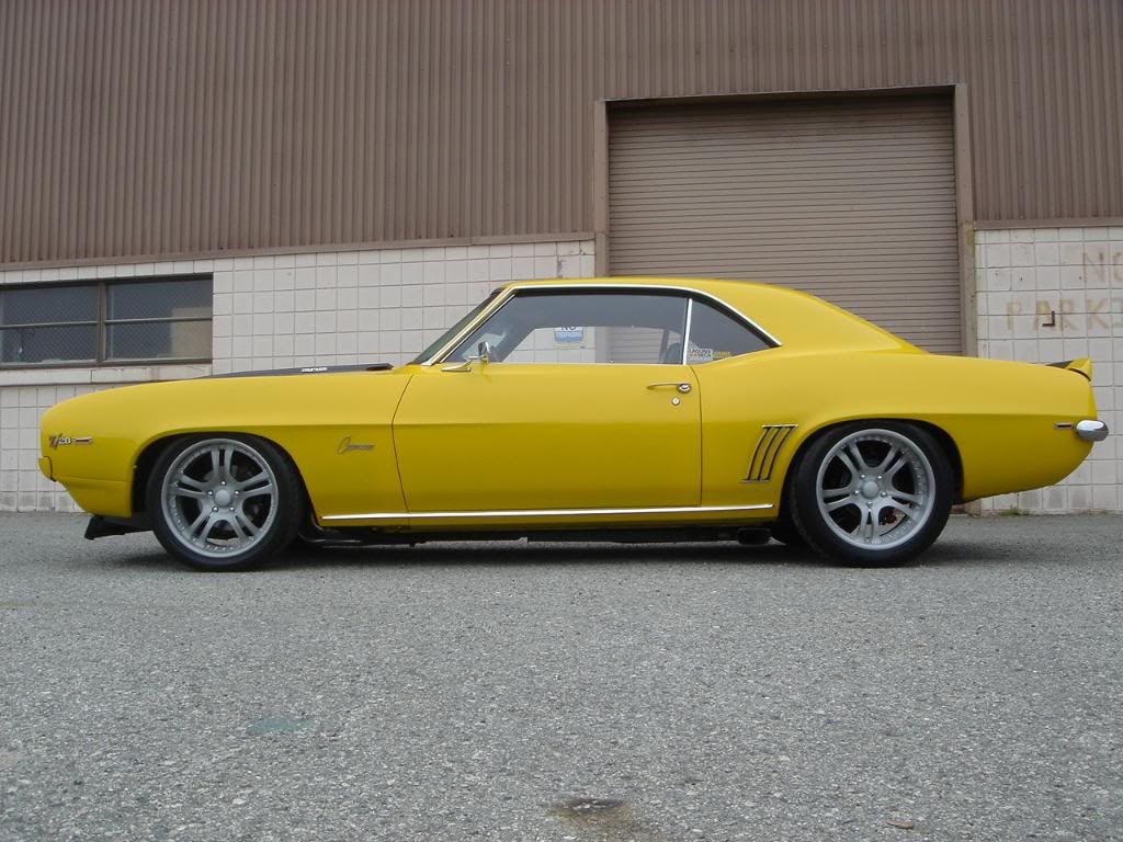

And for comparison, Musclecar John's Camaro with 18s and 40 series tires all the way around and a proper stance but they're almost the same o.d. as a set of 19s with 35 series so they'll fit very similarly.
http://i256.photobucket.com/albums/h...keCamaro-1.jpg
