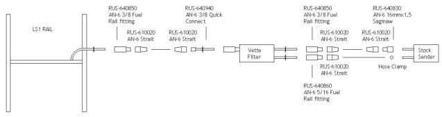

1badchevelle 12-11-2009 07:04 PM
Maybe this will help.
on the fuel pump most use the walbo gsl-392 but for a bit more a good upgrade is the bosch 044 or(#0 580 254 044)
let me know if you need more info.
http://i406.photobucket.com/albums/p...LS1FUELSYS.jpg

Mkelcy 01-06-2010 10:09 AM
Do you have a bigger version of that diagram (the part numbers are a little hard to read)?
1badchevelle 01-07-2010 09:28 AM
I Pm you email and I will send you one. I will also try to repost a larger file.
