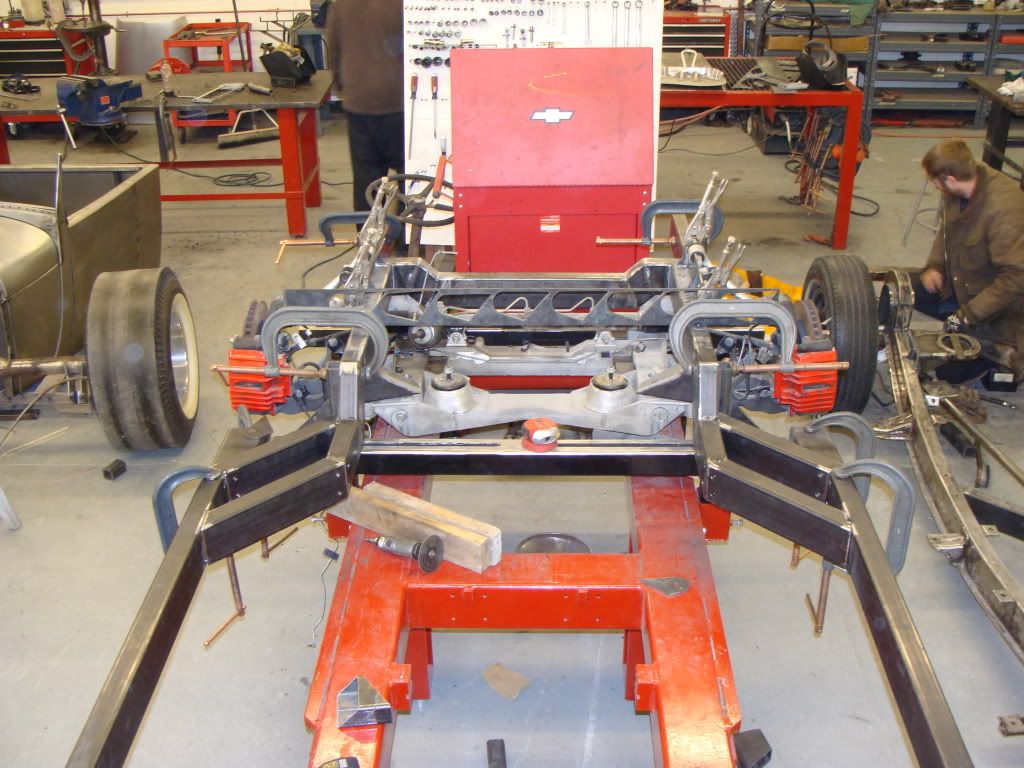

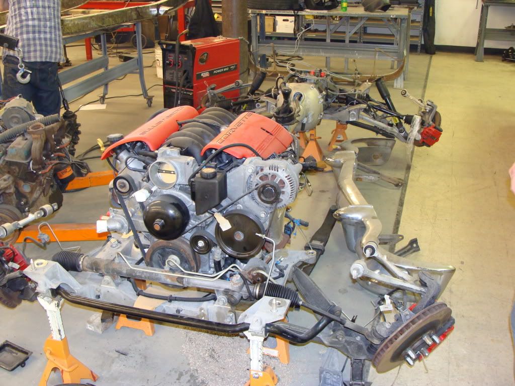

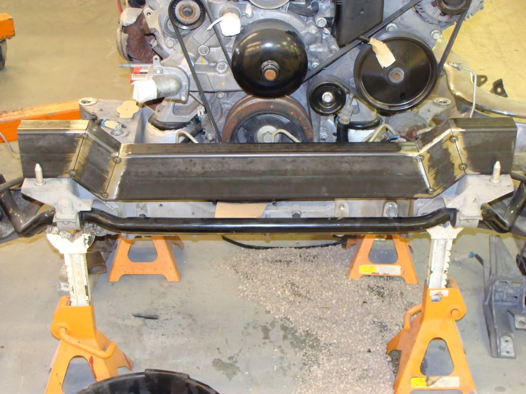

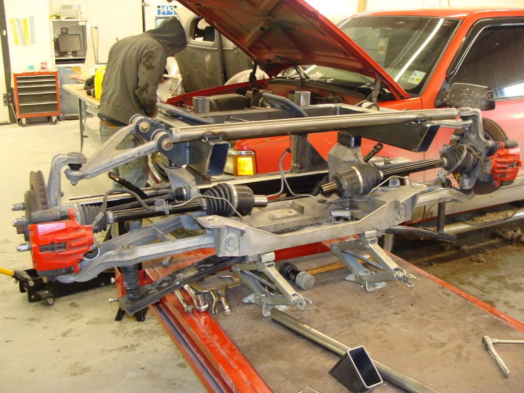

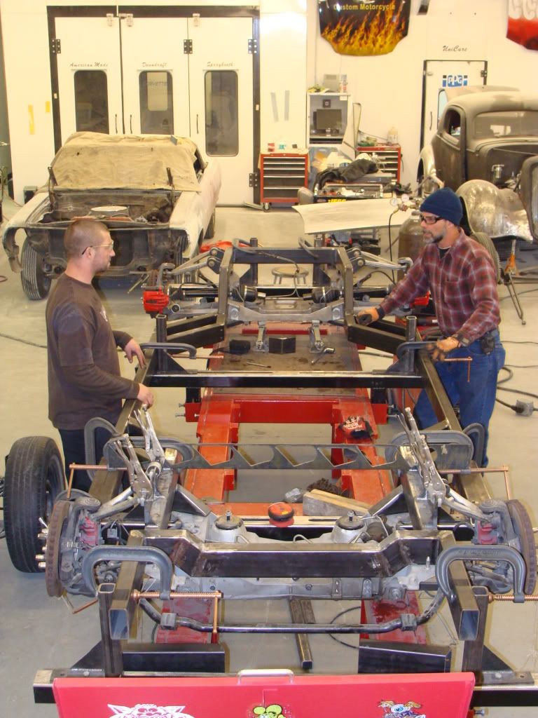

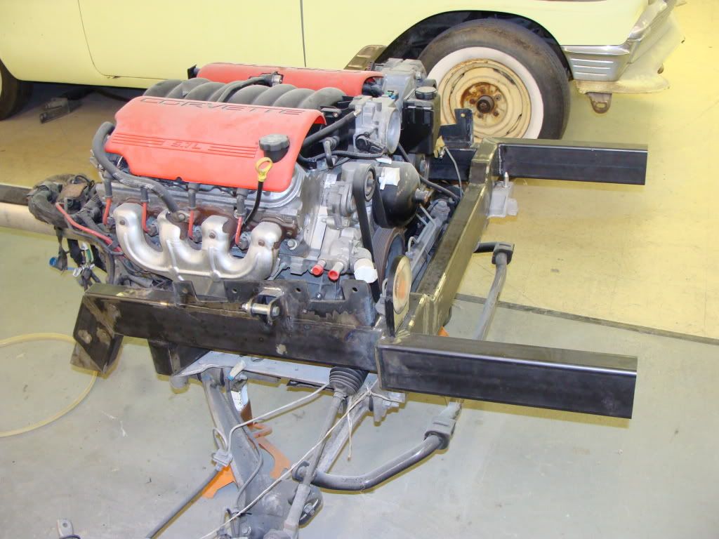

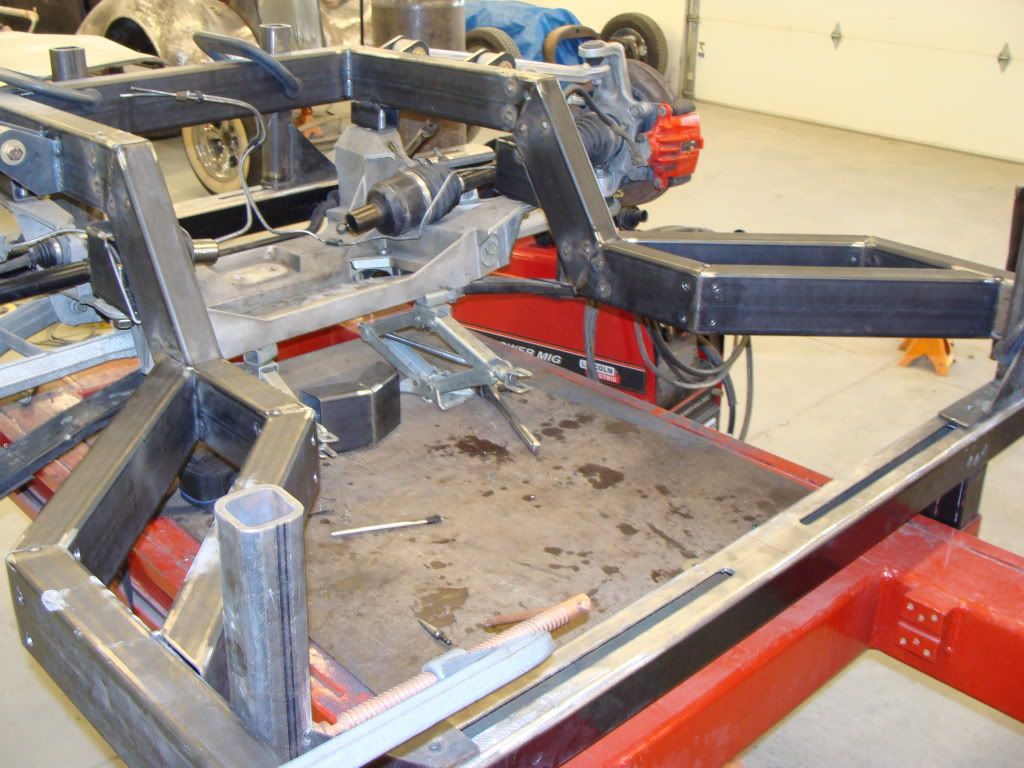

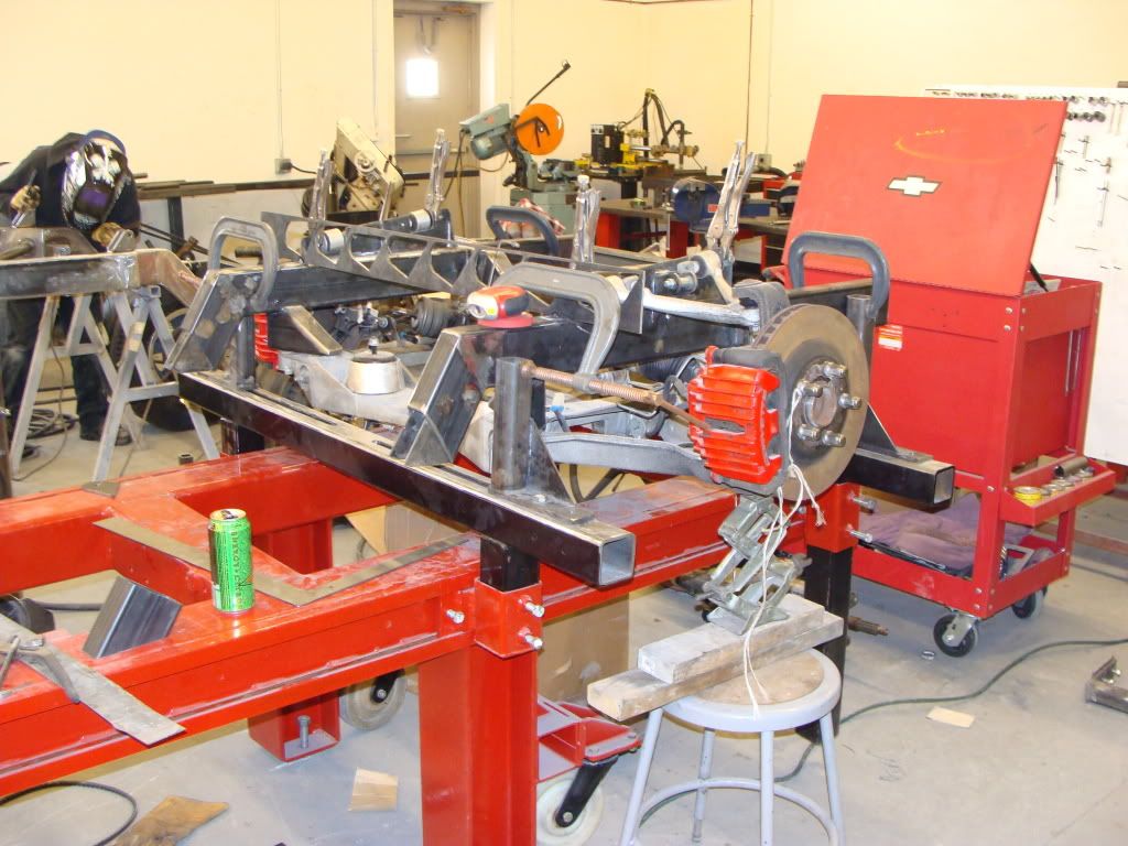

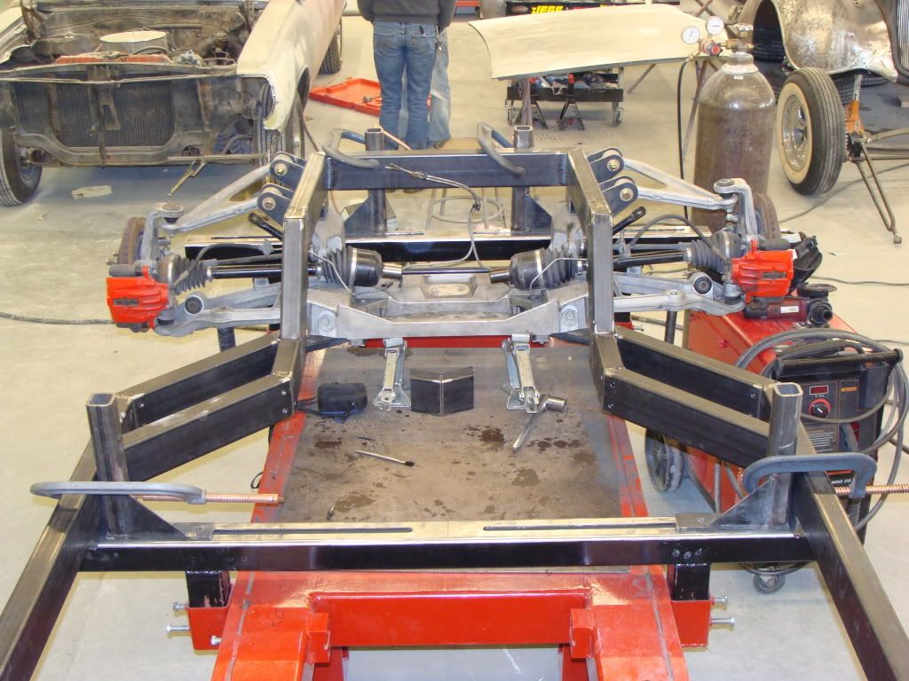

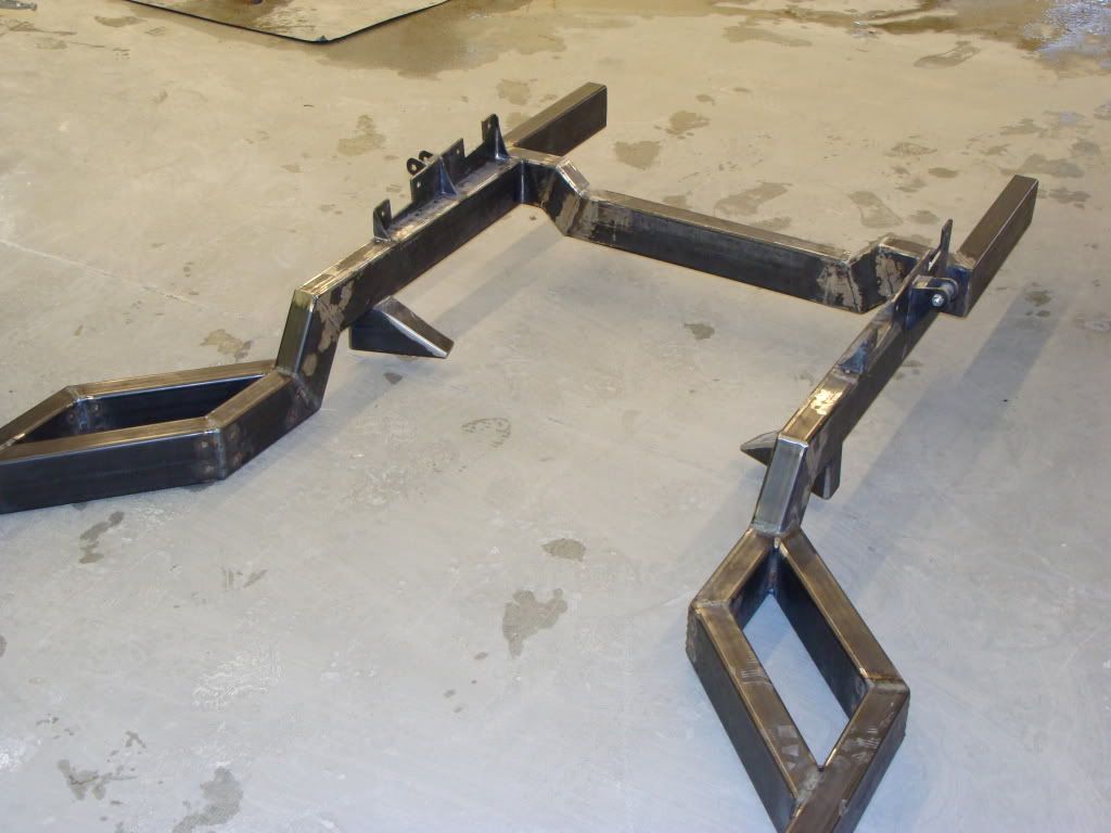

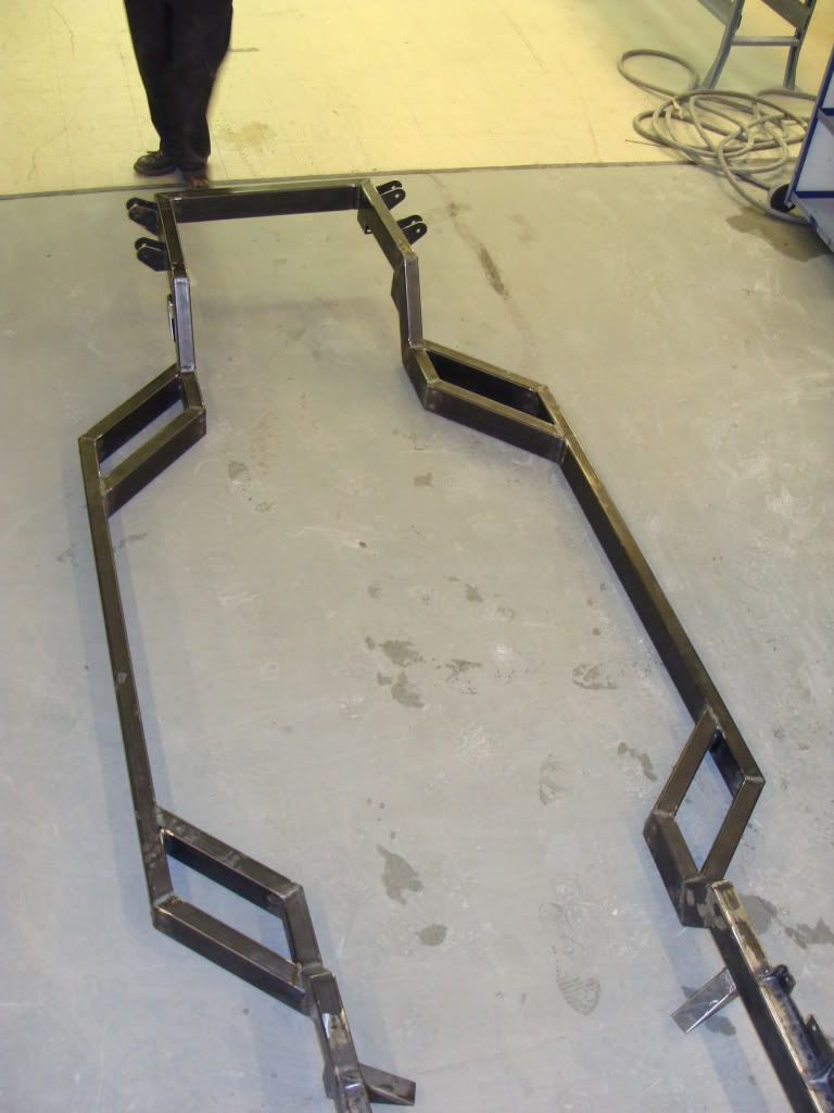

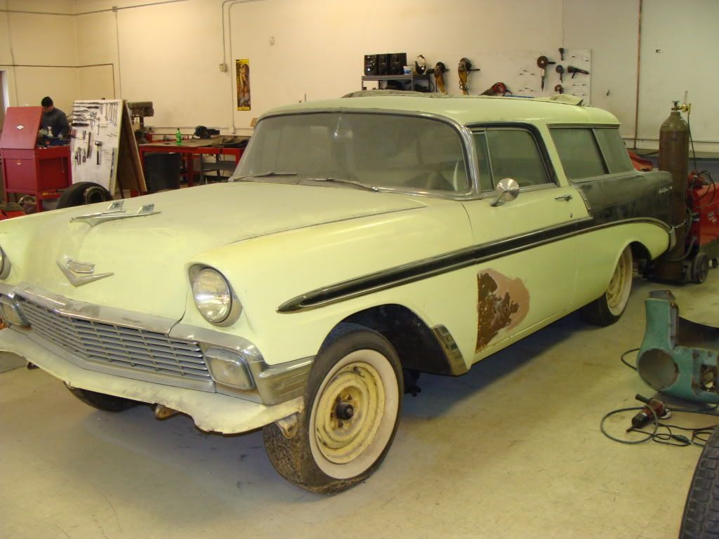

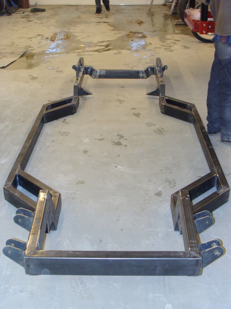

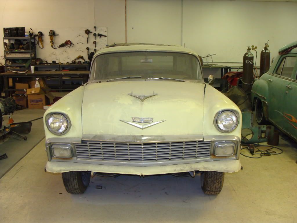

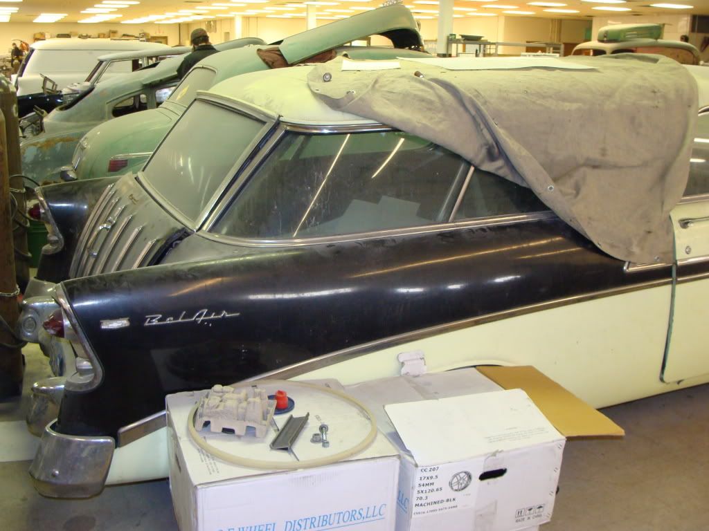

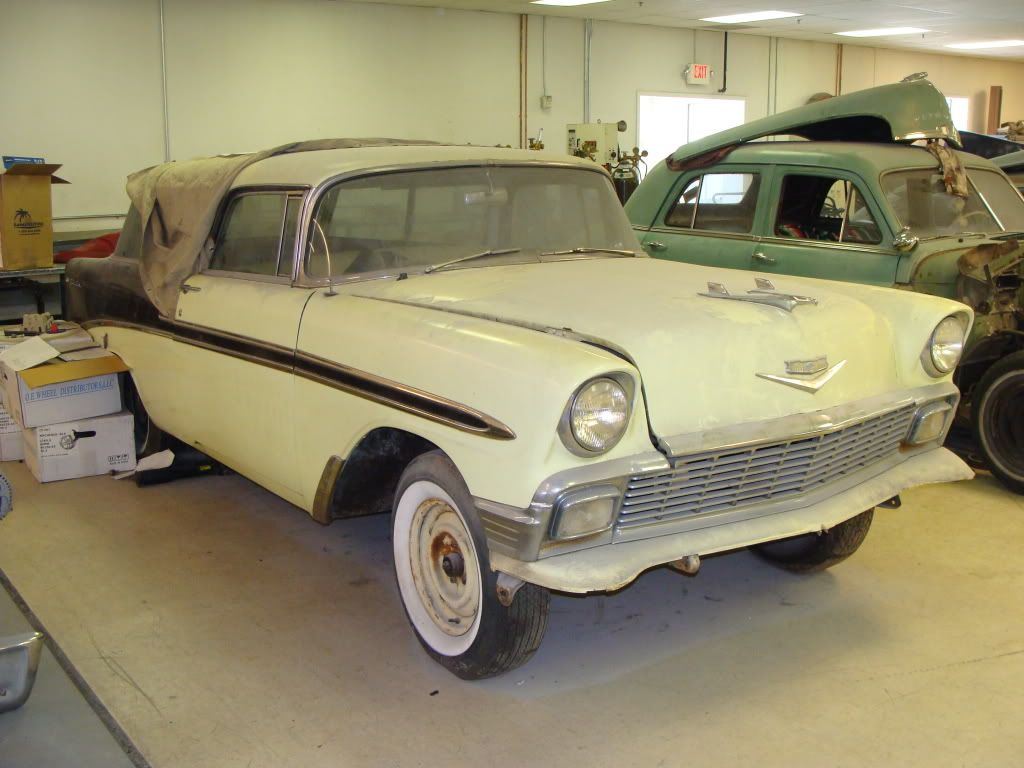

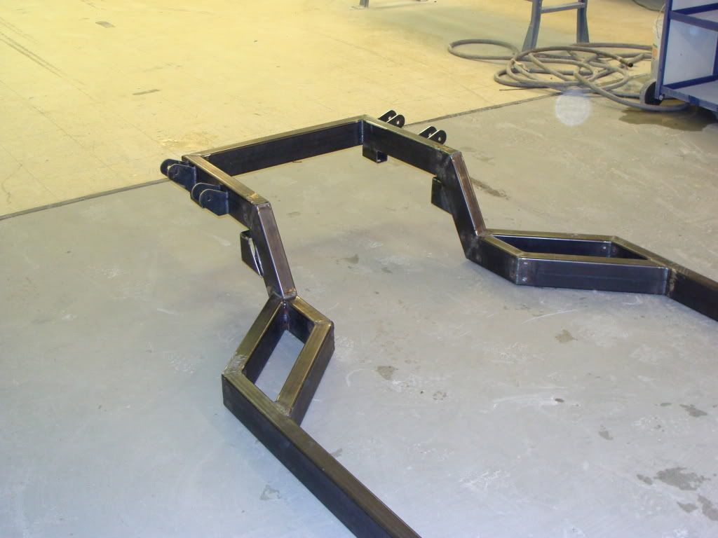

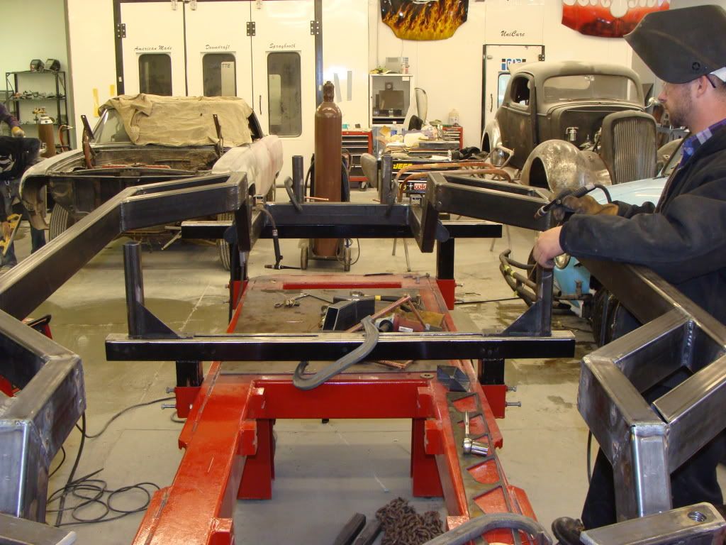

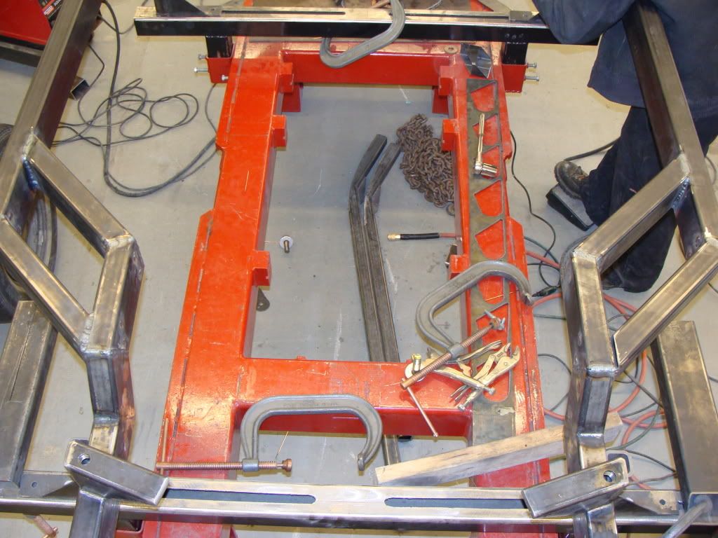

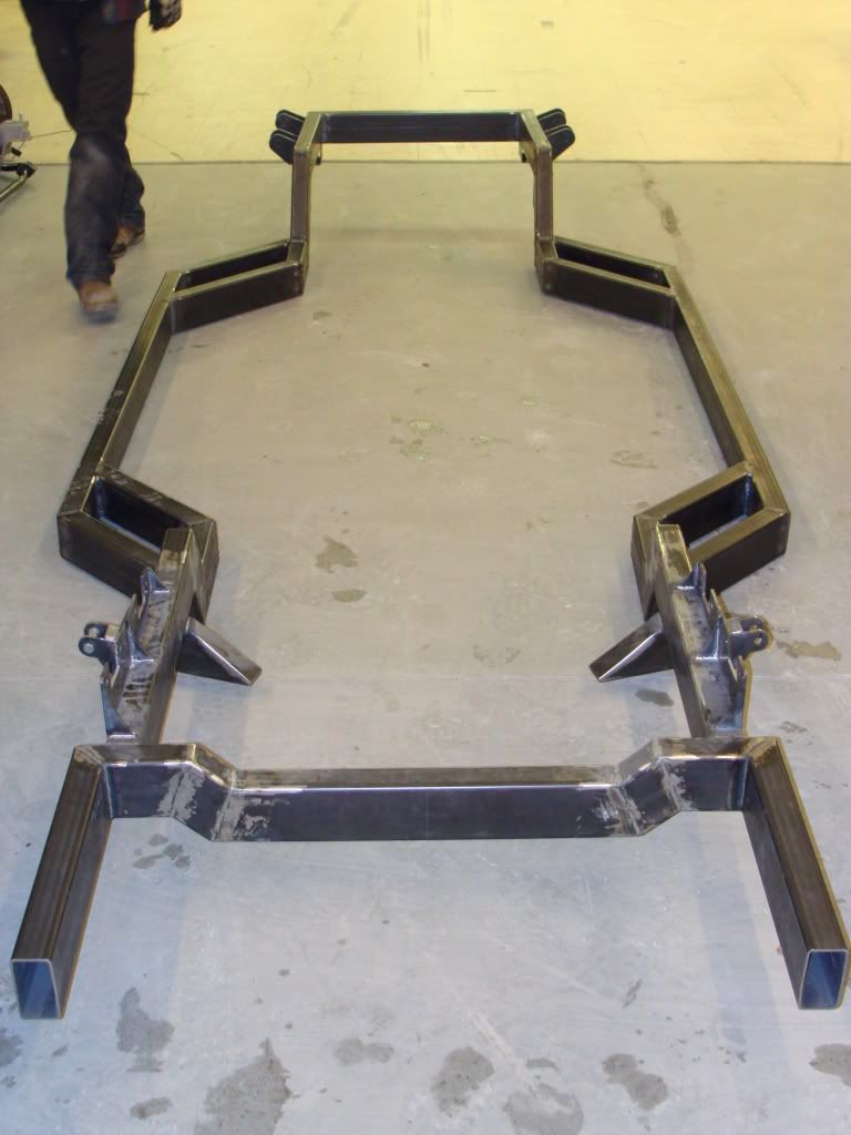

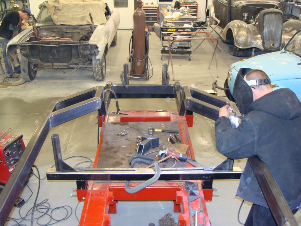

Here is a project that we are currently working on at the Hot Rod Institute. Its a 56 Chevy Nomad that is getting a transplant from a 2003 Z06 Vette. Currently myself and another student(the owner of the Nomad) have been building a full frame for it.
http://i198.photobucket.com/albums/a...I/DSC00413.jpg
http://i198.photobucket.com/albums/a...I/DSC00410.jpg
http://i198.photobucket.com/albums/a...l/DSC00492.jpg
http://i198.photobucket.com/albums/a...l/DSC00510.jpg
http://i198.photobucket.com/albums/a...l/DSC00511.jpg
http://i198.photobucket.com/albums/a...DSC00516-1.jpg
http://i198.photobucket.com/albums/a...DSC00517-1.jpg
http://i198.photobucket.com/albums/a...DSC00515-1.jpg
http://i198.photobucket.com/albums/a...DSC00519-1.jpg
70rs 12-13-2009 04:45 PM

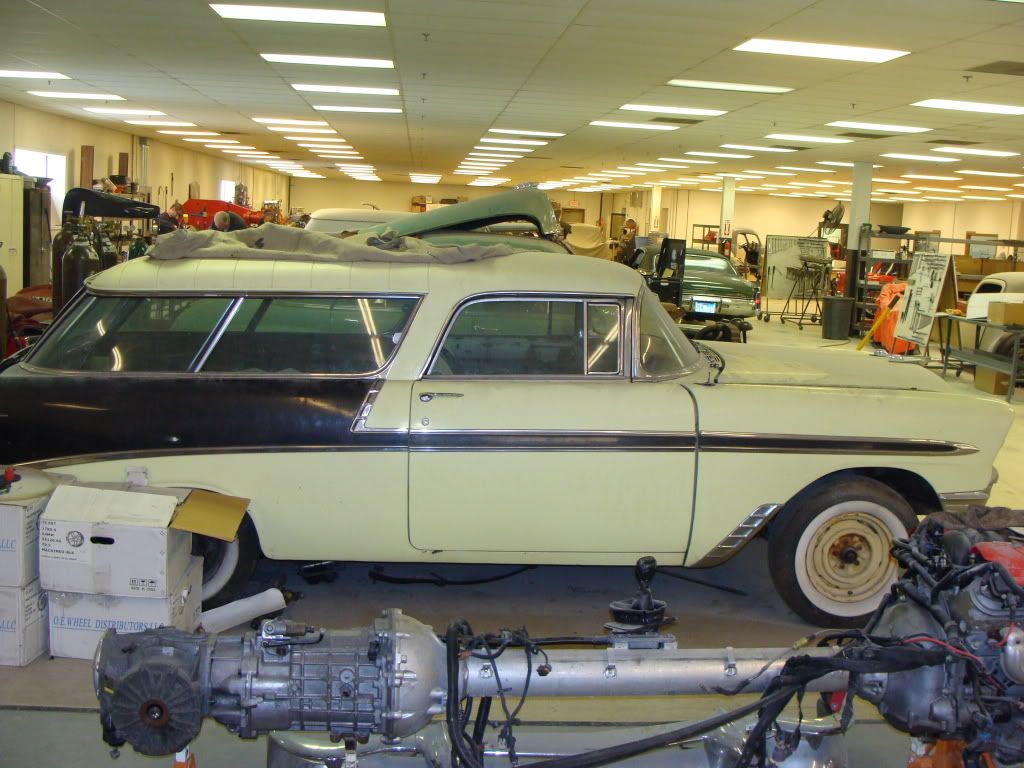

Cool project. Thanks for posting. Have any pictures of the body?
Liebetrau88 12-13-2009 04:47 PM
I'll take some more pictures tomorrow.

jimbo 12-13-2009 05:40 PM
Why such a radical frame design that is going to create the need for a custom floor?
Liebetrau88 12-13-2009 05:55 PM
Actually believe it or not the floor wont have to be modified that much, but it will need a new tunnel and a small kick up in the rear to accomodate the new rear end setup.
jimbo 12-13-2009 06:06 PM
Just curious about the portion between the front and rear wheels. A stock tri five frame does not kick like yours. The floor cross braces and body mounts will have to be reworked.
http://hubgarage.s3.amazonaws.com/ph...EW1_detail.jpg
Liebetrau88 12-13-2009 06:10 PM
The frame is actually 58 inches wide on the outside, and the middle body mount will actually sit right on top of the new frame and then off of that we will make a shorter body mount for the front and the rear. The actual mounting points of the body is about 3 inches higher than the bottom of the rockers as is the entire floor pan underneath the car.
